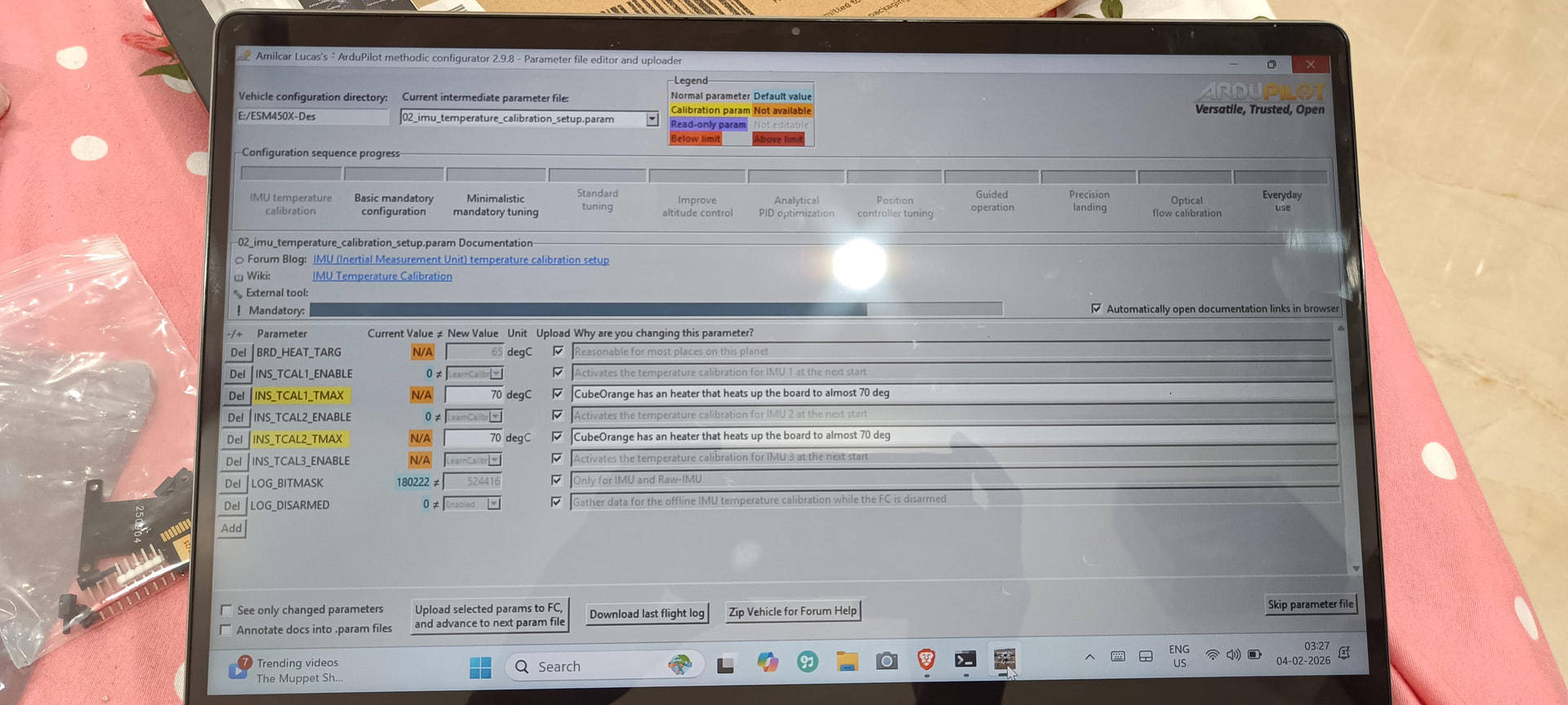

As for uploading parameters, I deleted all the parameters with “N/A” written.
I did so in this:
And uploaded all non-N/A parameters.

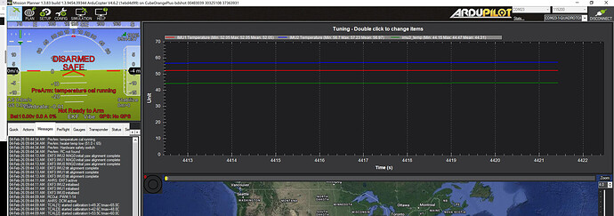

I find it helpful to monitor IMU Temp(s) while it’s running. Then you have some idea when it will complete. Mission Planner Data Screen, check the Tune box and select the IMU temp fields. The Messages Screen also tells you what’s going on and when it completes.

OK. I’ll run one of the bench FC’s to collect some sample screen shots.

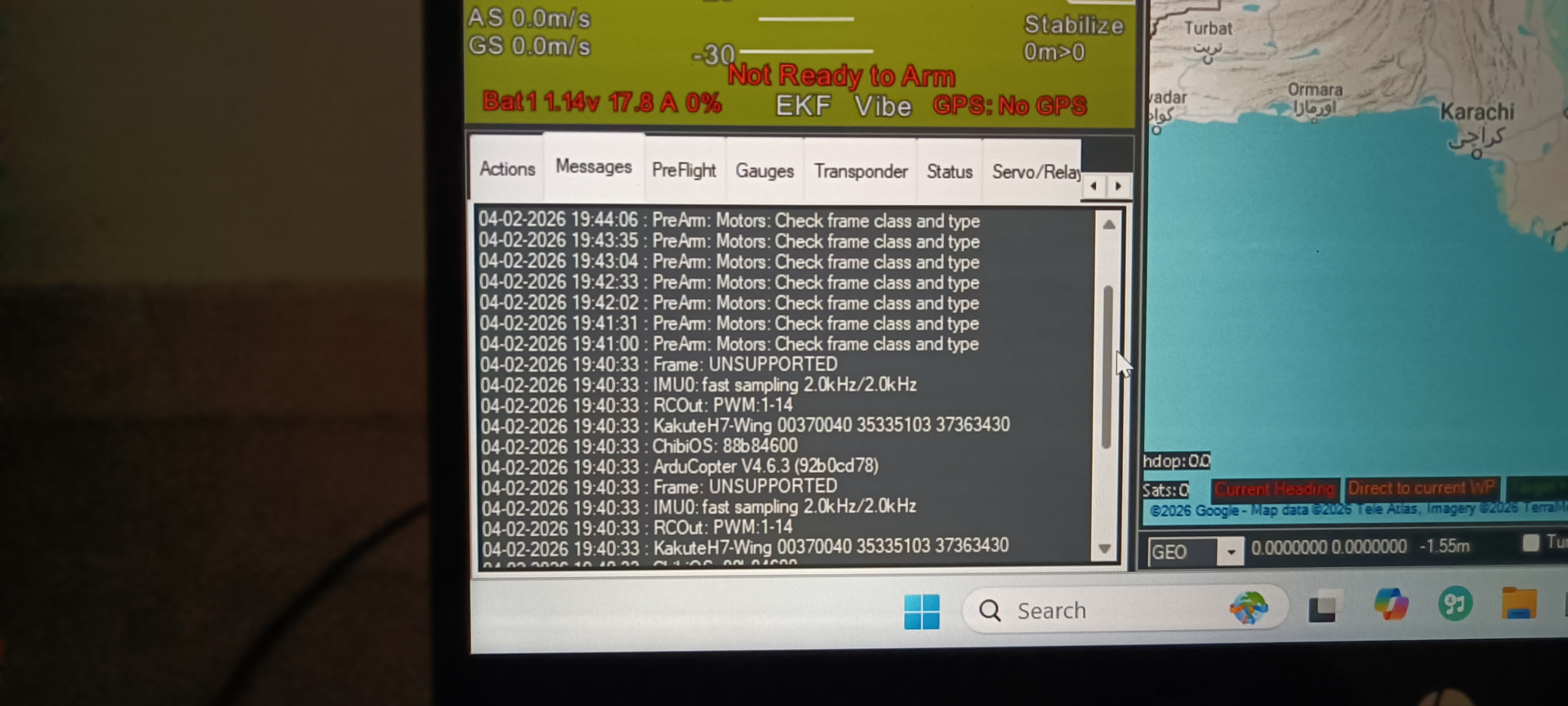

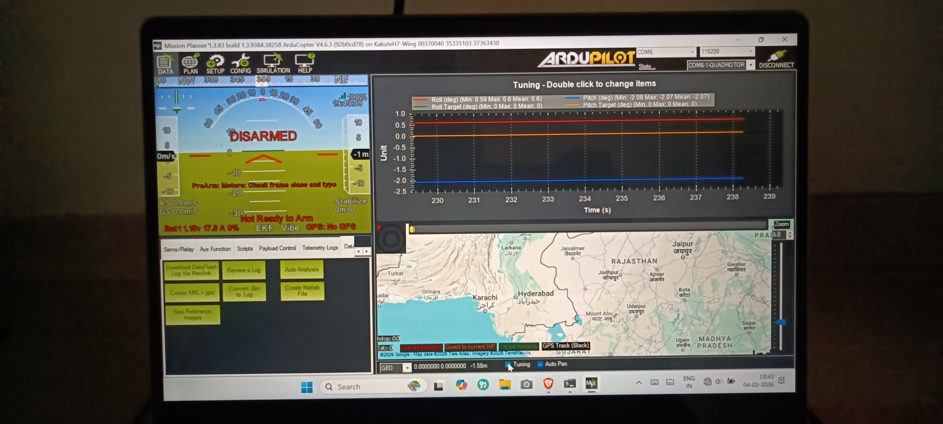

As for the messages screen, I am seeing no new data coming related to this ongoing temperature calibration, but when I checked the tuning box, this opened up, and I don’t see any “What is the current temperature?” Fields here?
The messages screen just says this:

Obviously because Temp Cal is not running.

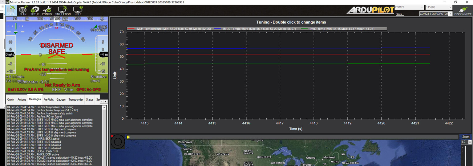

I doubt that. If so you would see this:
So, go back and start over and figure out what you did wrong.

I just happen to have a cube in the freezer right now. Let me know if you want any screen shots.
Alright! I just configured this Cube up quickly to grab that screen shot but one from a real run would be better. One running and when it completes to show the messages would be great.
The things I did differently were all told my Amilcar Sir only. I deleted all the “N/A” parameters and then uploaded the Temp cal file.
Did i did wrong by doing this @dkemxr sir?

If you’re using AMC you shouldn’t need to delete anything. Just run step 2 and it will get it all set up for you.
