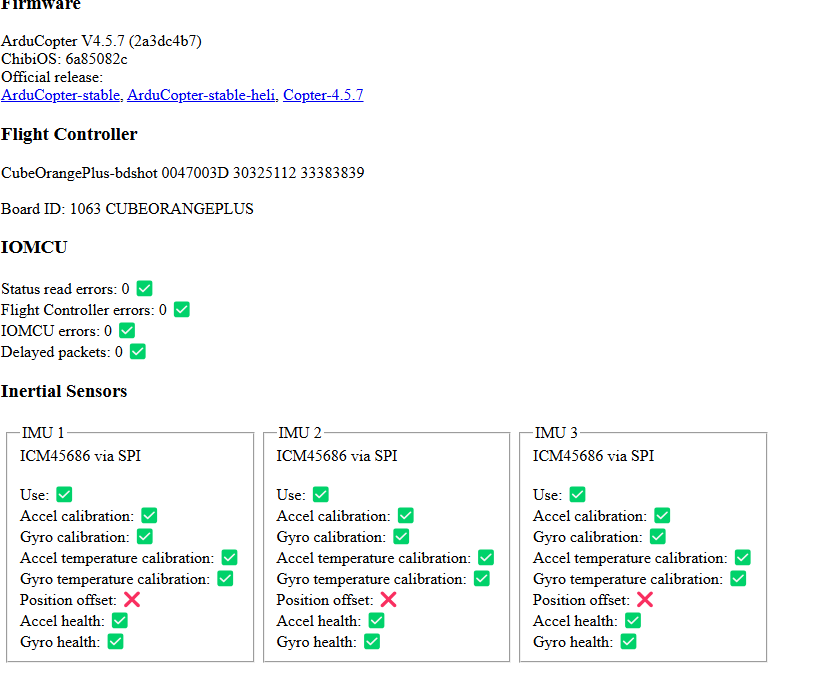

IMU 2 on my CubeOrangePlus errors?
My orange plus is showing this, is there something I can do? it doesnt show any preflight errors…

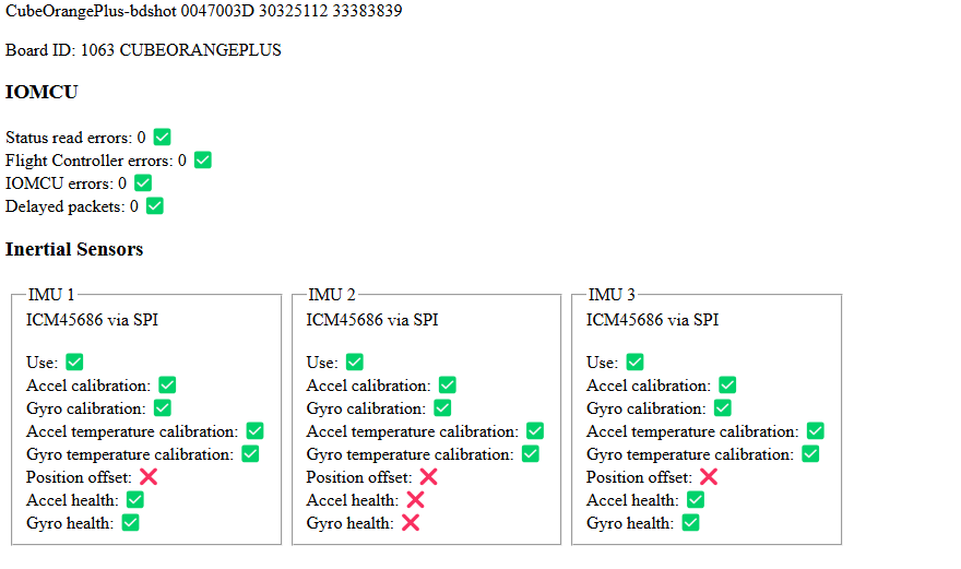

Sometimes the red x’s are there and sometimes the green checks are there.
I just upgraded this to the 4.6 beta from the 4.5.7 official version. not sure if it is related or not.
So I went back and relooked and as soon as I upgraded to the new beta firmware I started getting the red checks.

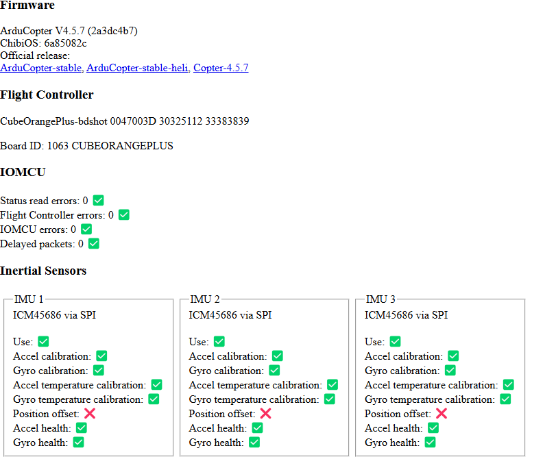

I just downgraded to 4.5.7 from the latest beta and …

Was there a beta at which this started happening? There is a change that @bugobliterator made that I can easily believe is responsible, but no idea why.
Sorry for the late reply. I don’t remember seeing it until recently. I changed the battery size on my copter and started retuning it and just happened on it.
I downgraded it because I wasent sure if it would allow them to be used in a redundant situation.

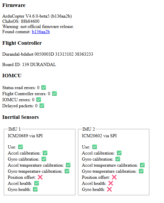

This is another
@prsh8ya we need the bin log with LOG_DISARMED=1 to analyse this issue, can you please link the log here?
