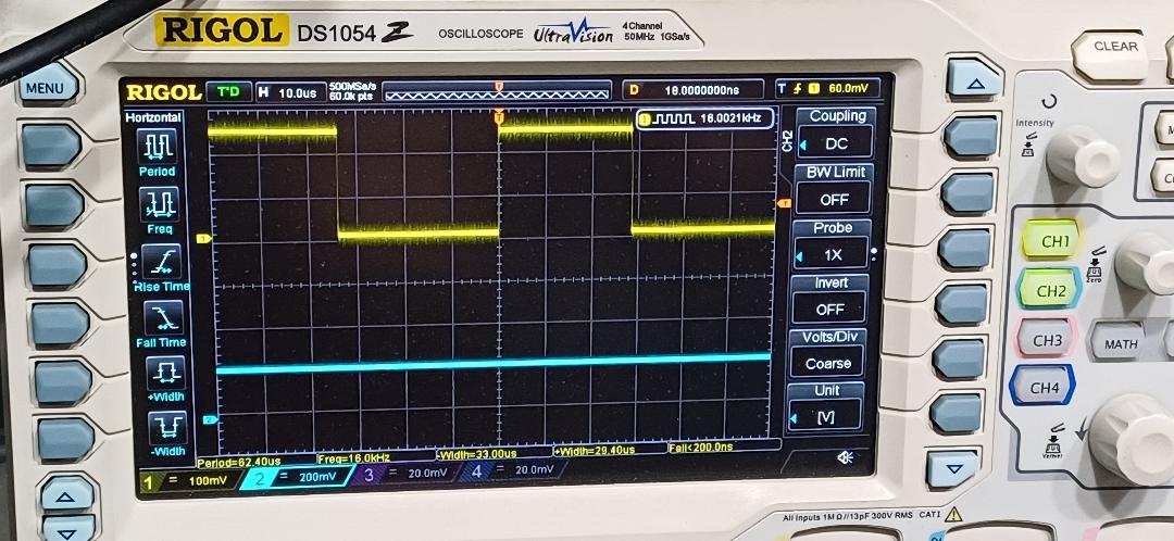

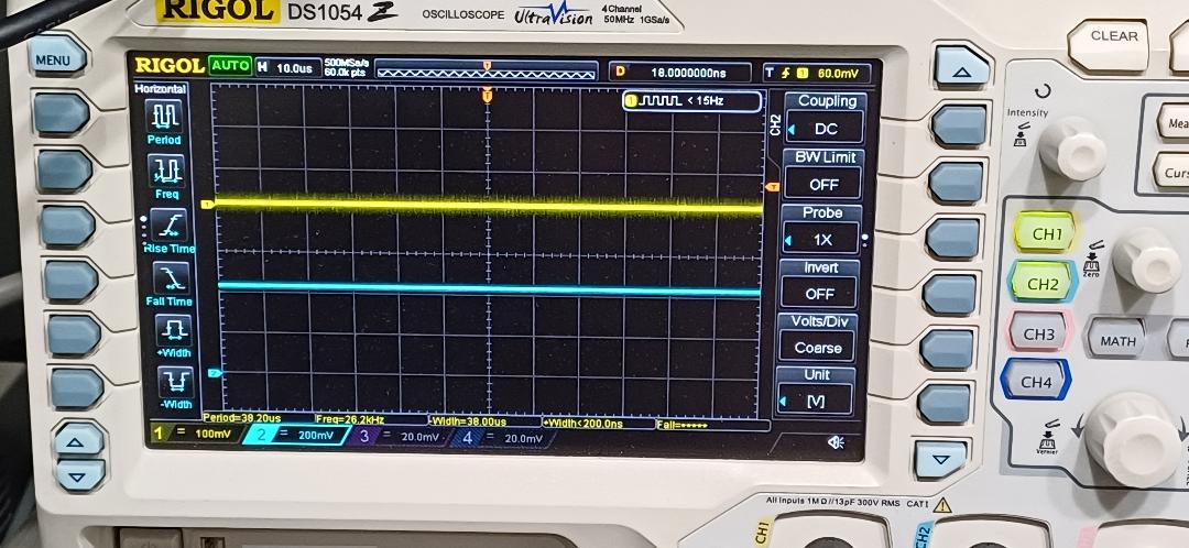

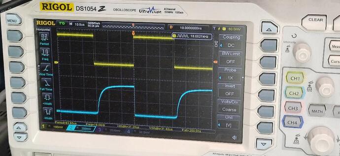

Some interesting results:
The DAC is inverting
Stick Centered
Yellow trace - SERVO1 output (PWM 0% duty cyc)
Blue trace - DAC output (5V)
Stick offset 50%
Yellow trace - SERVO1 output (PWM ~50% duty cyc)
Blue trace - DAC output (~2.5V)
This is where it gets interesting
Yellow trace - SERVO1 output (PWM ~50%)
Blue trace - Opto-Isolater PIN6 - Note the signal gets inverted, followed by non-inverted amplification by the op-amp, followed by low-pass filtering.
I’m using this circuit
If you look at the internal circuit of the opto coupler the signals are as expected.
If pin 2 is low → led is off → pin 6 is pulled up by R2
If pin 2 is high → led is on → internal transistor is switched → pin 6 is tied down
Yes sir, totally agree
AP doesn’t offer an inverted signal option for this output type. You could just put an inverter in front of your existing hardware.
or just connect the led side of the opto from ground to pwm instead of pwm to +5
That’s why I used the second opto as an inverting amp and have a complimentary output.
you don’t need an inverter. You can have normal or inverted output by simply altering how the opto led is connected. But do it whichever way you prefer.
The pulse is positive going so reversing the opto LED it will be reversed biased and not illuminate
pin 2 of optocoupler led to (+)
pin 3 of optocoupler led to PWM
will do the job

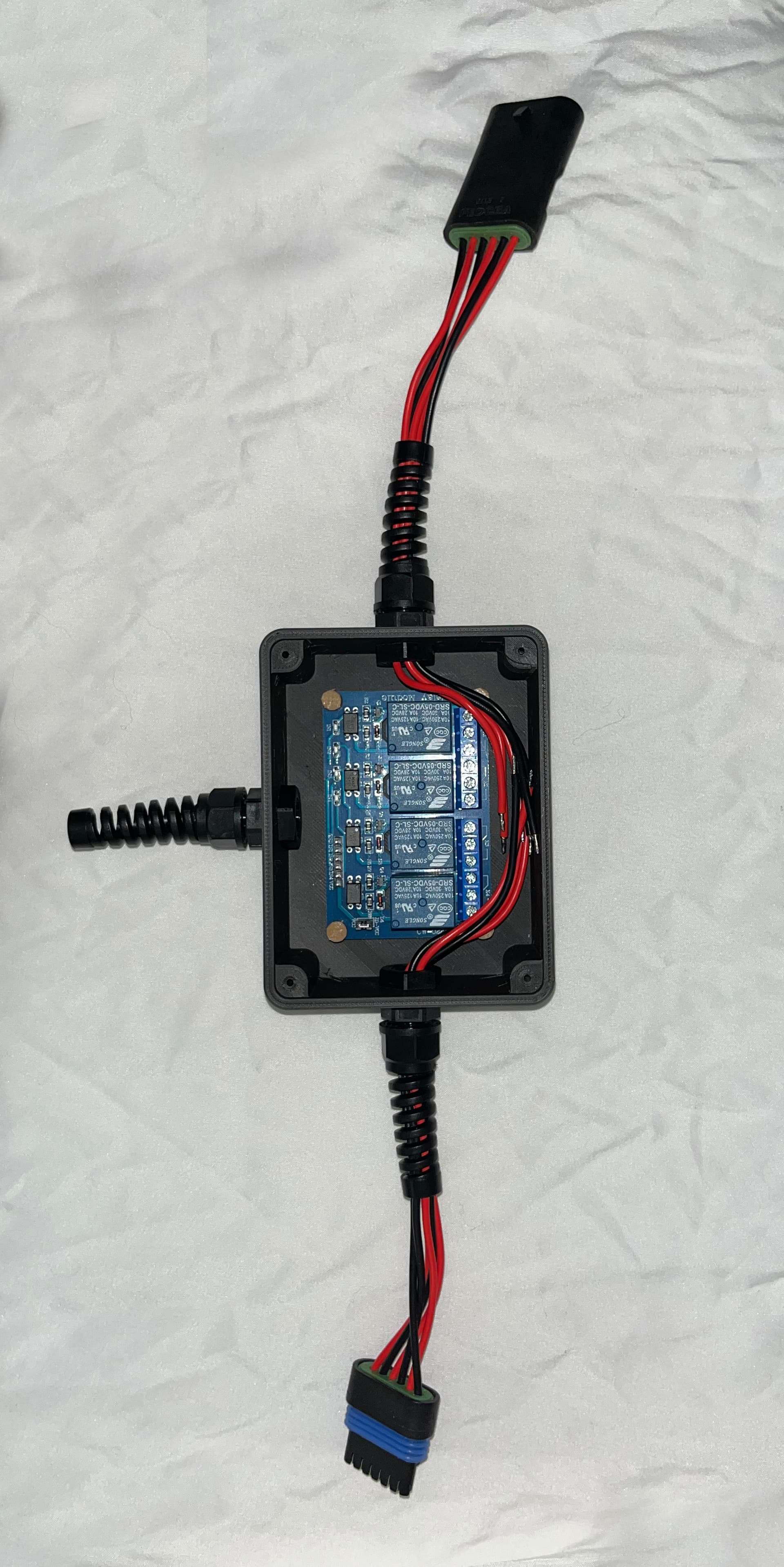

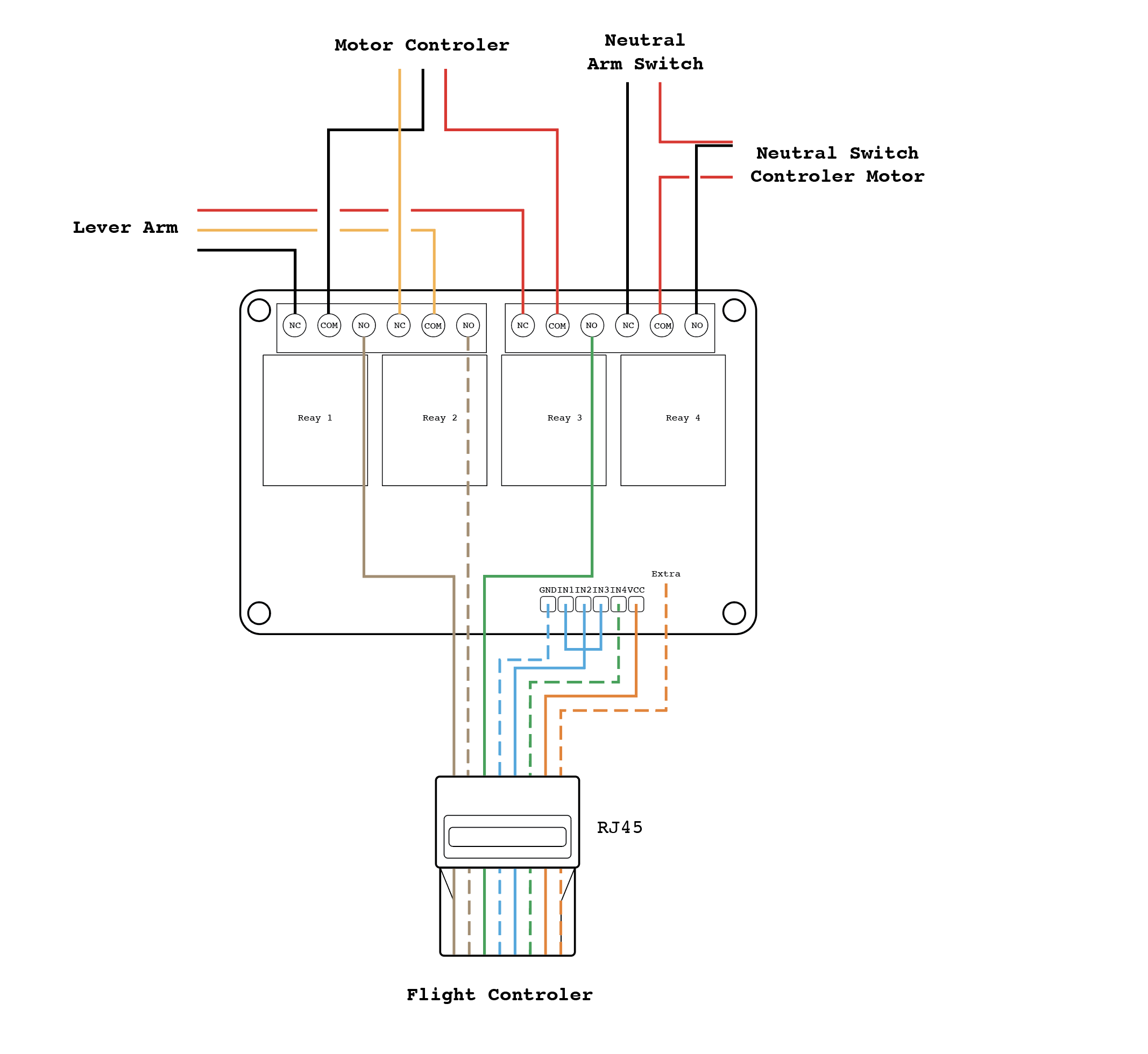

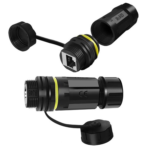

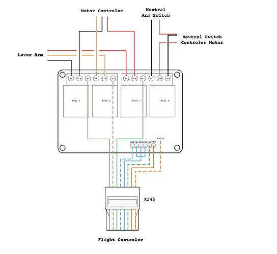

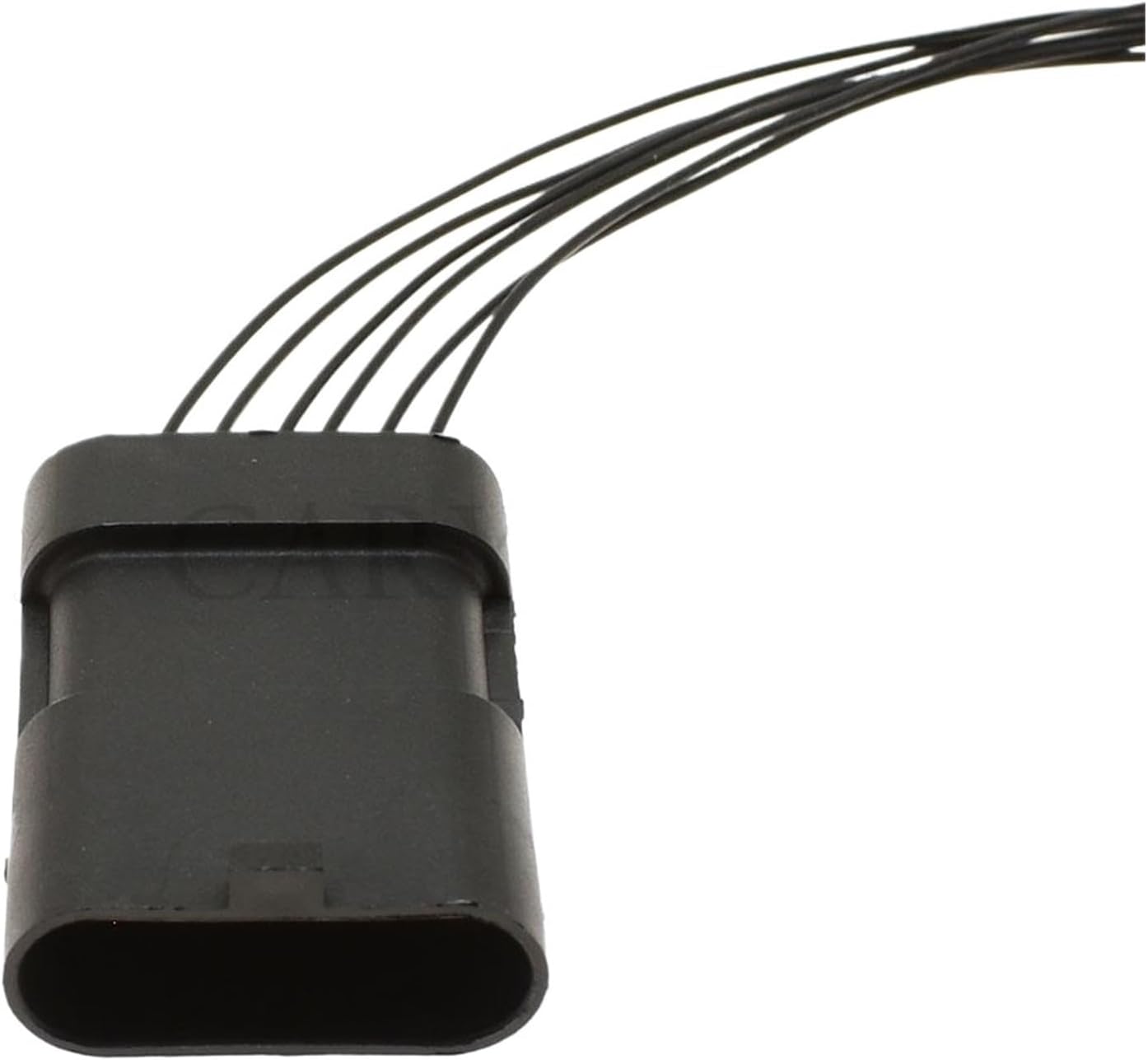

I have been able to play with how I might hook up the driver/circuit to the mower. My main plan is to do as little wire cutting as possible and remove the Flight Controller (FC) when not needed. One plan is to have a remote relay in a box near the control arms and connected between the male/female plug going to it. By default, it will be set to the control arms (manual). It will connect to the FC by Ethernet cables that will unplug. When plugged in, I can switch it to remote.
I plan on having ethernet ports (left side and right side) on the mower and FC box. So I will just plug it in like connecting to a network.

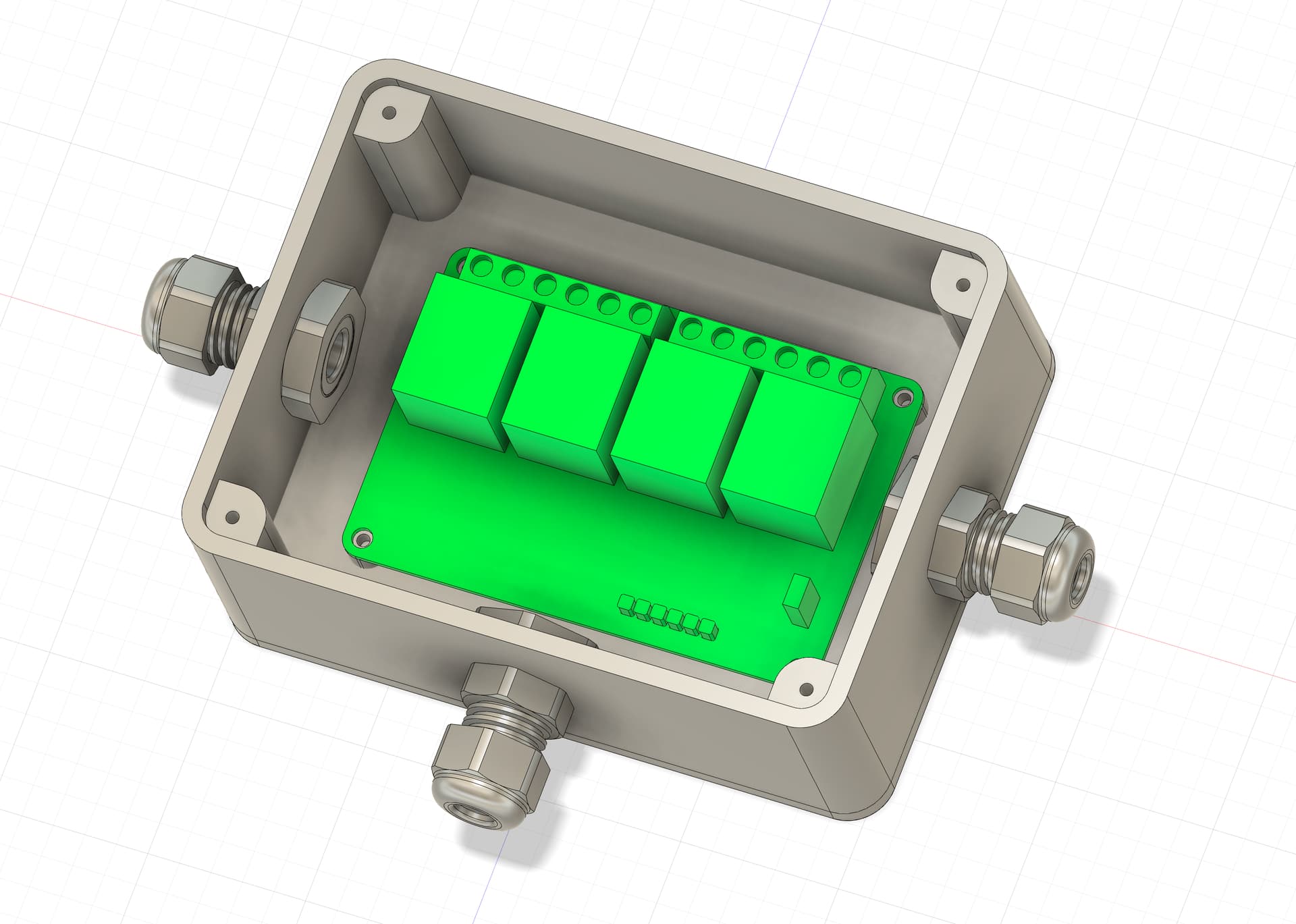

The design right now has the diver/circuit with the FC. Thinking about doing a version with it in the box with the relay. It my be more universal that way.

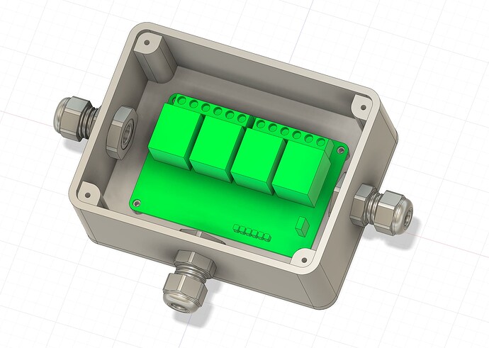

First prototype of the relay box. Thinking it is going to be 2 version.
  1. Four (4) relay for the left with drive control and neutral
  2. Six (6) relay for the right with drive control, neutral, mower, and lights.
Plan on making the driver a stackable board to mount on top of the relays
The empty port is for the ethernet cable to connect to the flight controller.
Yes, I am probably overthinking it…
You’re definitely adding many more components than I did. If you scroll up to jun 16 you’ll see where I just put everything in one box.
But you do whatever you’re most comfortable with.
The main thing is that you’re having fun enjoying your hobby. It will work fine I am sure.
