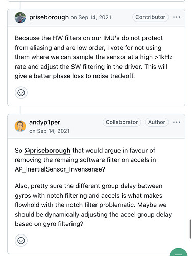

ICM42688 HW LPF in AP implementation
Betaflight used HW LPF for ICM42688 to reduce aliasing. And I’ve searched in AP side and found that AP didn’t use it. But the discussion is from an issue from 2021.
ICM42688 is known to be sensitive to noise, I’d like to ask if implementing the HW LPF can help?
