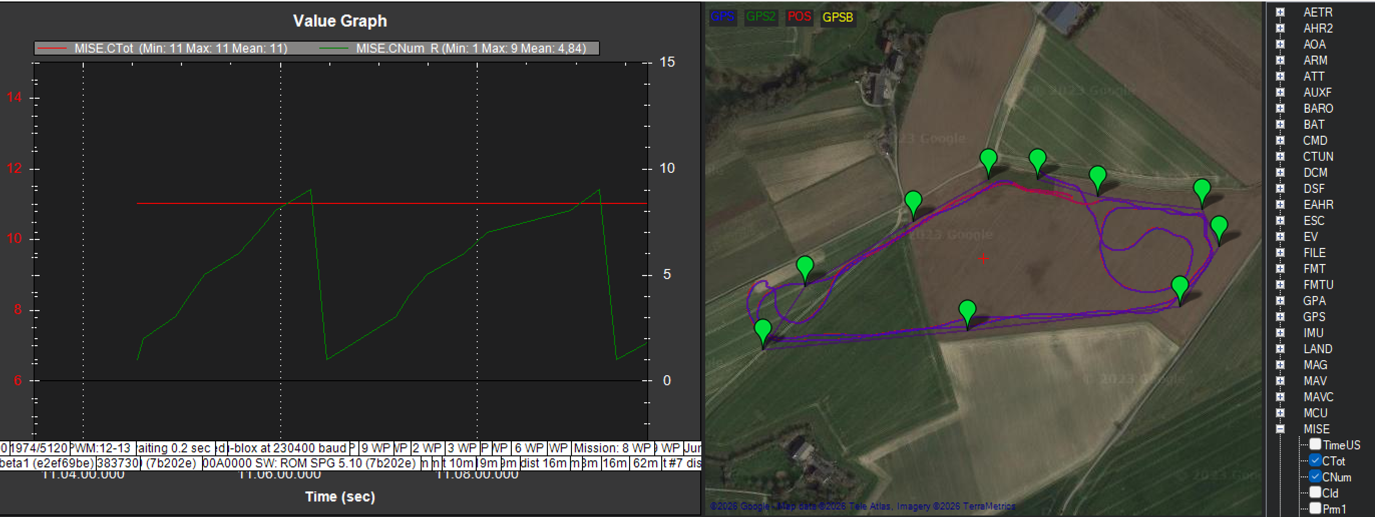

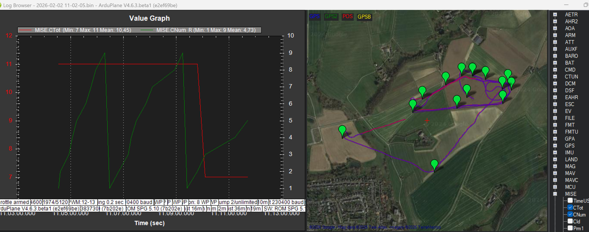

You can track the individual missions by selecting the appropriate area in the Mission Planner log file graph. Without zooming in, you can see all the waypoints on the map. In this example, there are waypoints for two missions.
If you zoom in on the area of a single mission, only its waypoints will be displayed. First Mission:

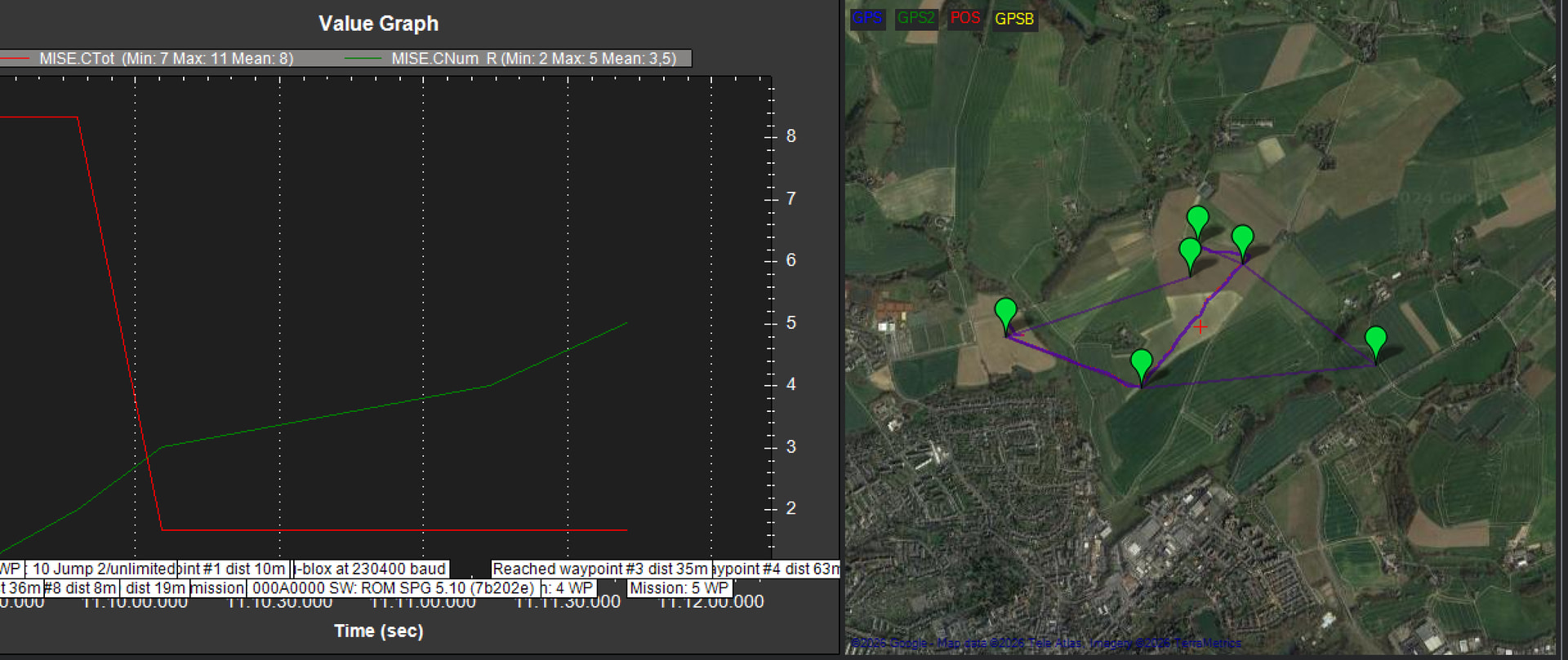

Second mission, uploaded during flight:
The data should therefore be stored. Mavexplorer extracts the first mission using the command “mission” (However, I only have the Windows version of Mavexplorer available at the moment, and not the latest one).
