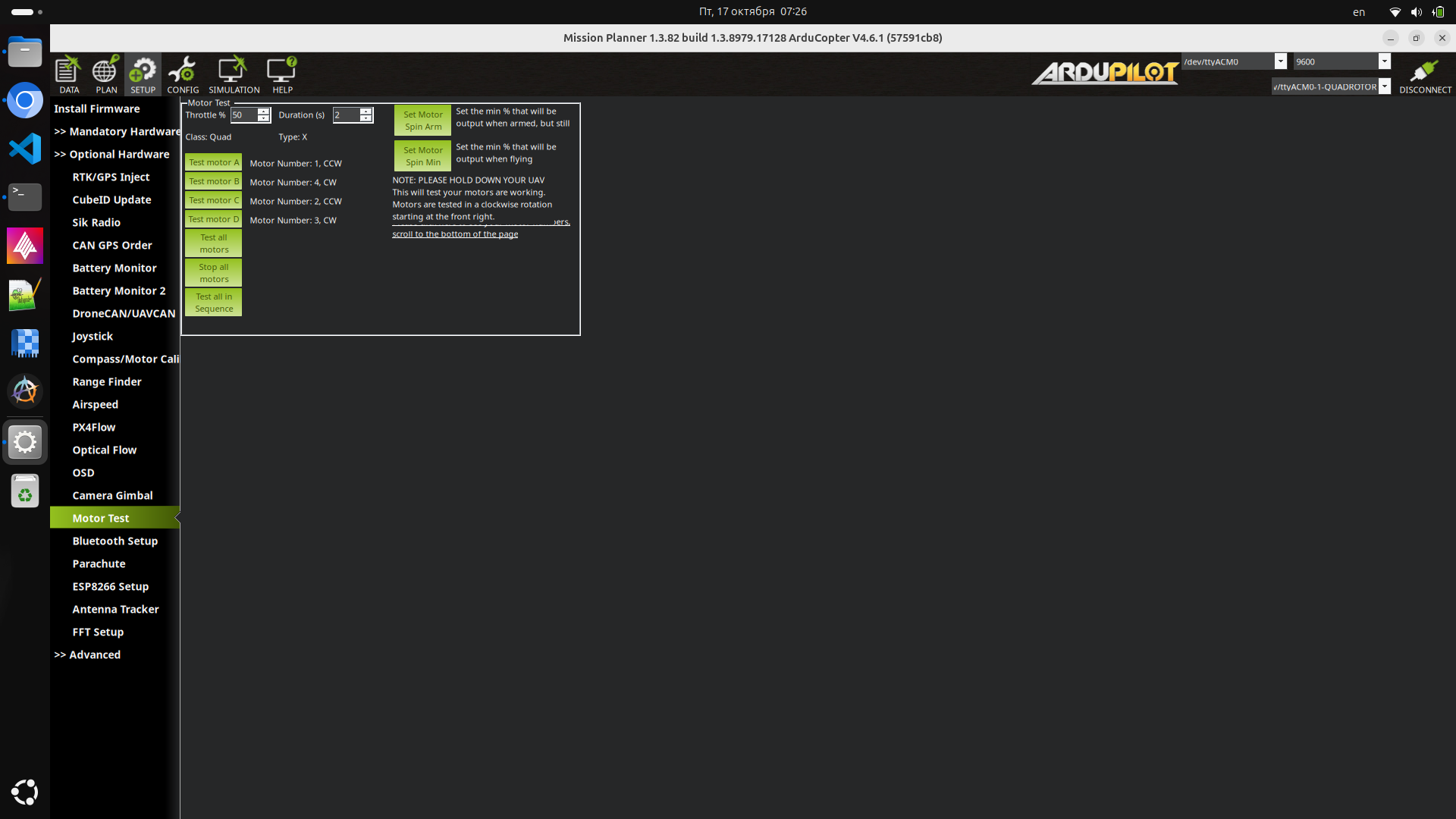

Most of you posted is irrelevant. Use Mission Planners Motor Test feature to test motors for proper order and direction. Only using this tool can you determine if they are spinning the same at the same throttle input.
Thanks, Dave! I will check it, but the RPM decrease in one motor is noticeable even to the naked eye. The main cause behind starting investigate this is drone failed to rise up vertically on the 3rd launch, it is skewed to the one of the axis. It happens because of the less thurst on this axis.

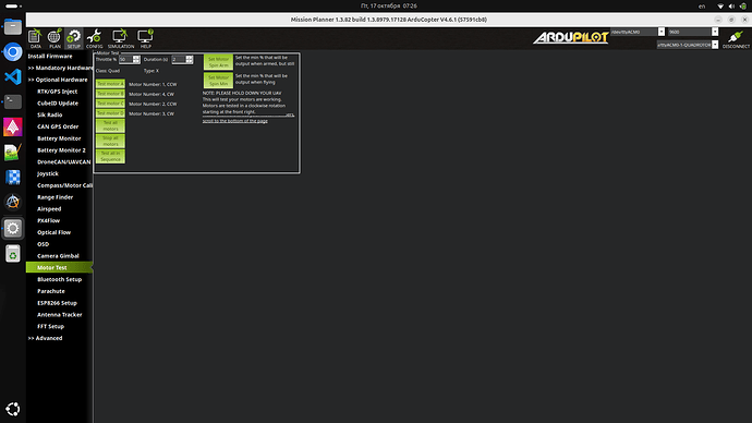

Just finished motors tests. They are all working, but it is not give me necessary information I was looking for.
I attached the screen shoort: I am running it on Linux, so may be a part of UI Dave was refered to is hidden.
Dave, could you please elaborate what do imply by asking ti use test motors feature first? I want to emphasize that FC gives less thurst on the one of the motors which it doesn’t allow to get it up vertically – it wasn’t an issue on the first two test launches.

Testing with the transmitter will produce the result you are witnessing. It’s not an “issue”, it’s expected behavior. When you used Motor Test did you confirm the Motor Order and Direction were correct for the Frame Type you have chosen?
Yes, motors order and direction were correct. It wasn’t an issue at all – it was setup right before the 1st trial flight and on the all three trial flights it behaved right.
May I ask you to elaborate the topic with transmitter? I don’t think I witnessed this behavior on the first two flights.
If the motors are turning at the same speed with the same throttle % using Motor Test then it’s likely a configuration problem if the craft wants to flip on take-off. Usually this is due to the wrong motor order or direction. And this is usually because of a misunderstanding on what motors should run when the A-D buttons are pressed in Motor Test.

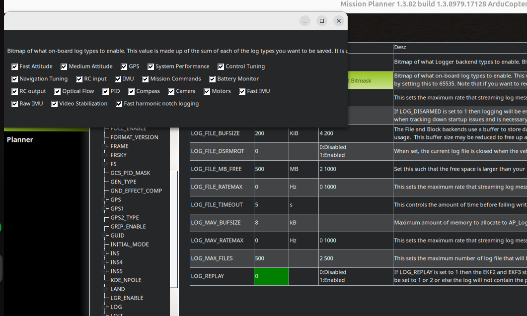

Disable LOG_REPLAY no reason to enable that.
Disable LOD_DISARMED No wonder you have 500 logs. If it arms you don’t need this.
Set the LOG_BITMASK back to default.

Done. I disabled this two options. Anything yet should be disabled?
I noticed 500 files as threshold, so actual logs after rotation could be in any other files. I am erasing it now to improve navigation.

Set the LOG_BITMASK back to default (180222), not checking every box.

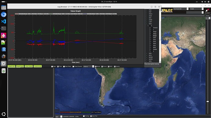

And while I don’t suppose you understand what this graph shows it’s evidence of the problem using the Flight Controllers internal compass:

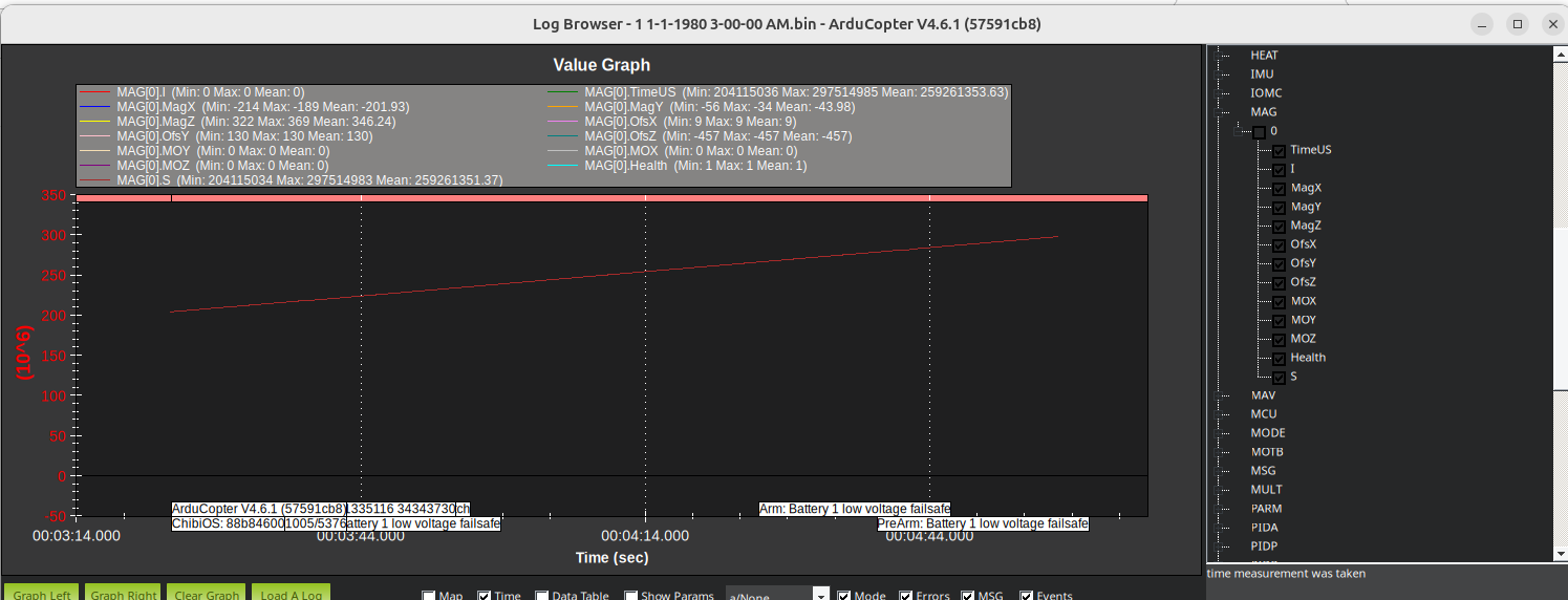

Excuse me for delay in response, only today I have been able to return to this project. May I ask how do you get this plot? I can’t visualize the data:
I used MAG params here, but many others are also looks this way.
Here is updated archive with just two bin files. I wasn’t sure at first shall we have look at others files as well.
UPDATE:
Got the data. They appears only when subset of params are set. Still I see use use sqrt formula from this params. It would be interesting to know how did you able to input such formula in the log viewer?
I have been learning how to read this plot for a half an hour. Let me just double confirm with you my understanding to make sure we are on the same page.
The sqrt from sum of quads you used gives us length of the vector of magnetic field. In normal condition for my place it should be near 50 nano tesla, although I am near Kursk’s Magnetic anomaly which gives its impact on the magnetic field. However, without turned on motors gauge shows correct orientation. The lack of dimensions on the plot gives comparison to this 50 nano tesla meaningless. Although, this plots still could give some valuable info.
ChatGpt suggest if the plot of the vector acts as a sinus plot, it is clear signal of the inference. In the similar way when one projection on the axis varies from another by twice as large, it is also signal of the inference. In my plot MAG_Z is between -11 to 1120 when another two varies on 500 points between two extreme positions.
The conclusion is inference. The internal compass is prone to magnetic fields cause by PDB and ESCs and there is no way to put them further away from each other. It could be a cause of different thurst on the motors and unstable flight. The solution is to buy external compass and\or
GPS + gyroscopic stabilization (EKF without a strict compass dependency);
In the ArduPilot settings, you can enable “yaw fusion” with priority for GPS and gyro, reducing the influence of the magnetometer.
