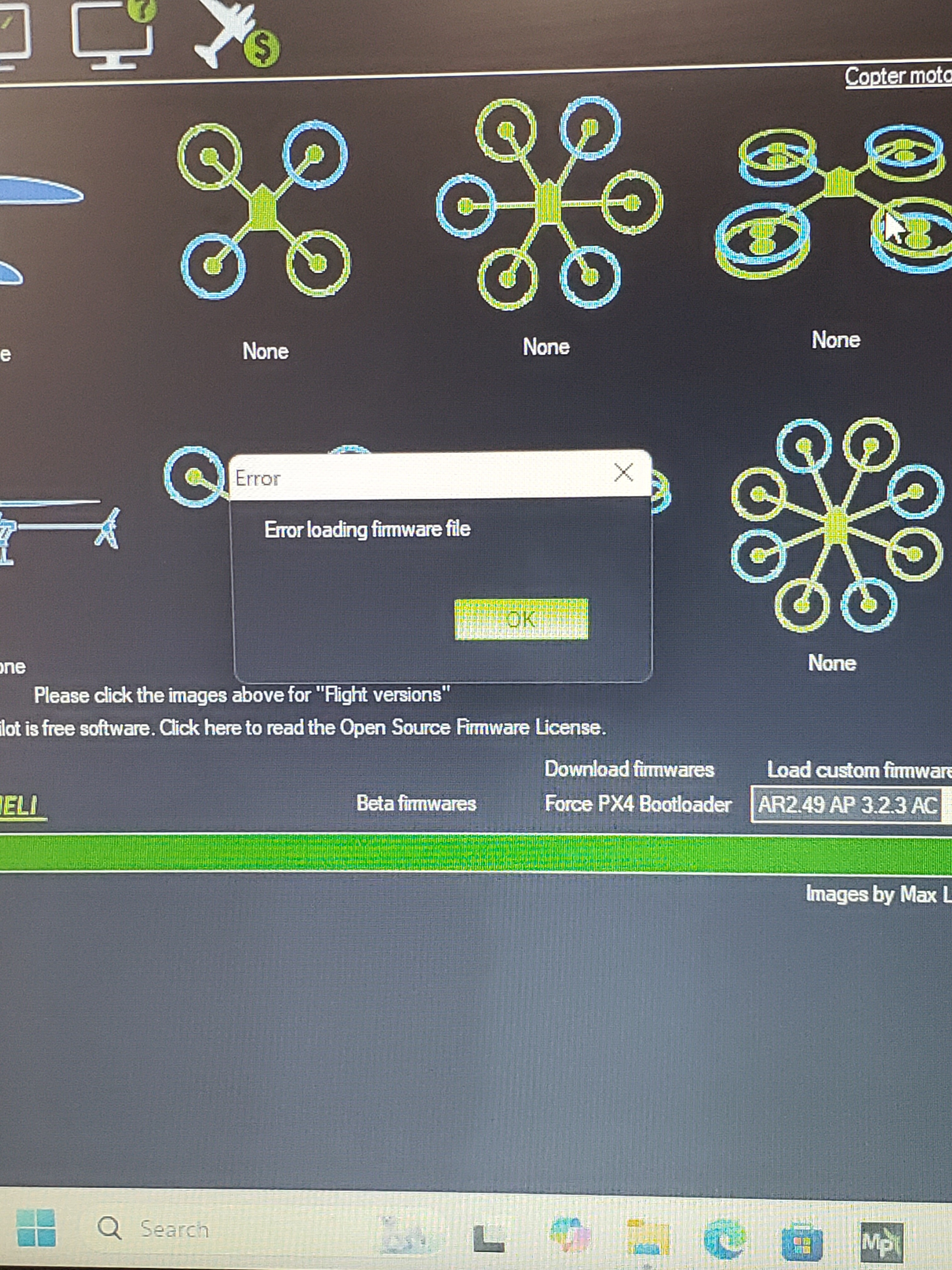

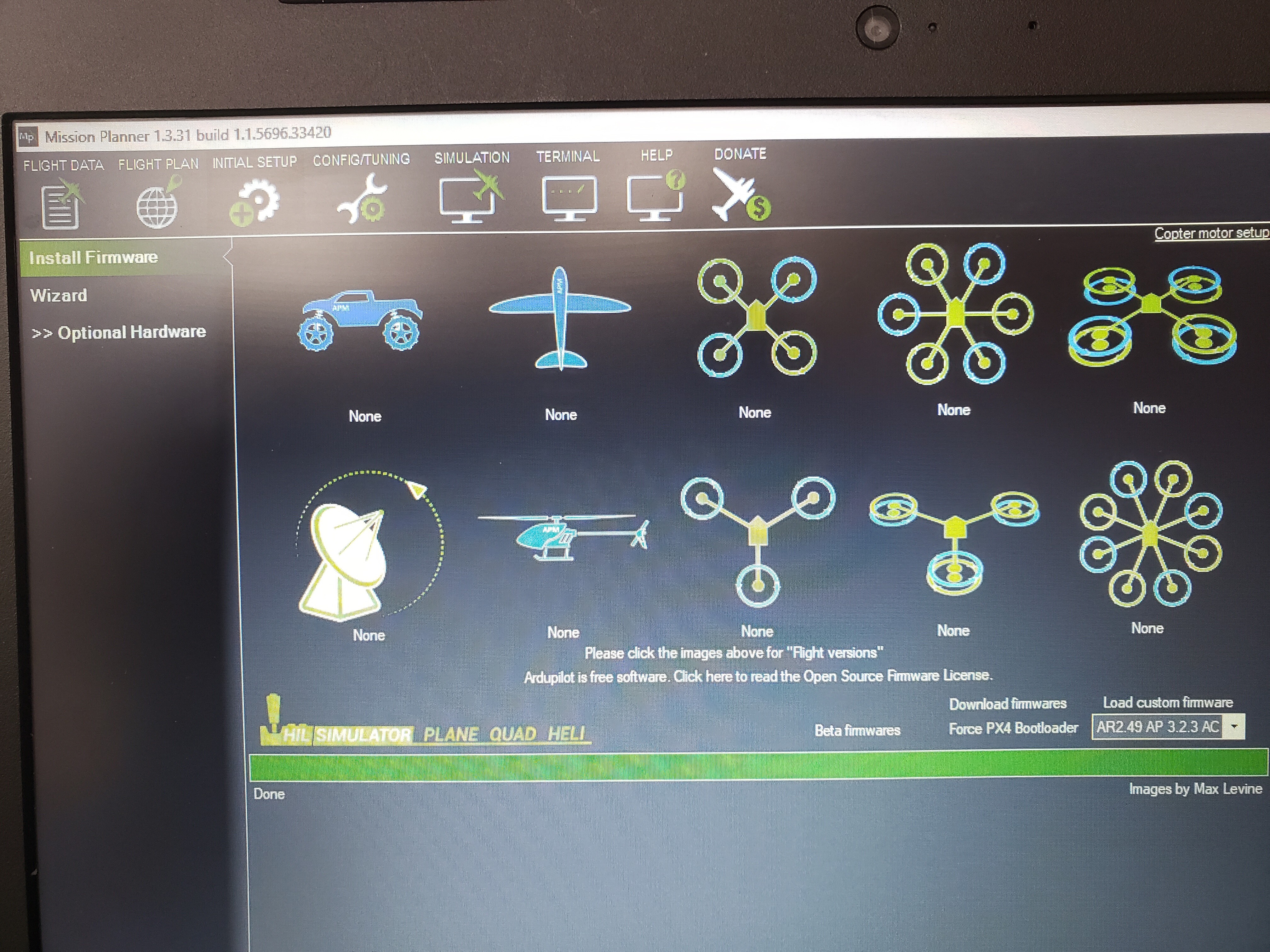

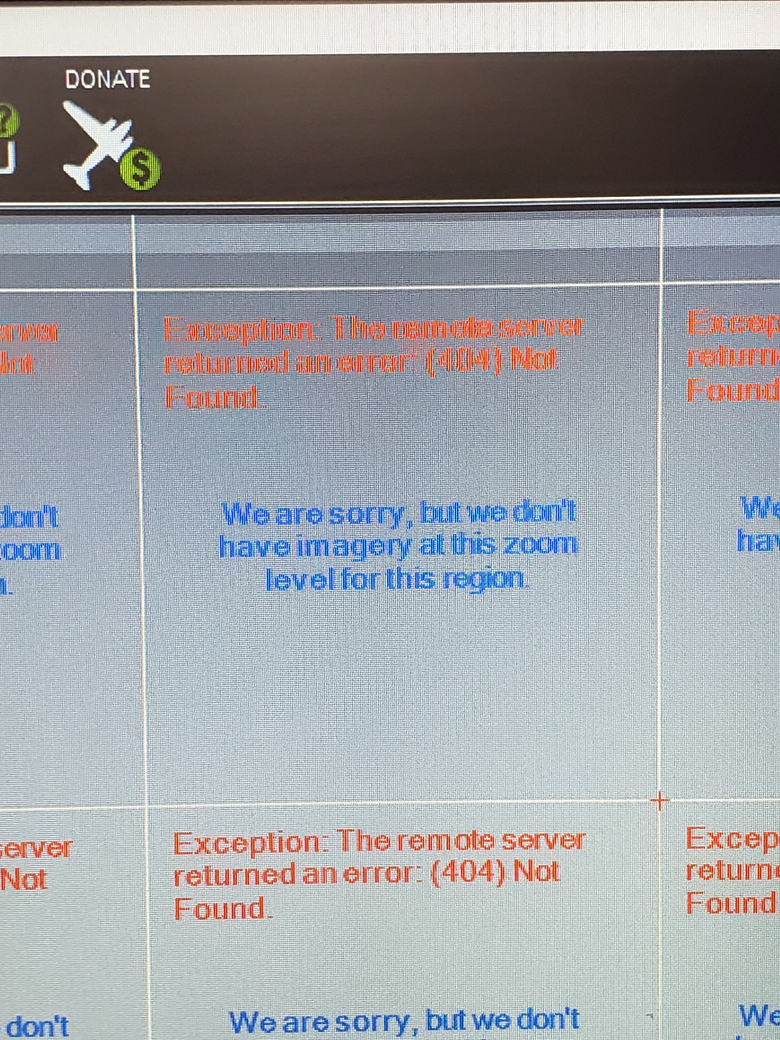

Hey there, I hope you can see this, all the selections has no address, I took a picture so you can see what the error says, and the third picture is showing you that error 404, I’m not a engineer, but is this error 404 having anything to do with the software not loading?

Are you using ArduCopter, or ArduPlane?
Any why do you want to change the firmware in the first place?
No, absolutely nothing to do with firmware, that is a Map that is not loading. perfectly harmless.
You seam to have done steps 1, 2 and 3 on the list posted.
What is the problem of step 4? Step 4 does not tell you to write new firmware to the board.

Ok, I have made a personal man drone which I intend to fly the drone with me in it operating the drone, so if the drone only shut off when you are just setting there, I assume it will operate ok without shutting off. Now if you feel it not safe then I need your help to get it right, I’m not sure if you can talk with one of the top engineers to help us find the problem, PLEASE. That vision you as me to use 1.3.31, I sent you a picture showing you that vision will not work with my P.C
