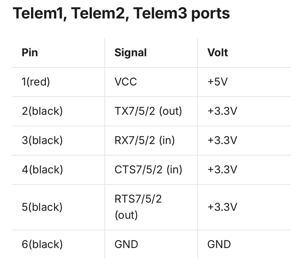

Ok I got it. But now I’m confused about the wiring, I’m supposed to attach
  • ELRS TX β†’ Pixhawk RX
  • ELRS RX β†’ Pixhawk TX
  • 5V β†’ 5V
  • GND β†’ GND
But the Pixhawk UART/Telemetry port has 6 pins and the ERLS has 4 pins, how do I know what 4 pins to attach to on the 6 pins Pixhawk port?
By looking at the port pinout perhaps?
