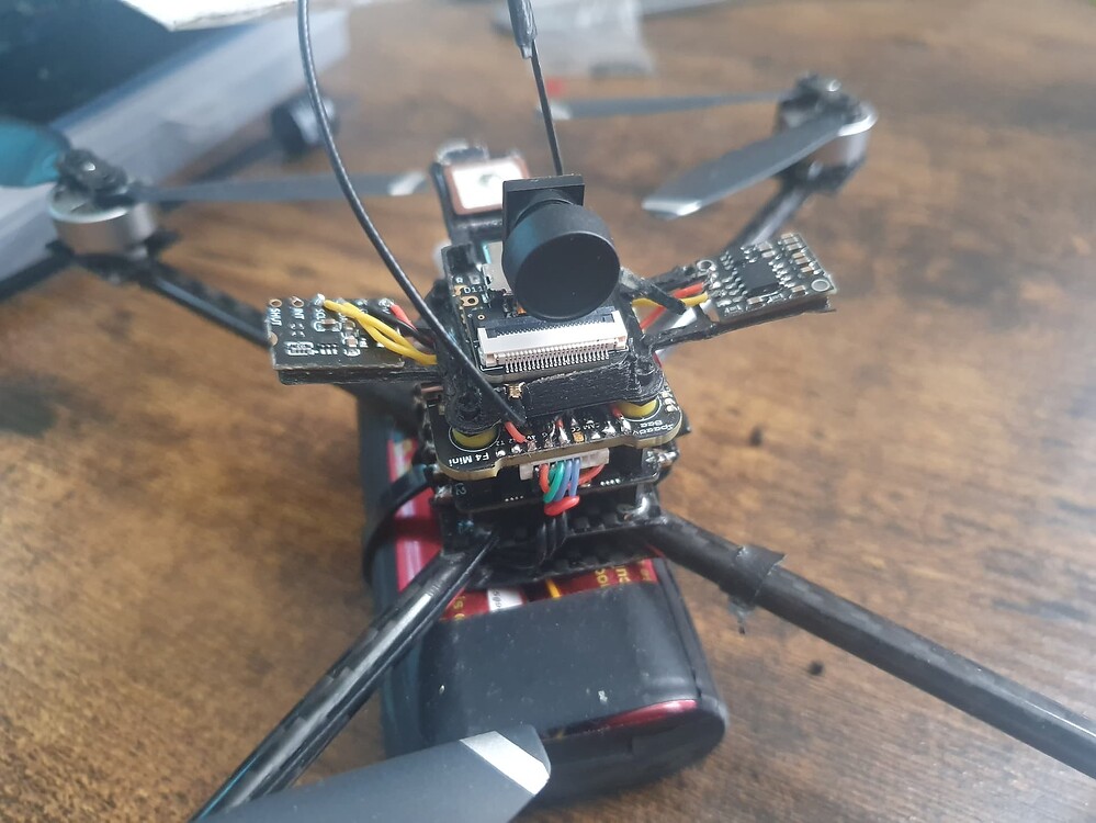

I have decided to rebuild the version 1 again but with some upgrades to make the flight time a bit more useful.
It will keep the speedybeef405 mini, 6A x4 esc and the mavic mini clone motors
Its main upgrade will be a new frame,
1A started off as a solid off the shelf frame and got 44 minutes flight time with a 5000mah battery.
https://www.aliexpress.com/item/1005010518980813.html
1B got the original tube frame with woven carbon and could fly for over an hour with esp32 digital fpv, optical flow and lidar.
this 1C version will have essentially a copy of the v2 frame with its lighter carbon and better wire routing but a little smaller to account for the 4.7" vs 6" propellers, That should shave off some weight so I can add some accessories while keeping the hour flight time.
The receiver has been changed from the frsky R9 receiver to a 2.4ghz ELRS receiver running mLRS, 2.4ghz gives much faster telemetry with a smaller antenna, 2kb/s vs around 1kb/s and will still give more than enough range.

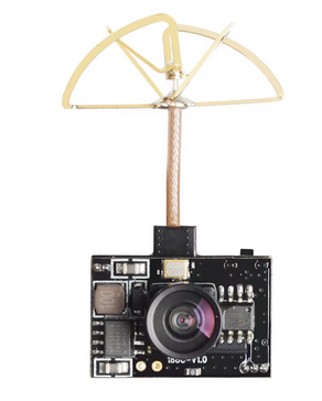

Since I’m now using 2.4ghz RC I’m limited to 5.8ghz video so the FPV has been changed to a 400mw AKK AIO camera, that should give it some decent range. it’s around 4g heavier than a 25mw camera but the lighter frame should offset the extra weight, it will also use a lot more power than a 25mw camera, in most builds its insignificant but on something like this it could be few minutes flight time running at 400mw constantly. its got smart port so I can control it from ardupilot, that will at least that will limit its power draw when it’s not needed.
update: it arrived and it turns out it doesn’t have smart port and isnt made by akk,dispite it being in the name so not ideal, il probably use it for my rc car.
https://www.aliexpress.com/item/1005007989854892.html
I will add the VL53L1X lidar and CX-OF optical flow sensor back on, its only around 2g and its nice being able to loiter it indoors.

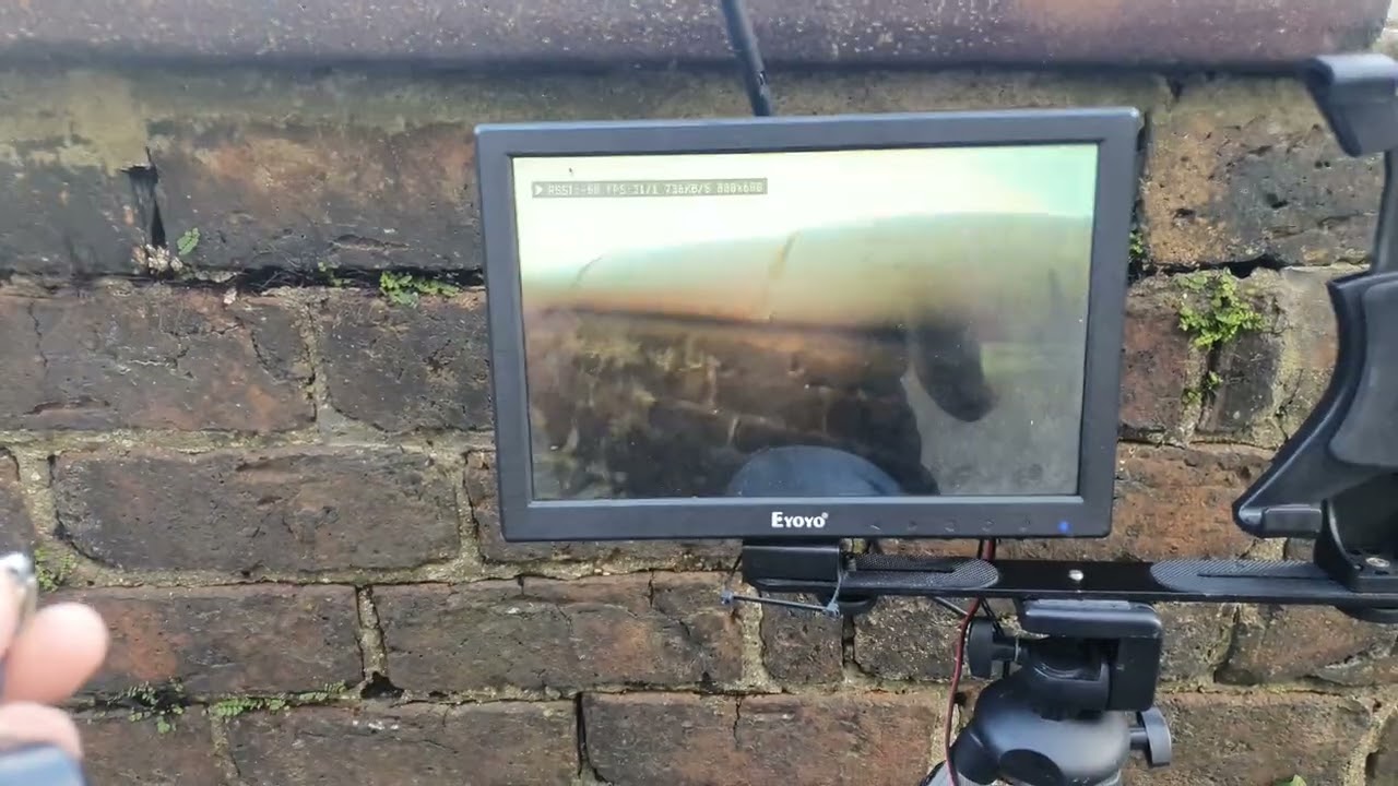

Do you have the video file from the esp32 fpv?
Thanks
It’s pretty good for what it is, the main issue is it’s on 2.4ghz so you need to use 868/900mhz rc.

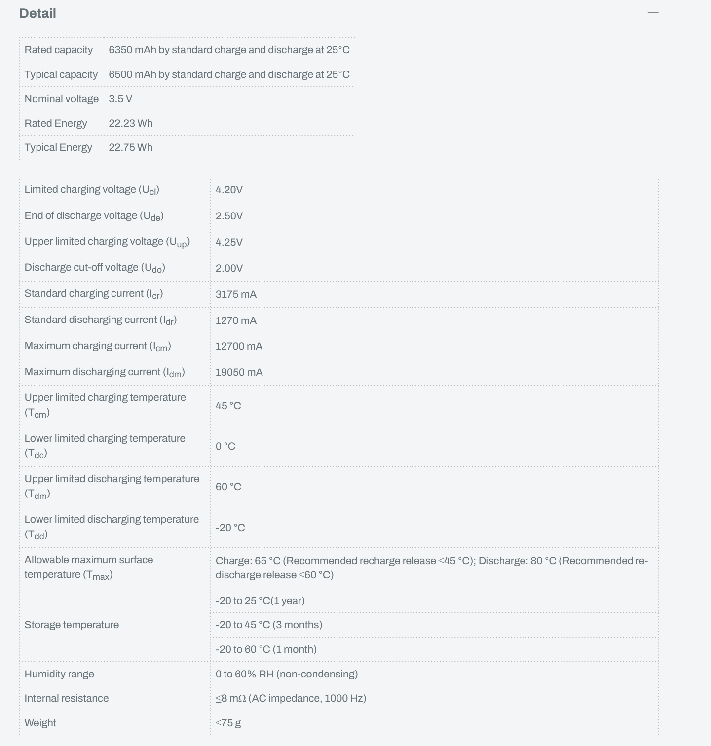

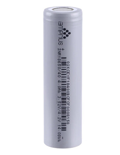

I have ordered another 2 sets of batteries,

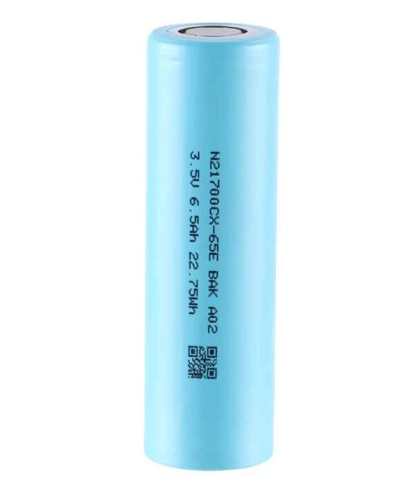

the BAK N21700CX-65E 6500mAh

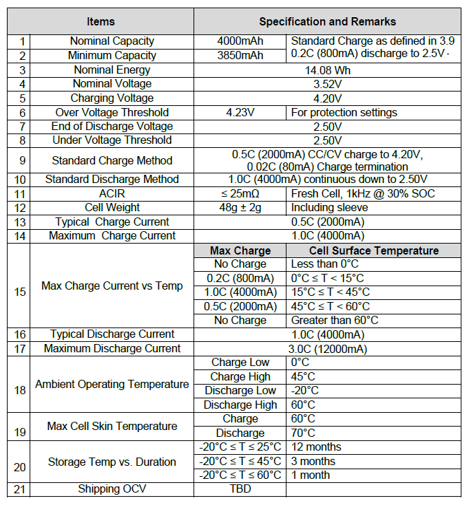

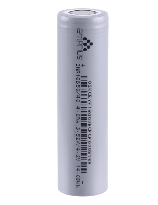

and the Amprius SA110 4000mAh 18650, its less energy but its also much lighter, the ultralite should fly for an hour with them with a total weight of only 170g.

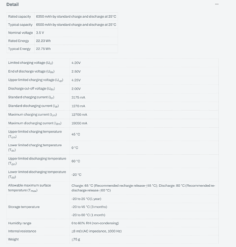

The Amprius SA112 6500 mAh cells have been through the tester and seem perfect, showing 6700mah, I’m happy with that result so I can get them made up into a pack.
I just realised something about these new 6500mah cells, the “rated capacity” of 6500mah comes at the expense of a lower nominal voltage of 3.46v instead of 3.7v, meaning that although it can output more amps for longer, it comes at the cost of a lower voltage and because of the lower voltage the total energy ends up actually being lower than the F63 6250mah cell.

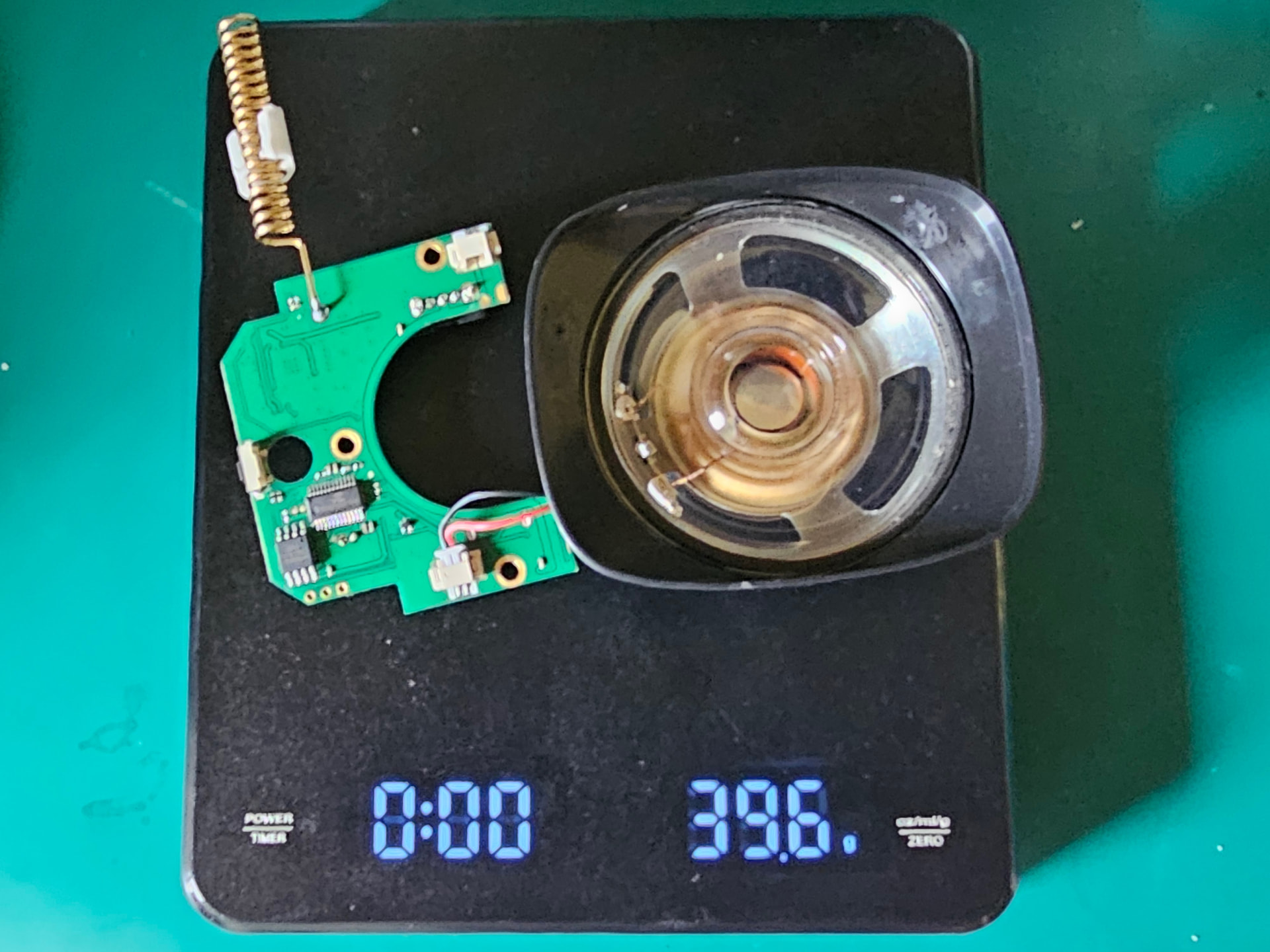

The accessory is a long range speaker and the whole thing must be under 250g, so I can legally fly it in Europe. I’m going to offer services like for example the drone coming in to a garden party and it (me) would say wishes or some other message. A friend asked me to do this, I did it using my Avata 2 and it was super fun also with videos. But adding anything to Avata 2 isn’t legal where I live, so here I am.
I would be very thankful for a suggestions what parts would be the best, I can return a favor by sending a small tip using one of buy me coffee services for example.
If you decase the speaker you probably could save a few grams. Latest Geofrancis build was pretty close to 200g IIRC.
Oh it’s already decased! I added 10g for cover to be sure, maybe I will use some foil in the beginning. Its battery is just 4g, but since power would be the same voltage, then I can get power directly from 21700. With a case and mount it weighted almost 100g, but when it’s like this, I could use two rubbers to mount it. I will do some tests, but I think it will be well heard even when installed horizontally on the bottom. It doesn’t look like it when decased, but it’s pretty loud.
