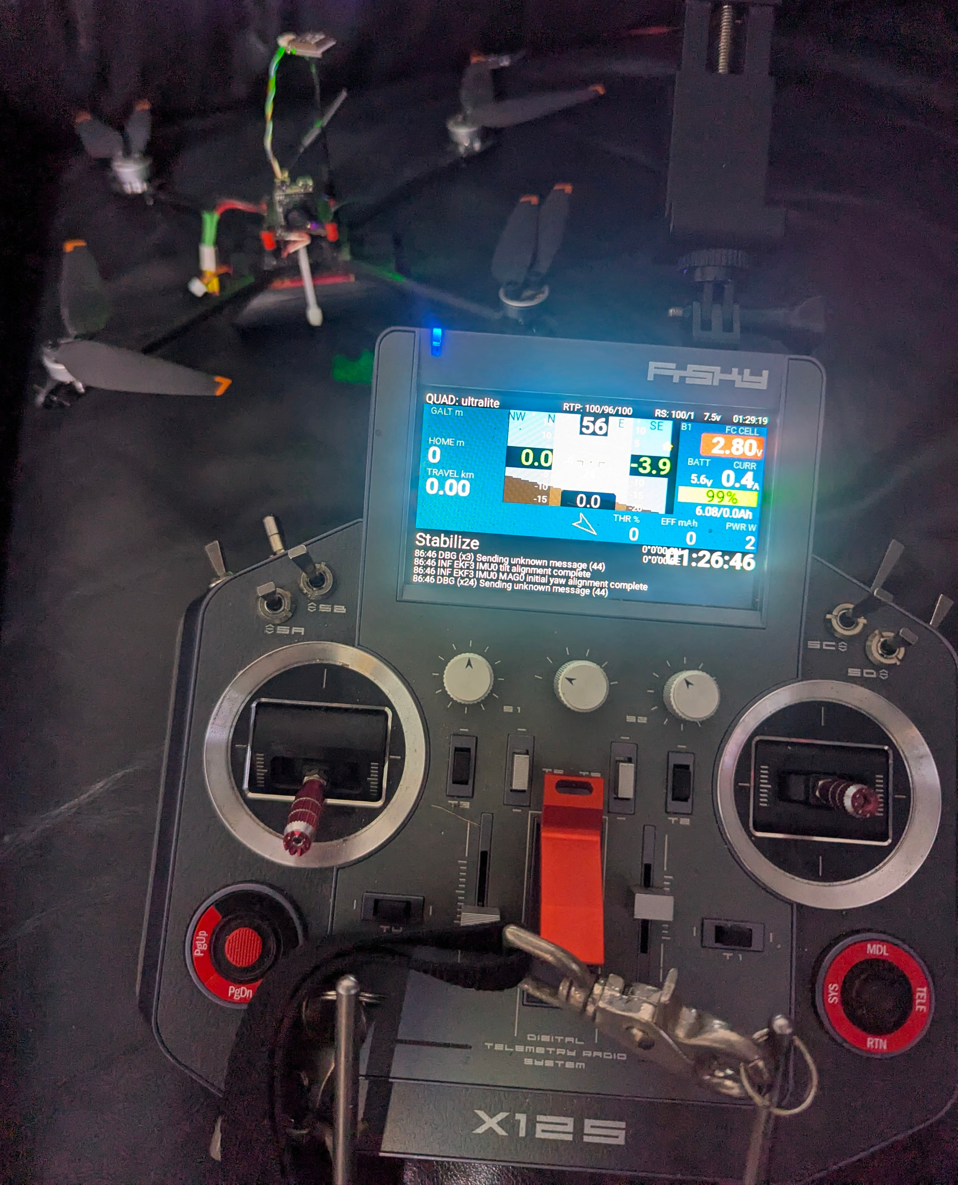

I finally got around to replacing the defective motor on the V2 ultralight and it’s beyond my wildest dreams. It had only done a quick hover when I first built it and I found one of the motors were defective so it had only been in the air for a few seconds up til today. When I changed the motor I got the old 6000mah pack that I charged up probably 4 months ago and done a test hover indoors in alt hold mode.
And it done this!!
1 HOUR 26 MINUTES!!
This was with GPS, fpv and mission planner connected over MLRS.
Next step is to get the new 6250mah pack welded together and get an outdoor test flight I think 1 hour 40 minutes is a real possibility, total weight is around 210g.
Turns out this AIO board does have current monitoring. it was consuming around 3.9a at takeoff then around 5.2 when it was landing. im not sure how accurate it is but it says it consumed 6.08ah.

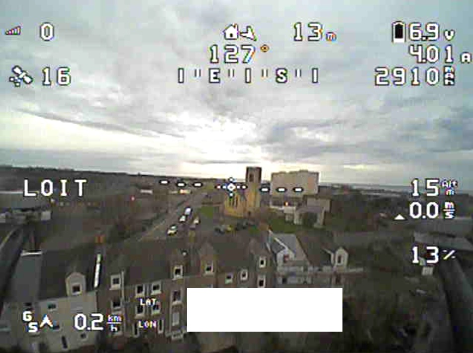

I done another flight but this time outdoors and it got 1 hour 26 again, I landed at 2.40v per cell
It’s a little wobbly due to very relaxed pid but once it got a decent satellite lock it just sat there.
I just noticed in the video it indicates that its only using 26W!.

Someone was asking why the altitude doesn’t make sense, basically I was flying around in althold while it got GPS fix, I wasn’t sure if the GPS worked at all or if it would get a fix next to the building and I didn’t have time to wait as it was going to get dark. Because It’s got its home position while in the air its home altitude is set to its current altitude. I will re-enable arming checks next flight and wait for 3d fix before takeoff so it should be accurate.
