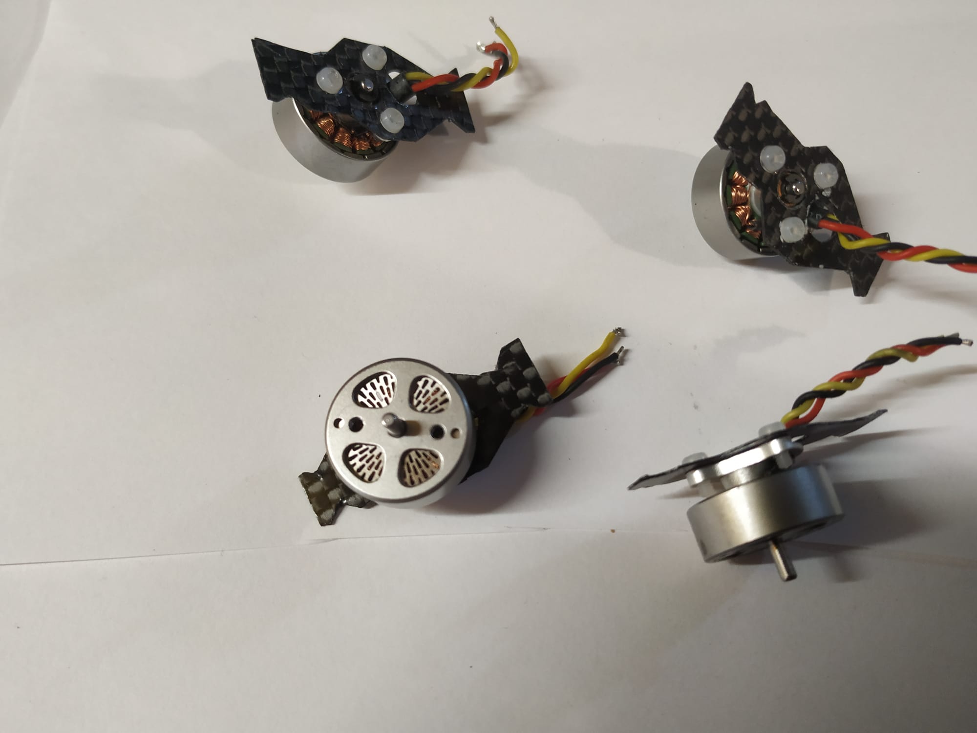

The motors are from something similar to a dji mavic mini, it’s rated to 8 m/s (17.8 MPH) wind, so this should be safe up to those limits.

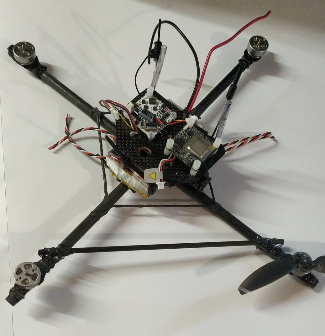

Making some progress with my build.
One key design point, is that the battery sits direct on one of the tubes (45deg to line of flight). The FC (GOKU F405 1-2S 12A) is strapped to the battery with the goal of minimising the vibration that the FC experiences, because the battery mass is 60% of the drone and will damp out the high frequency vibrations.

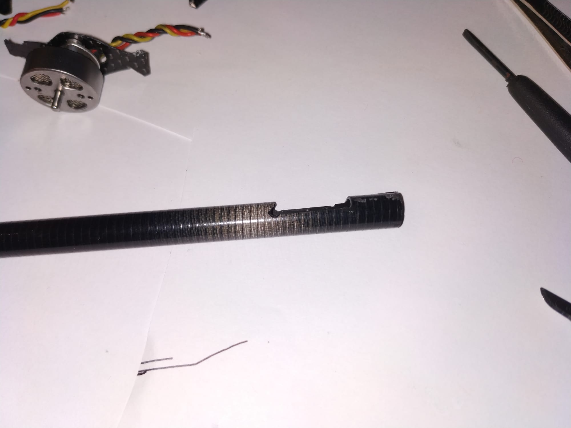

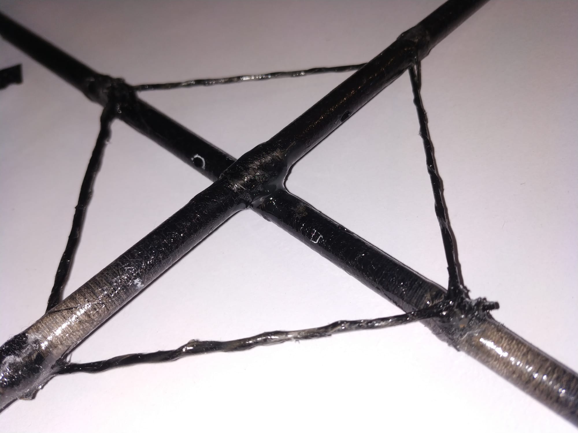

Frame tubes are 8mmX0.5 wall. Bonded together with epoxy coated carbon “thread” and braced with 1mm rods. Arms are long enough to upgrade to 8" props later.
Camera and GPS mounting not decided yet.
Motor mounts are tied in place with kevlar thread and a spot of hot glue (easy to remove and change later for different motors). wires run inside tubes.
thats very cool. how much does it weigh?
Thanks. It is 258g with the gps (not too bad considering Walksnail video, the long arms and larger tube dia). I can see some potential for reductions like mounting FC and video as a stack, but I’m happy with it as my first ever build. I wanted it a bit stronger to cope with my likely crashes as a beginner (like the tube extending beyond the motors to take an impact to save the motor from a direct hit). A “V2” version should be possible under 250g.

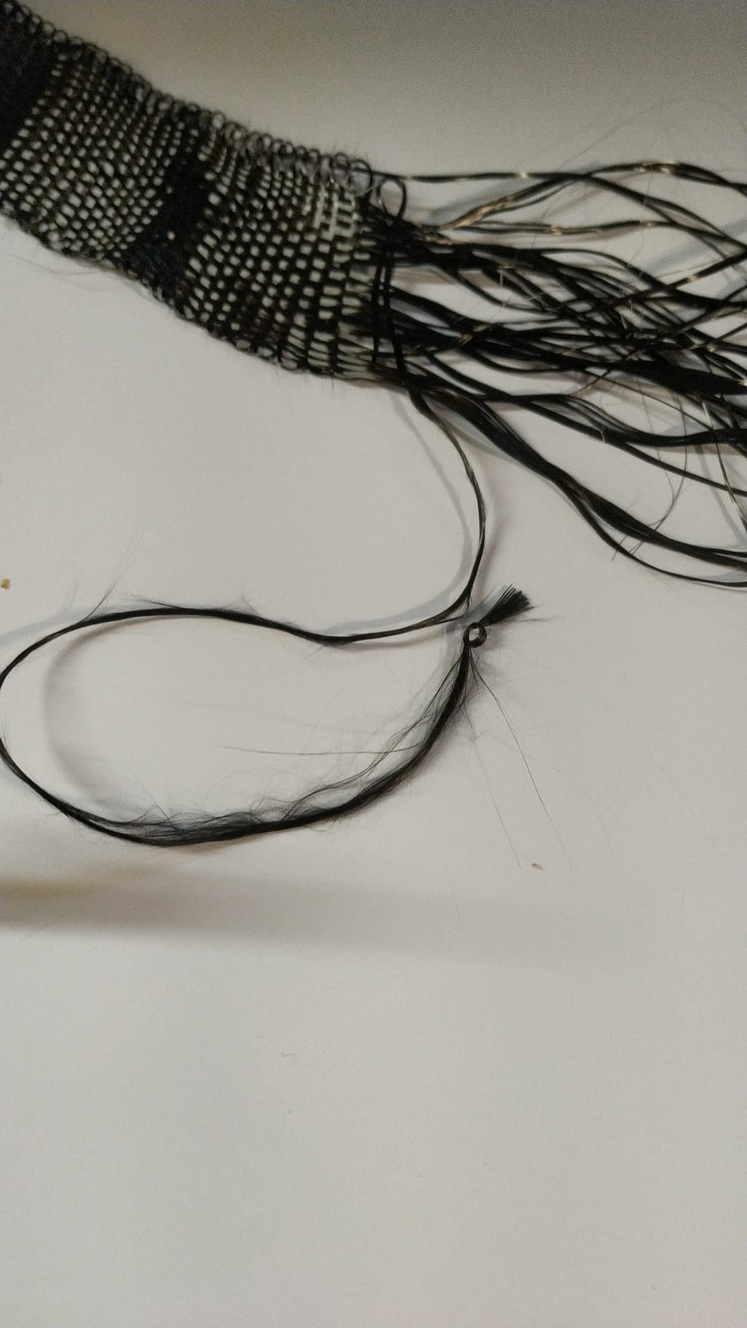

My source of “carbon string”
