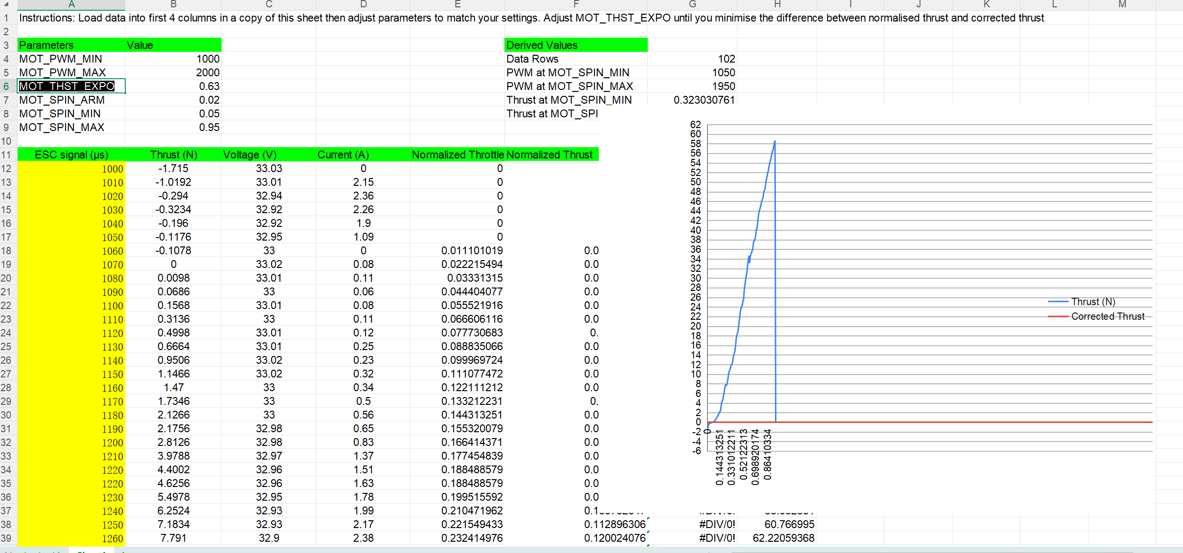

We fixed and updated Cell G8 as well as the plot’s Data range of the original ArduPilot Wiki Spreadsheet creating this corrected version We imported the data into the spreadsheet and created this graph:

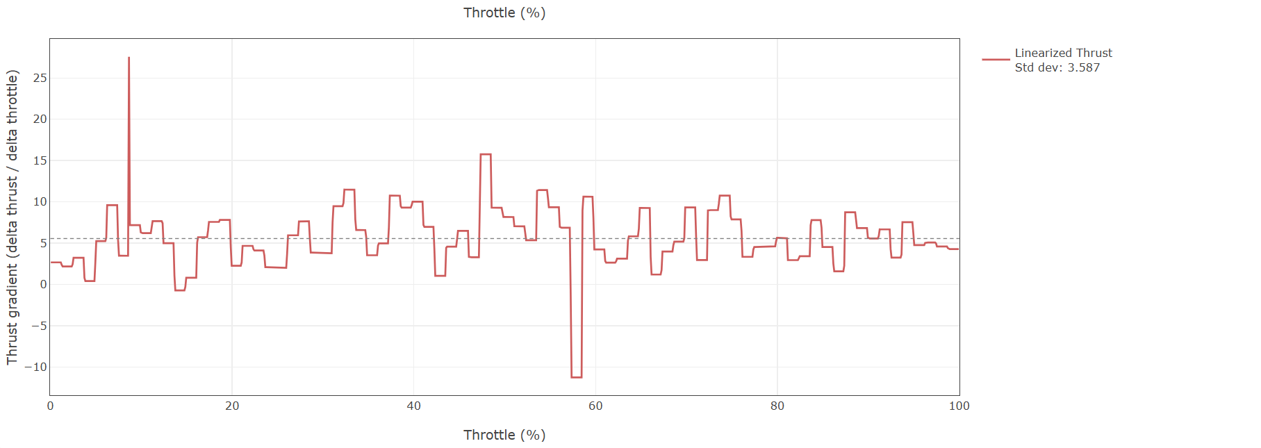

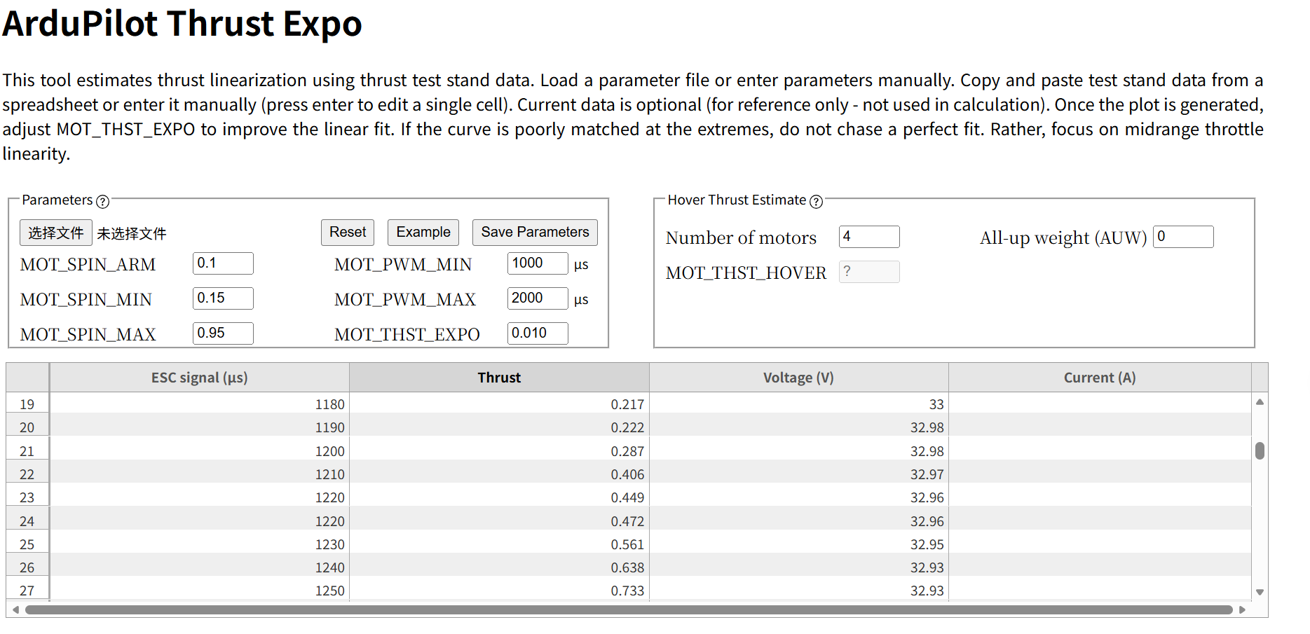

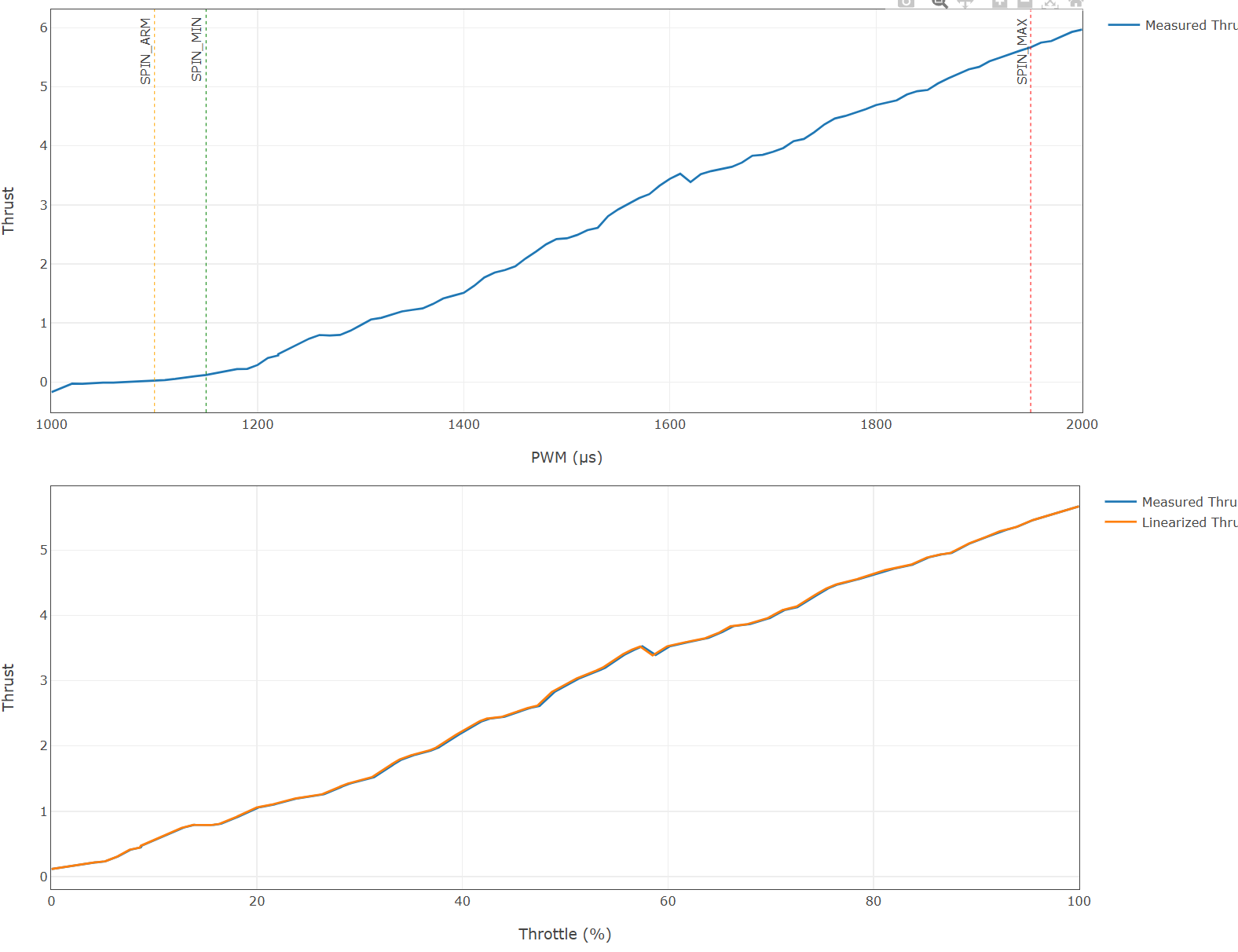

Following the AMC procedures, I tested the motor thrust using a thrust test bench. I input throttle, PWM, voltage, current and thrust data into the spreadsheet in the corrected version of AMC, but the corrected thrust curve failed to generate.
I then imported the same data into the original ArduPilot Wiki Spreadsheet, which successfully generated both the real test thrust and corrected thrust curves. However, I had to set MOT_THST_EXPO = 0.01 to get the corrected thrust to fit my measured thrust data.
According to the official Wiki, the recommended MOT_THST_EXPO value is 0.66 for hobby-grade multicopters with 15-inch propellers.
This makes me wonder if my ESC already provides excellent linear compensation by design, which allows MOT_THST_EXPO = 0.01 to match the measured thrust curve perfectly — or if I made a mistake during the testing and configuration process.

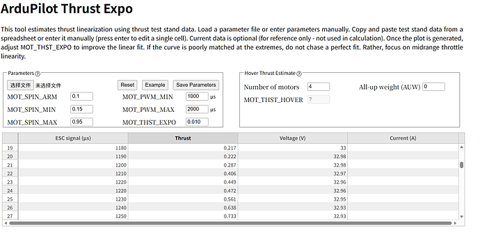

Additionally, I noticed a work-in-progress tool called Thrust Expo in the ArduPilot Web Tool. After entering my throttle percentage, PWM, voltage, current and thrust readings into this tool, I got the same result:
with MOT_THST_EXPO = 0.01, the red reference curve aligns almost perfectly with the blue measured thrust curve.
I would like to ask for your advice:
Does this mean my ESC and motor combination has exceptionally linear thrust response? Or is there an error in my test method?
From what I know, 0.01 is an extremely low and unusual setting for thrust exponent. For T-MOTOR Flame series ESCs, the official recommended MOT_THST_EXPO value is 0.25.
My thrust test bench operates with a PWM range from 1000 to 2000. It only allows a minimum throttle increment of 1%, with the throttle adjustable and recorded once per second.
I set the test to ramp the PWM from 1000 to 2000, increasing the throttle by 1% every second and logging the thrust value at the same interval. As a result, the curve is generated from only 100 data points in total. I’m not sure if this resolution is sufficient and adequate enough.
No. The process described in AMC is precise enough
Yes.
Yes. That is enough. Looks like your powertrain response is extremely linear. But make sure you set the min value so that the non linearity on low pwm values gets cut off.
From the graphs , one can see you did that correctly as well.
Using AMC meant less trial and error and it did save you a lot of time, right?

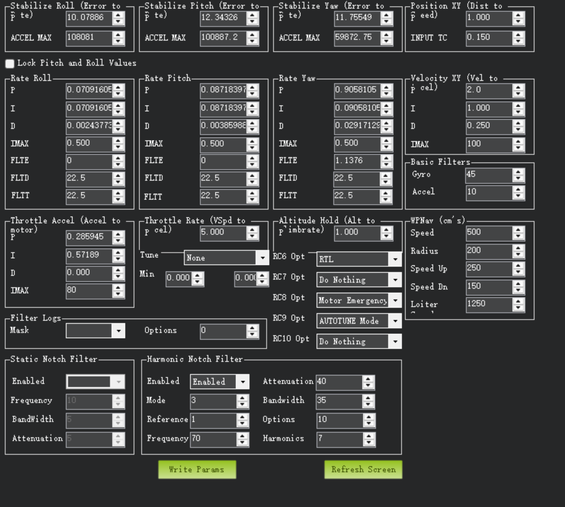

Thank you for your reply, @amicarlucasamicarlucasamicarlucasamicarlucas. I followed the AMC procedure step by step: completed filter configuration, performed quick tuning, corrected the compass via MAGfit, then ran quick tuning a second time. Afterwards, in near windless conditions, I completed auto-tuning in the sequence: Roll – Pitch – Yaw – Yaw Damping. I then re-ran auto-tuning for the Roll and Pitch axes again.
I noticed the Rate PID values dropped significantly: the Rate P was around 0.15 after quick tuning, and fell to roughly 0.07 after full auto-tuning. Meanwhile, all Stabilized P values increased noticeably, rising from the default 4.5 to approximately 12. Clearly, auto-tuning delivered obvious improvements.
I have a few questions:
First, is it normal for the angular-rate loop PID values to become lower after auto-tuning compared to the values obtained from quick tuning?

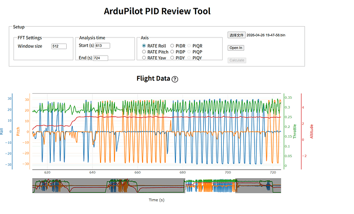

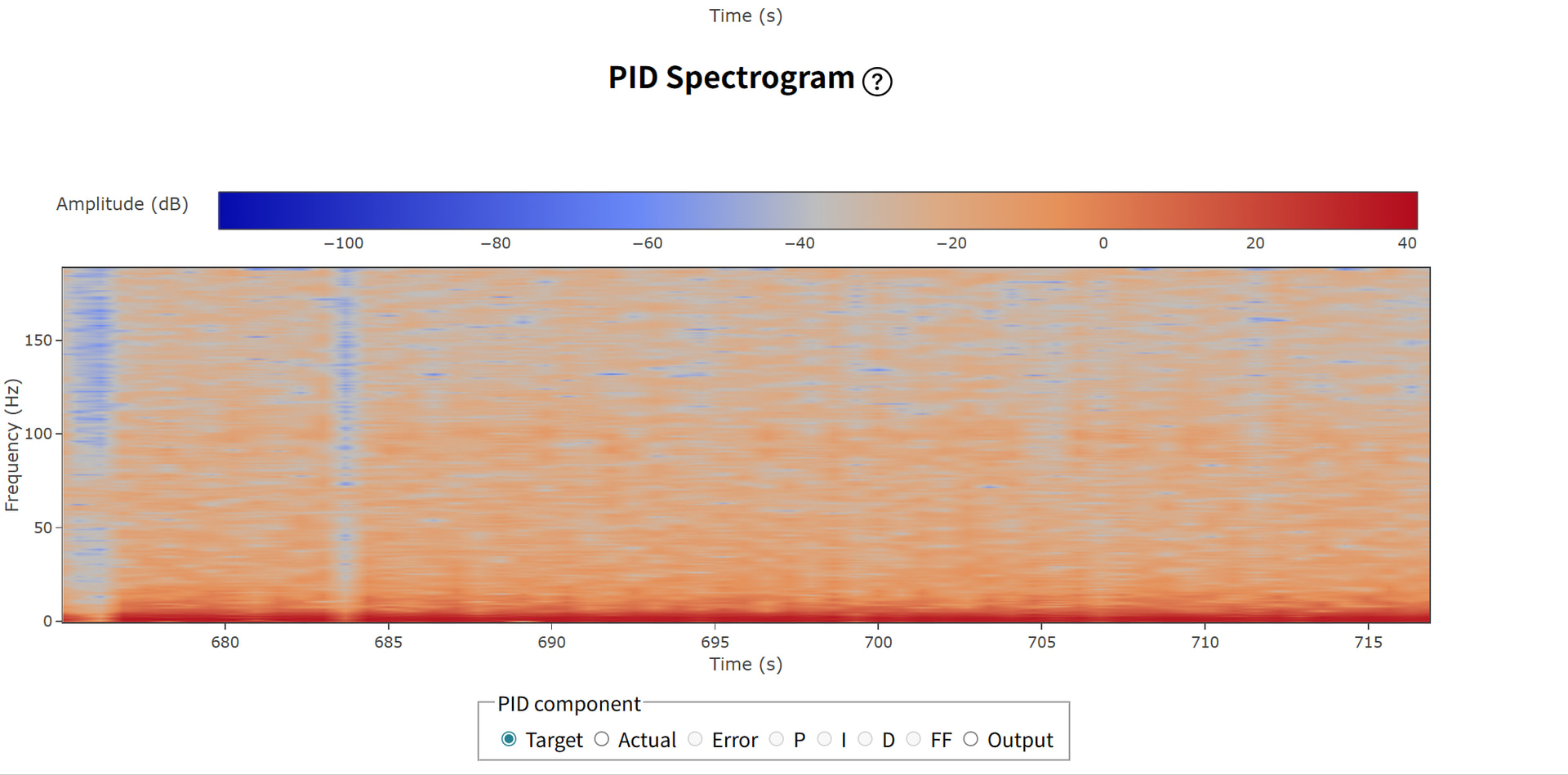

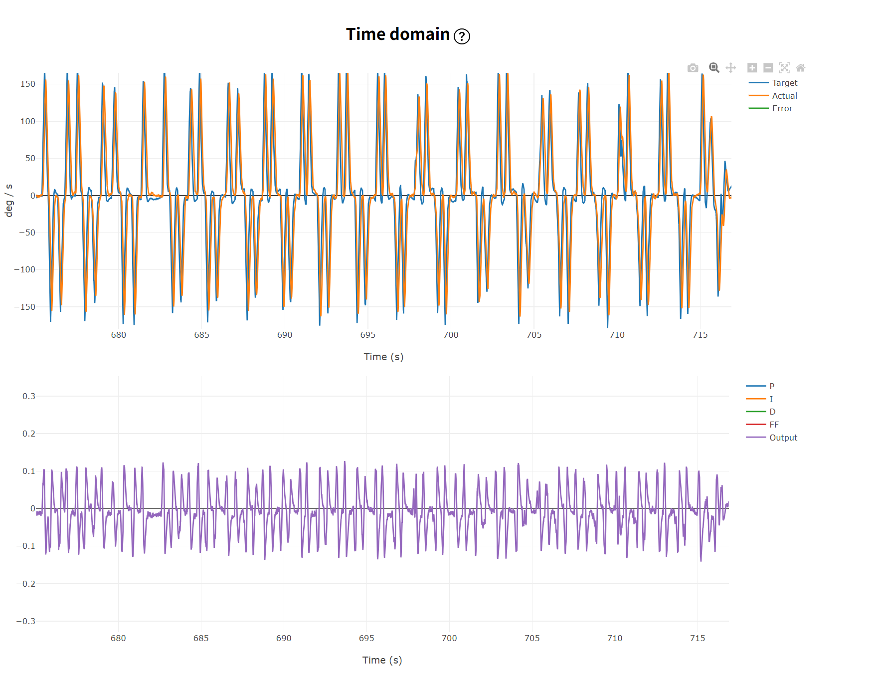

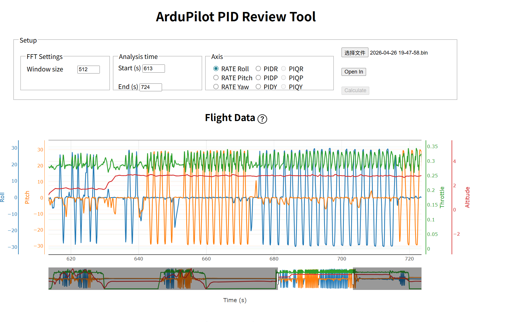

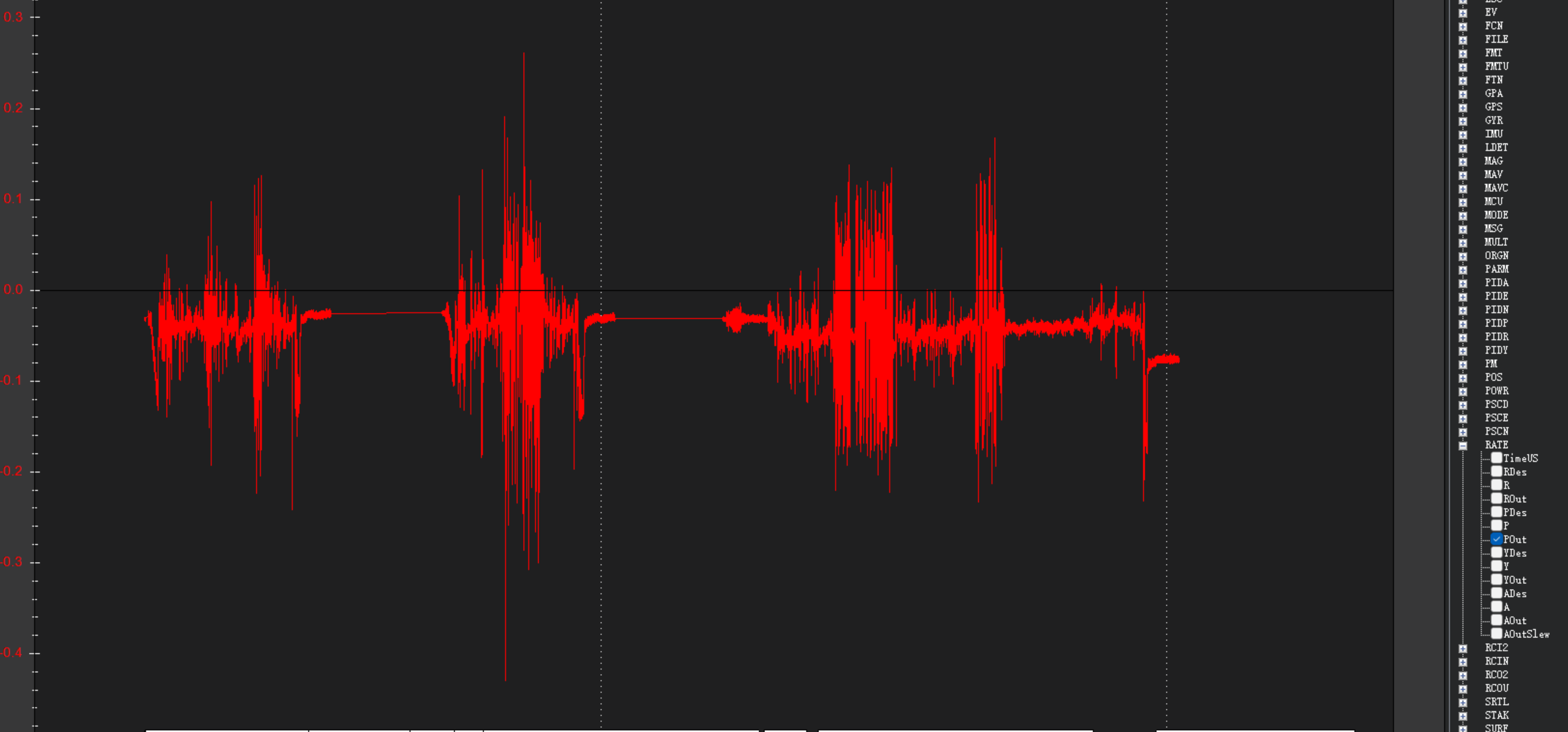

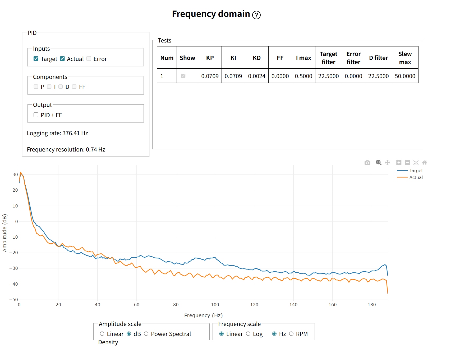

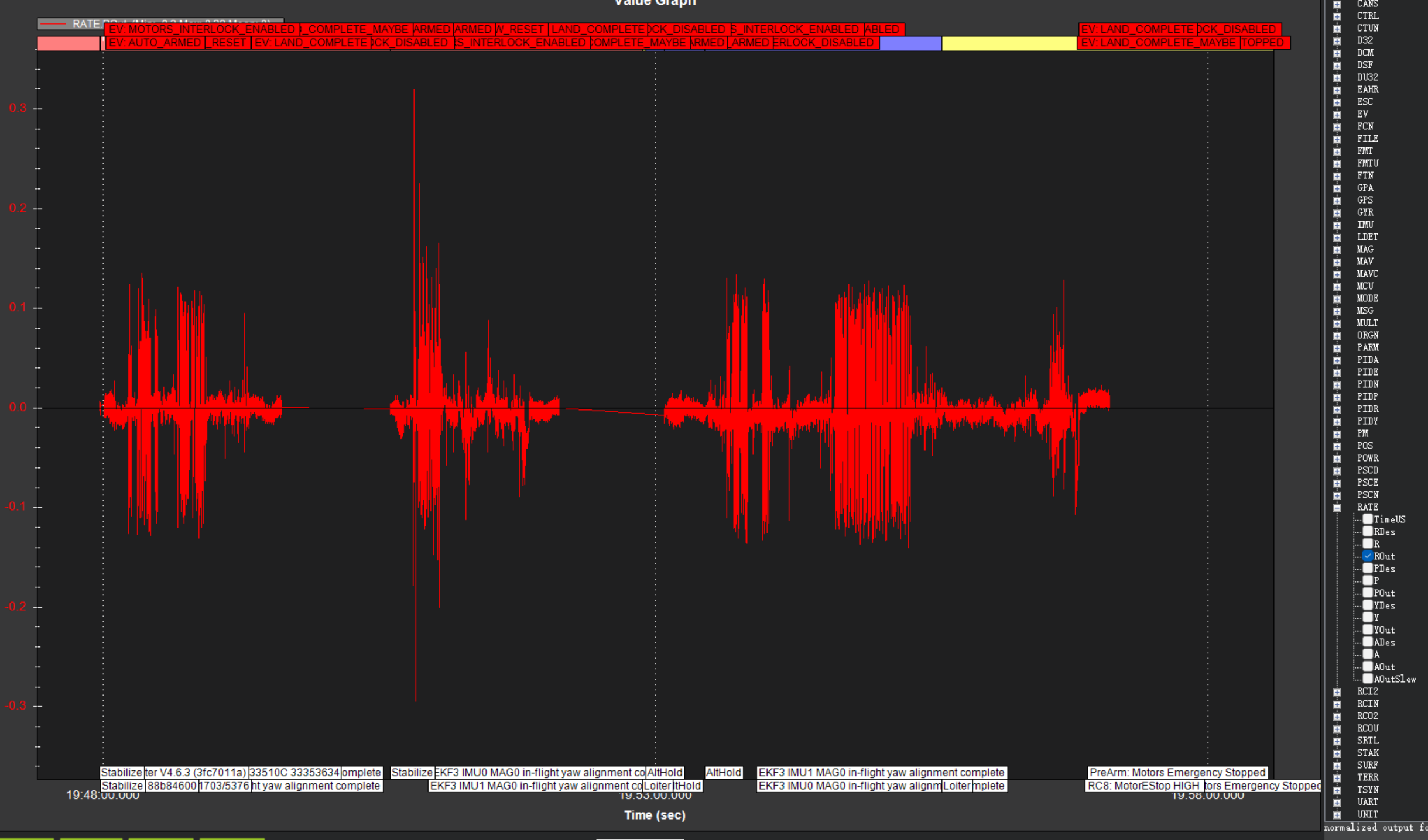

Second, I have attached screenshots of my logs. AMC indicates that ROUT and POUT should stay below 0.1. Currently, they remain within 0.1 during hovering in ALT HOLD mode, but exceed 0.1 when rolling left and right with stick inputs. Is this normal? If not, could you help analyze the causes?
In particular, as can be seen from the graphs above, RATE.POUT does not fluctuate centered around zero. What issue does this indicate, and does it pose any flight safety risks?

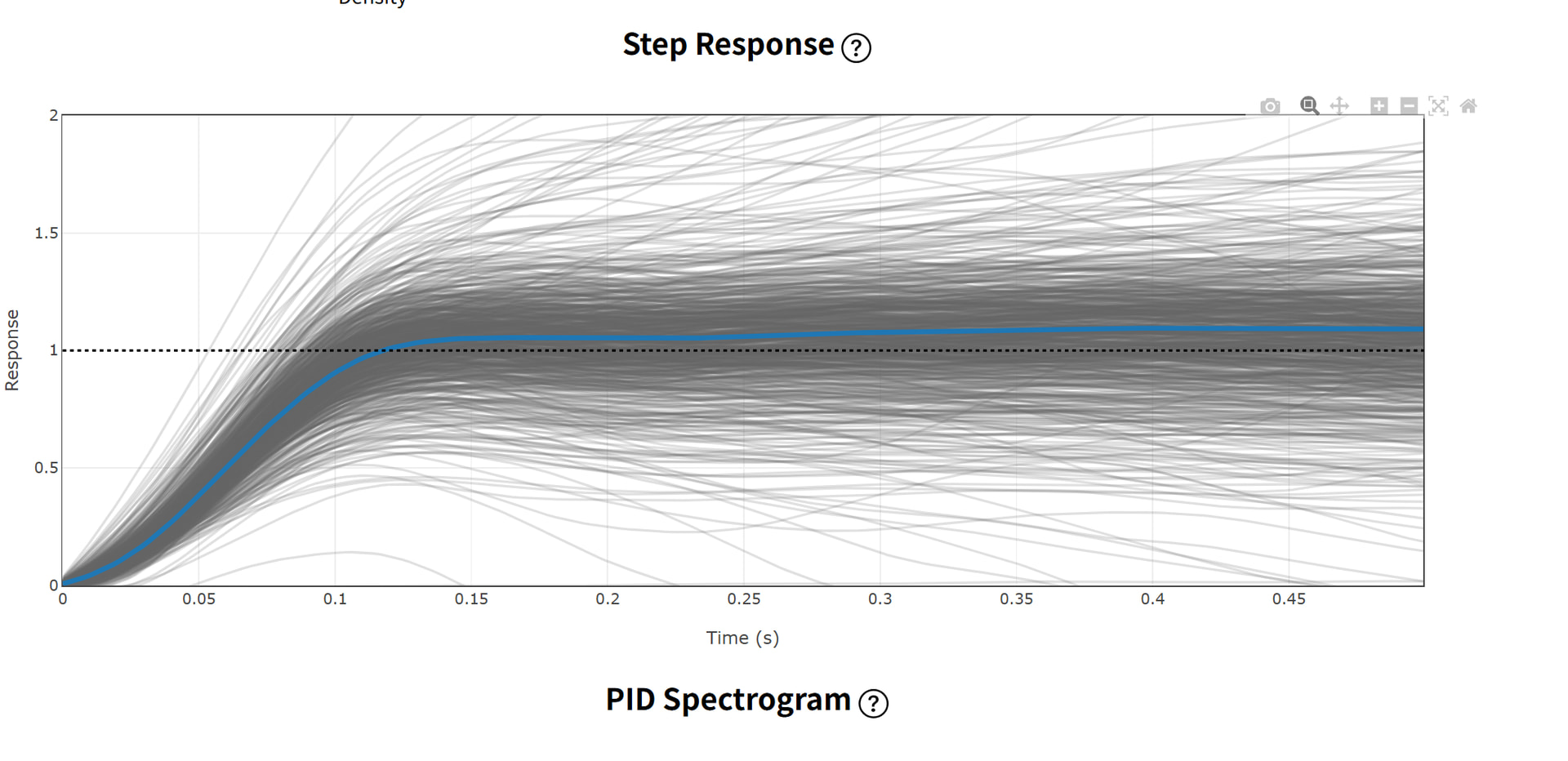

Third, in Stabilized and ALT HOLD modes, the aircraft feels very responsive to transmitter inputs. From the PID Review graphs, the step response curve fits the ideal target perfectly. However, I would like to confirm whether the settling time, peak time and rise time meet the requirements.

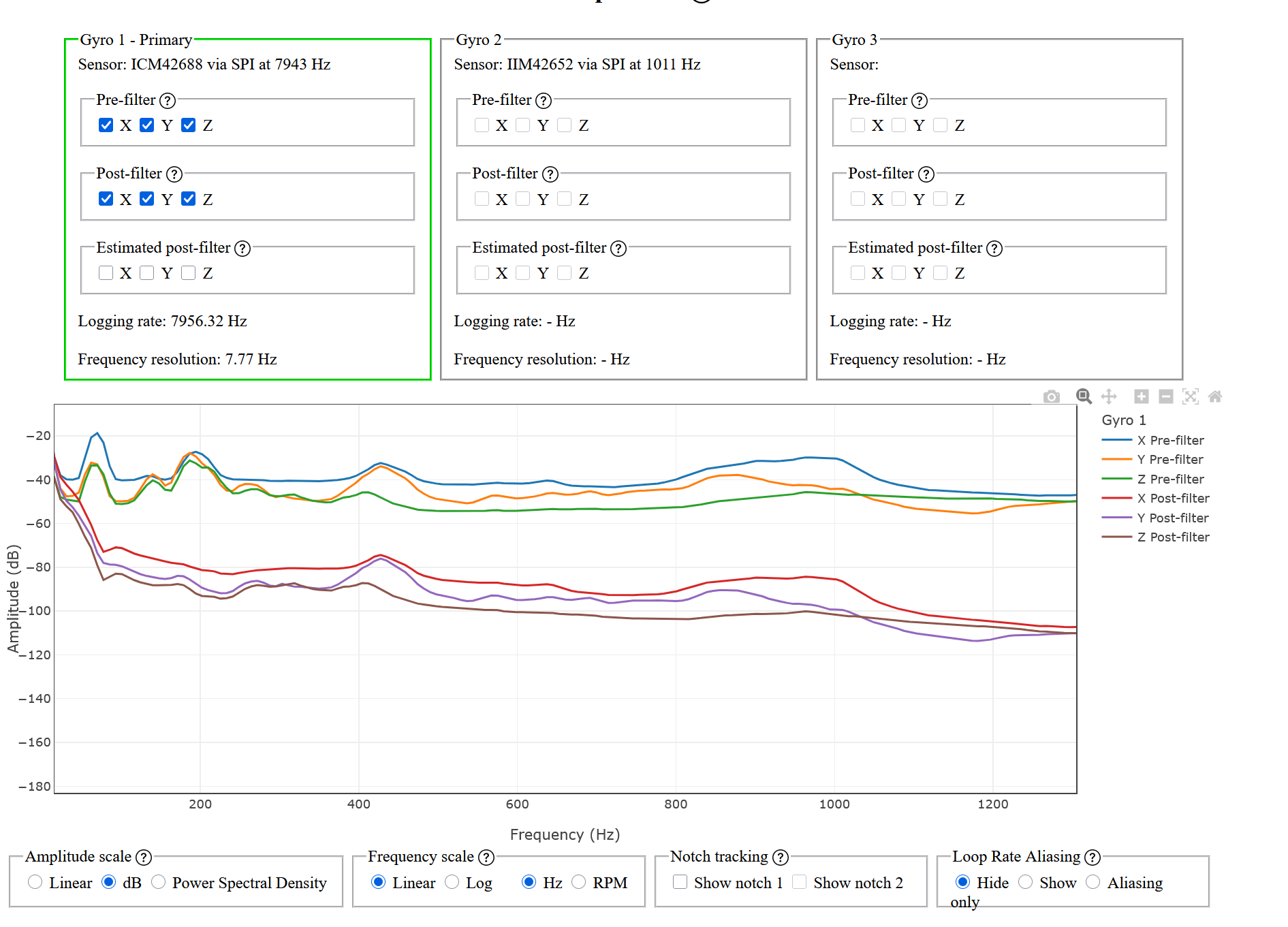

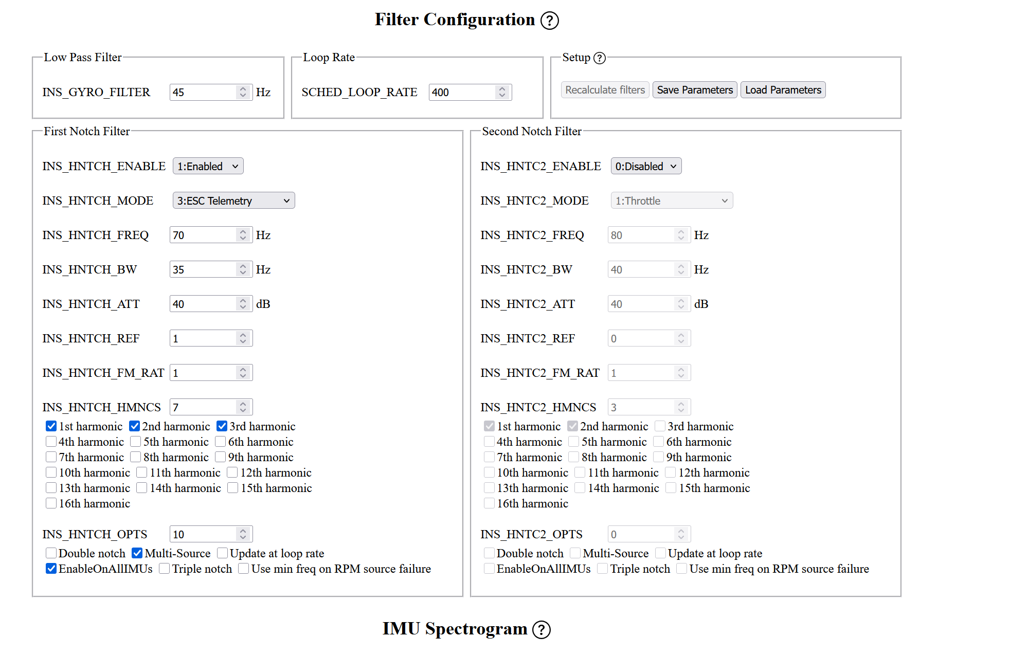

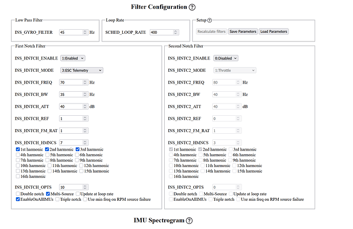

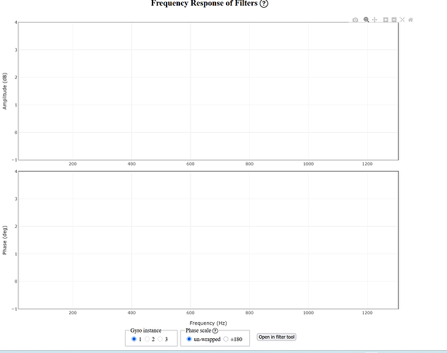

My filtering performance is decent overall, with most noise attenuated below -50 dB. After enabling the multi-source mode, I followed tutorials from YouTube which state that the bandwidth should be set to one-quarter of the notch filter’s center frequency. However, when I configure the bandwidth to this value, the corresponding peak cannot be attenuated below -50 dB. I am unsure whether a larger bandwidth introduces higher latency and further impacts PID performance.

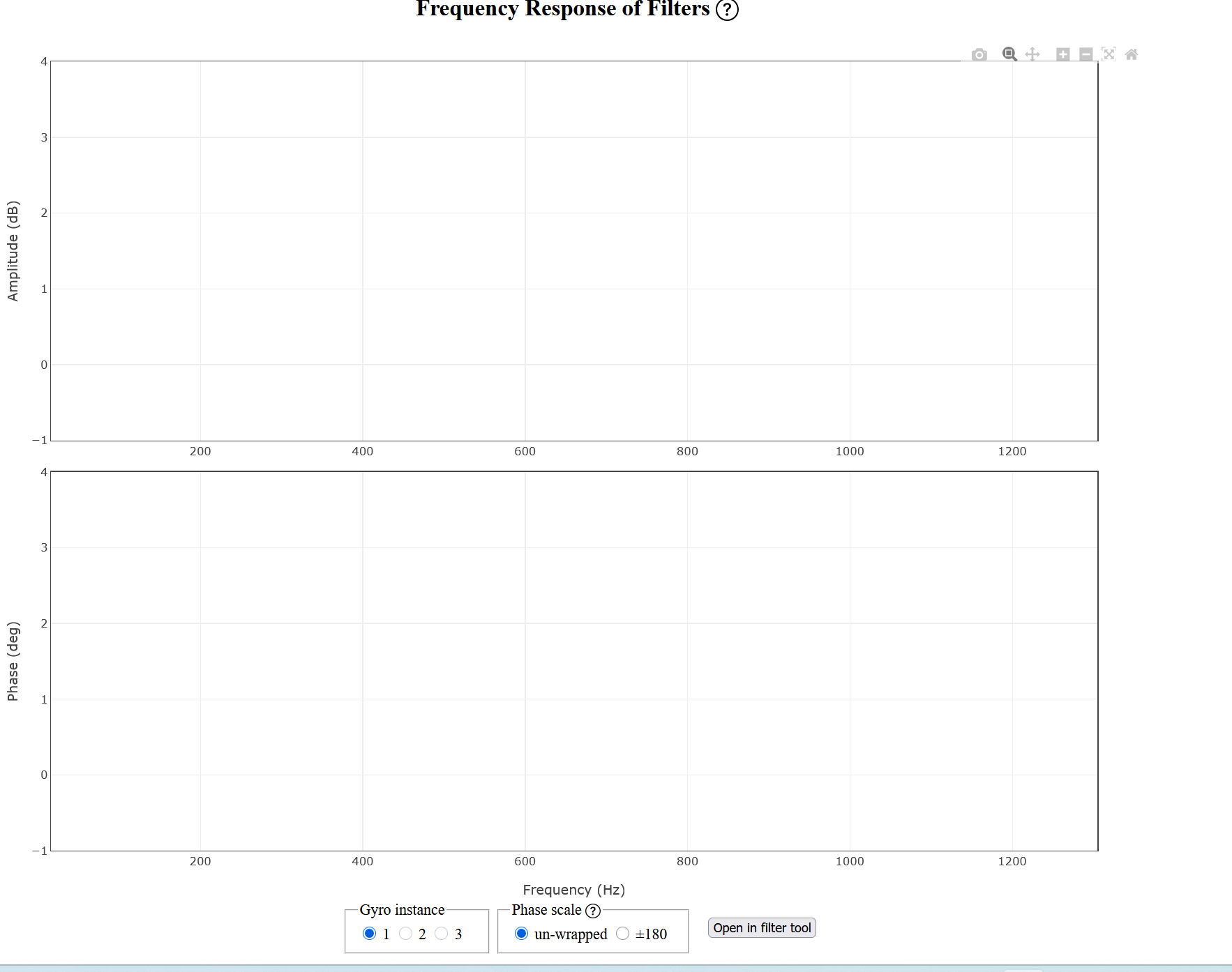

It’s strange that there is no data displayed in the Frequency Response of Filters this time, while it worked properly before.
Most likely there is only enough data for a single window. Check if your dropping log messages.

It is not normal, but it can happen when there is sensor noise. See the generated tuning_report.csv file for information how the PIDs changed in each tuning step.
No, that is all fine.
In the picture all looks fine. Post a picture of the results of a narrower bandwidth.

Tomorrow I will lower the filter bandwidth and test the performance again.

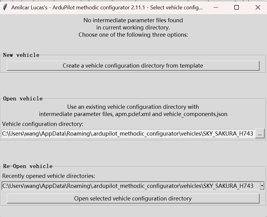

Why not use it on this aircraft? It imports values from a configured FC
Thanks. I’ll try importing the flight controller into AMC tomorrow. I’ve already completed all the previous setup steps. After importing the flight controller parameters, can I just proceed directly with the subsequent steps without starting over? I was worried that my previously tuned parameters would be overwritten.
AMC does a backup of all parameters every time the AMC starts. It does not delete previous backups. So you’re safe.
When you select “normal” GUI complexity, you are allowed to jump directly to whatever step you want.
It will overwrite incorrect parameter values, but it will clearly show you which ones it changes
From your link, I see that AMC allows you to directly create a vehicle project from a .bin log file. However, this option is missing in my version of AMC. Was this feature removed in a recent update? This function is really convenient when I don’t have the flight controller on hand. thank you !
This is the latest version just downloaded from GitHub.There is no option to create a vehicle from a .bin log file in this latest GitHub build.

That feature is only present in the development (not yet released, not yet stable) version of the software.
You did downloaded the latest stable version, but you did not downloaded the latest development version :wink:

Your settings looks overfiltered, this gives unnecessary delay, BW and ATT with Multi-source need to be 1/4 of filtering frequency, which is also set too high. 2nd harmonic is unnecessary.
