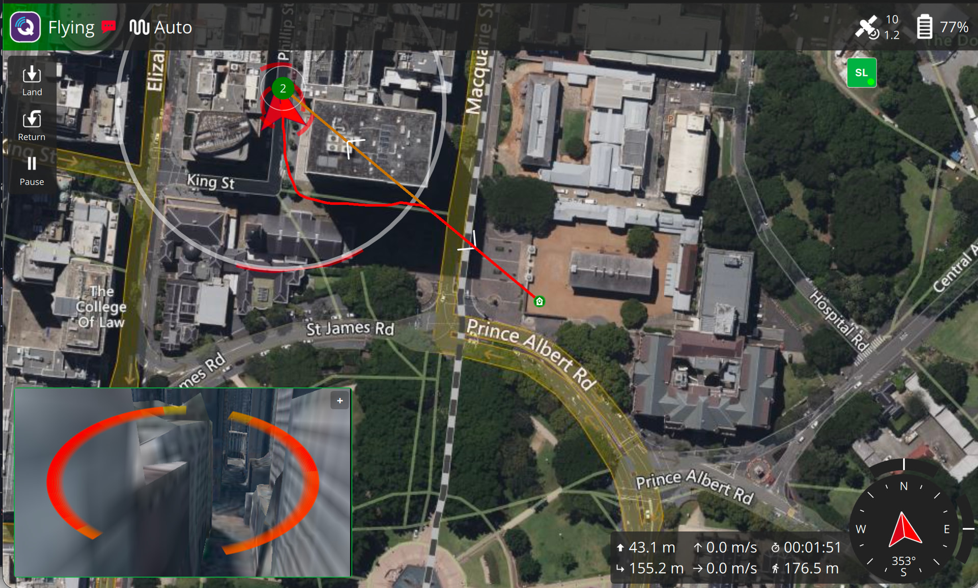

I’m currently working on Bendy in a branch of ArduCopter, and it touches on a few of the issues you’ve raised.
I don’t have anyone’s blessing from ArduPilot at this stage, so I may well be getting ahead of myself here. But the aim is to improve path routing by making it more 3D-aware and by making the re-routing more robust over longer distances.
At this stage, I’m only testing in SITL, not on a real aircraft, so it may or may not help your use case. The work is being designed with 360-degree lidar awareness in mind, and my intent is to get the most out of it before heading down the path of a Companion Computer.
but I have managed to address most of the issues you raised.
Whether it would work with your forward-looking depth sensor, I’d say probably, but I can’t say that with confidence yet.
Whether ArduPilot would ever accept my code into the official fork, I have no idea. Some pics of my progress.
