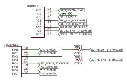

Q1: Does IOMCU and FMU talk to each other by using UART? Because I saw hwdef.dat file of Cube Orange and IOMCU, they definde one port for that.
Q2: If communication between of them fail (IO and FMU cannot transfer data). Can we use RC to control motors?
Q3: I saw some page said that new firmware will load into FMU first, when it finish , iofirmware load to IOMCU, is it that right?
The Pixhawk schematics are available. I think they communicate by PC6&PC7 on FMU and PA2&PA3 on IOMCU:
Being internal signals they should not fail. However perhaps you can find in the source code what happens if communication fails. Main/aux pins can also be studied in the schematics.
