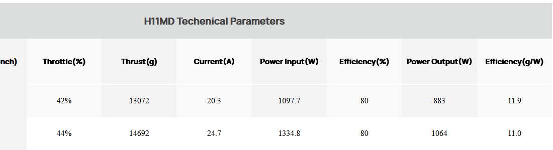

Anyone here using the H11MD of hobbywing?
I am having trouble selecting the battery, the website don’t specify if the Amp consumption is per motor or per axis.
The battery seller say that a 14S, 22ah, 5C battery can do the job for a 10 minute flight but for some reason I don’t believe on those numbers.
Any help will be appreciated.

As I understood the datasheet of the H11MD is a complete unit of an ESC and two motors. All values on the datasheet are for such a complete unit.

Never had a problem with hobbywing datasheet, the data provided always was close to the test bench.
Looks like the data is specified per motor, compare with same prop on X11 Max - its close.

112kg/8motors=14kg/motor, it’s approximate 25a per motor, 200a for whole craft.
If we count from other site - if you get very good performance like 10g/w you still need
112000g/10=11.2kw consumption, leads to:
11.2/8=1.4kw per motor
1400w/54v=25.9a per motor.
So no, 22ah 5c battery is not enough, for 10 minute hover you need
200a*0.16h (1h/6=10m) = 33ah without any reserve capacity, if you add some 20% than you need
40ah 5c (continuous) battery is more real.
22ah should be enough for up to ~65kg AUW

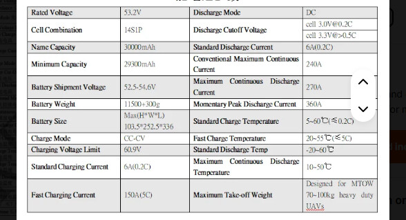

Thanks a lot for your answer. I found this battery and I think this one could do the job.
