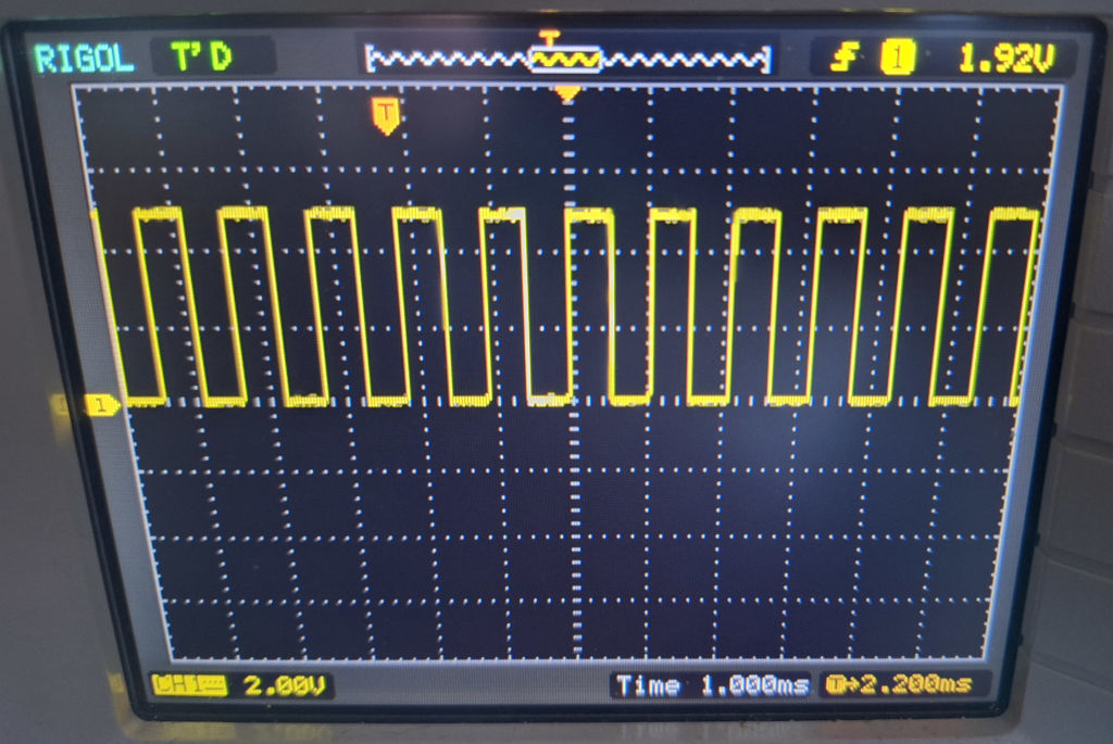

Examine the signal at the FC with an oscilloscope. Perhaps there are glitches which could be filtered with an external RC circuit at the sensor.

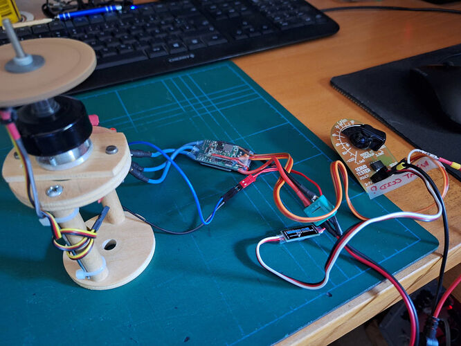

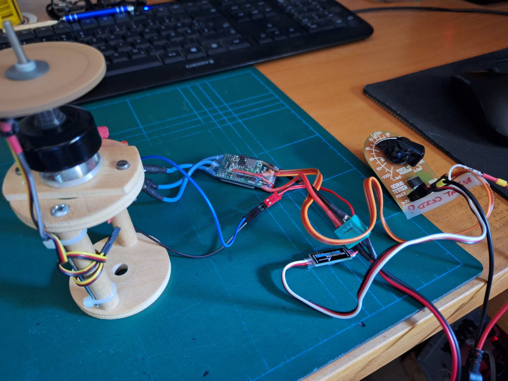

Have one of those HW RPM sensors here and just a short test. BL motor - controller - servo tester.
Signal does not look bad here.
Better add a propeller for increasing current, and test again.
Did you get any good RPM? I did check also with the oscilloscope, but the graf is not the same.
