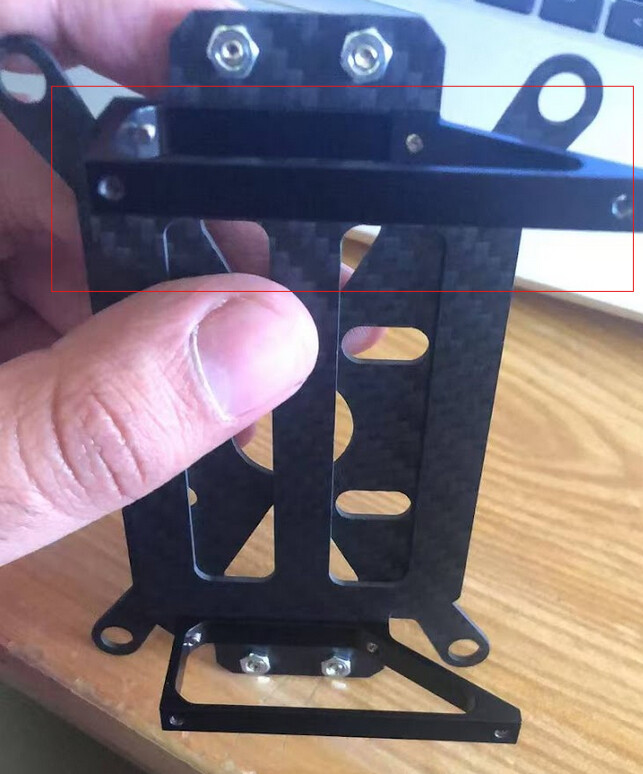

What damping platform you use? It’s damping different axes in different way, maybe it can be improved. Also photos of craft itself and arms mount / folding points can be useful.
HI @RCX749 , I am using a off the shelf frame. It is a monocoque airframe with foldable arms. I will share the pictures below.

For mounting, I’m using the damping platform provided with the frame for the Cube Orange Plus. The airframe is a monocoque design with carbon fibre tube arms.
Airframe / Mounting Pictures

Such kind of mount probably have more rigidity in Y axis because of construction, not clear how dumping is implemented, is there any gums?
The Motors / ESCs came with the airframe. ON asking the OEM, He is saying this is a newer version of ESCs that they have not yet started to sell separately.
Yes this can be the issue. I am currently machining a part that is rigid in both X and Y axis. The Flight controller is attached via gummies yes.
