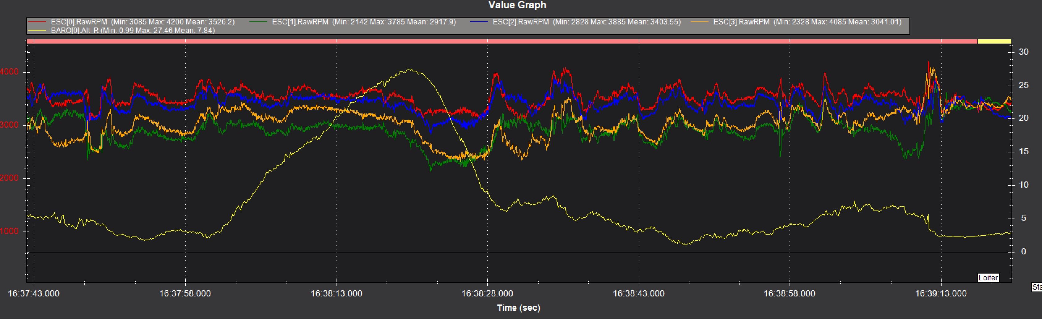

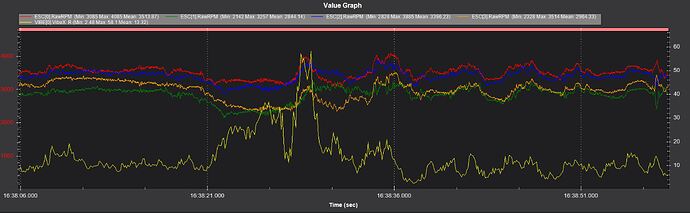

Yes, that makes sense. The large vibe spike in this flight is at the bottom of the decent. There is an RPM increase to stop and level the craft where it’s seen.
Vs Baro
Vs x-vibe
So, as you suggest the frame could be excited by this.
