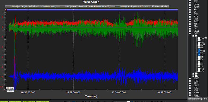

High Vibration & IMU Accel issues on 2330mm Quad (X13, 18S) during Minimalistic Mandatory Tuning
Hi everyone,
I am currently building and tuning a heavy-lift agricultural quadcopter and would appreciate some professional insight regarding vibration management.
Hardware Configuration:
  • Frame: 2330mm Wheelbase, Aluminum Alloy Airframe
  • Powertrain: Hobbywing X13 System (18S LiPo)
  • Flight Controller: Cube Orange running ArduCopter v4.6.3
  • GPS/Compass: Here 4
  • Software/Methodology: AMC (ArduPilot Methodic Configurator) using the “Hoverit X13” template, following the ArduPilot Copter documentation.
The Issue: I am currently at the “8. Minimalistic Mandatory Tuning” stage. My logs show exceptionally high Vibe levels, and the IMU Accel values are borderline (near the upper safety limits). This is concerning for a 50L class drone.
Current Testing: I have experimented with several damping materials. So far, the best results come from 3M Brand Tape and 3M 9448A, but the levels are still not ideal.
My Questions:
  1. Should I prioritize further mechanical vibration isolation until IMU Accel values are well within the green zone before moving forward?
  2. Or is it advisable to proceed with Notch Filter configuration and AutoTune to see if software-side filtering can stabilize the system?
  3. Given the aluminum frame and the massive X13 motors, are there specific mechanical dampening strategies or mounting techniques recommended for this scale of aircraft?
Please see the attached AMC zip and latest flight log for more details. Any advice would be greatly appreciated!
Attached are my AMC configuration (.zip) and the latest flight log (.bin) for your review.

Those vibrations are not ideal but not too problematic. Maybe show some pictures of the frame, because apart from loose wiring vibrating around all over the place, the next biggest problem is frame stiffness. Especially with bigger copters.
I believe the number of poles need to be changed to 21
KDE_NPOLE,21
unless there’s settings in the datalink that you can change.
Then this will be the correct settings for the harmonic notch filter:
Do not be tempted to select unnecessary harmonics or settings.
The nr of poles should be added to the esc step.
The notch settings to file 19.

Hi everyone,
Thanks for the continuous feedback. I’ve updated my mechanical isolation setup and have some new observations to share.
Current Setup:
I am now using a 3-layer damping platform (similar in design to the one by GuyMcCaldin).
Observations from the latest test:
  • VIBE Levels: Successfully dropped below 30.
  • IMU Accel: Interestingly, the Accel values have increased to ±10, which is concerning for a heavy-lift frame.
Analysis & Next Steps:
I suspect the Cube Orange is too light for the stiffness of this specific damping platform, causing the flight controller to oscillate at a lower frequency (effectively acting like a spring-mass system with insufficient mass).
To address this, I plan to add ballast/weight to the flight controller mount today to increase its inertia, hoping to dampen these low-frequency oscillations and bring the IMU Accel values back within a safe range.
I would greatly appreciate any advice on the ideal weight-to-damping ratio for a 50L class drone, or if there are specific parameters I should monitor in the logs during this ballast test.
I will upload the new logs once the test is complete. Thanks again!

I think it’s preferable to return to using 1st IMU as primary, vibration levels does not differ a lot across 1st and 3rd accelerometer and are acceptable.
The problem is with gyro signal, it’s very strong at X axis, you need to find the source of this noise first, you did not have it before.
Here is how it RAW gyro signal looks like, it’s big mess.
I’m looking on this log file
