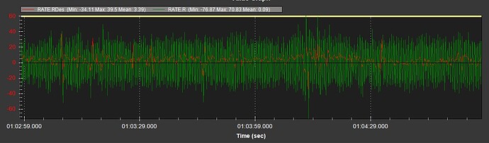

High-frequency vibration during hovering and trembles when descending
The UAV experiences high-frequency vibration during hovering and trembles when descending.

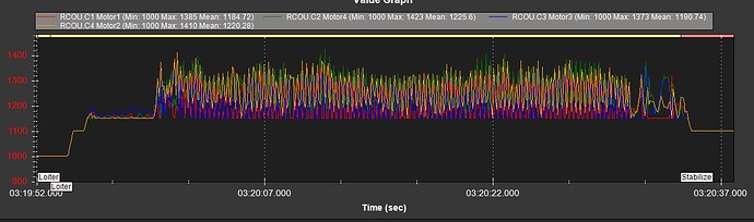

The outputs are oscillating badly from default PID’s, default motor ranges and incorrect vertical acceleration controller gains. Looks like this:

First of all, thank you for your solution. Below are the unsuccessful attempts I have made:
  1. No sponge covering was used. (The temperature was around minus 7°C during the test; I have added the sponge today and will conduct another test shortly.)
  2. The notch filter/throttle filter was enabled, but it did not improve the situation.

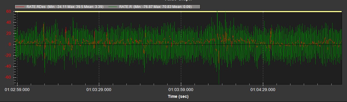

  3. Reducing Roll.D from 0.0036 to 0.0025 also failed to work. (AI analysis indicated an abnormal Rate.R.)

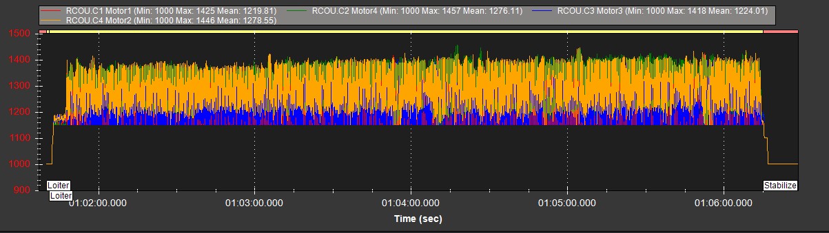

After reducing the P and I values of the throttle acceleration, the descending vibration disappeared. The high-frequency jitter during hovering still persists, and it is now suspected that the battery strap is interfering with the IMU.
Changing the position of the straps did not work.
Post a link to the flight log. And viewing IMU Gyro output is not useful.
Rate PID’s are still at default, the Motor Ranges are still at default and the Vertical Acceleration Controller gains are too high. As a result the output oscillation is terrible.
Only improvement I see is the barometer is not effected by propwash any longer.
