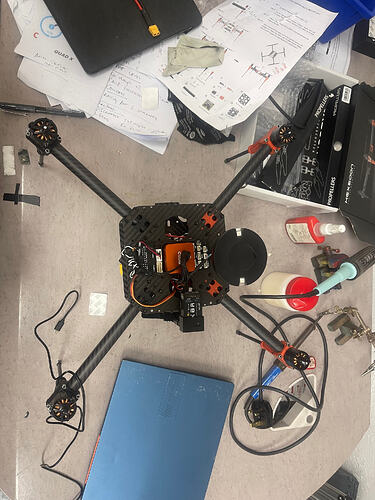

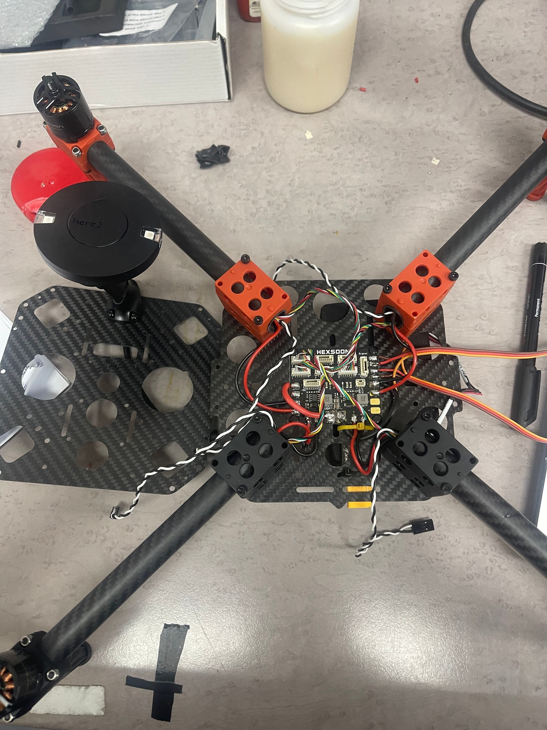

Meaning they are not in front of you? Post a photo of them and how they are connected to the Flight Controller if they are.
Very Basic Escs That are now hidden in the arms im afraid
Hard to see in the photo but I suppose you have the ESC + signal leads on the bottom row of pins?

Yes, I do have ESC signal leads on the bottom and they’re all plugged into the Pix Hawk in the correct holes. I cannot calibrate the ESC therefore I cannot do a motor test in mission planner. It says that it can be armed that I’ve not successfully managed to arm it and run the motors.

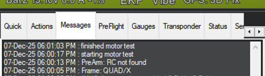

You don’t need to calibrate them for them to run in Mission Planner Motor test. It auto arms when that is run. If they don’t run in Motor Test Therefore you cannot perform ESC Calibration…
You should see this in the messages screen. If you read the procedure in the link you know what to try if they don’t spin. If they don’t spin at all then you likely have a wiring problem somewhere.
OK, I have tried to complete a motor test but I get the message “Command denied by auto pilot” I have tried 2 methods of ESC Calibration, but all escs are just constantly beeping when I plug in the main power..!!
“Command denied by auto pilot” means that there are missing configuration steps that you skipped.
Use something like the ArduPilot methodic configurator software to make sure you do all the required steps. Using AMC when you reach step 15 (motor test) ArduPilot will allow you to perform it. And that without disabling any arming checks.
Set BRD_SAFETY_DEFLT,0 restart the controller and try again. This disables the safety switch. Meaning, try Motor Test again.
FantAstic, Armed and Motors Spinning ___ No Bleeping Thankyou so much now motor test
