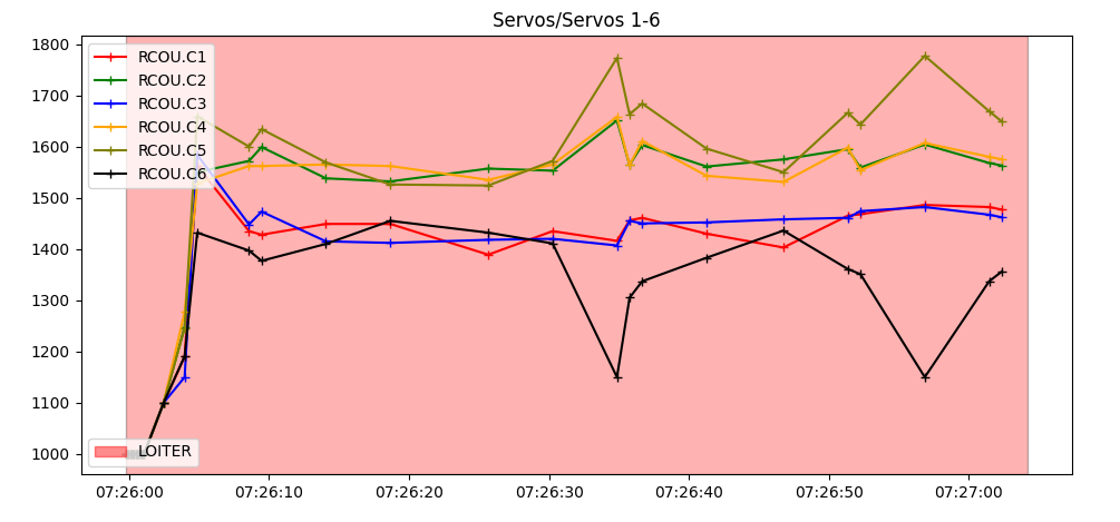

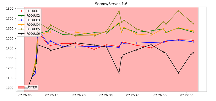

I run the Ardupilot Methodic Configurator, run the Quick Tune Script. When I Yaw to the right, the moviment is pretty aggresive in the beginning, then normalize, to the left the aggressiveness is even high, but in some moment, the moviment to the left, if I demand the copter is not doing nothing - I demand more yaw and the copter does nothing.

There’s likely a frame mis-alignment or twisted arm. There’s a big torque split between the CW and CCW motors. You’ll need to make sure all the props are level with each other and try again. Make sure the prop tips are all in line. It’s really touchy. Doesn’t take a lot to be out of place.

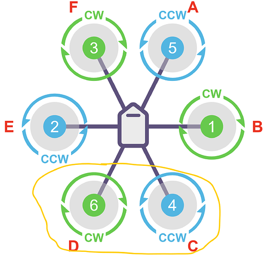

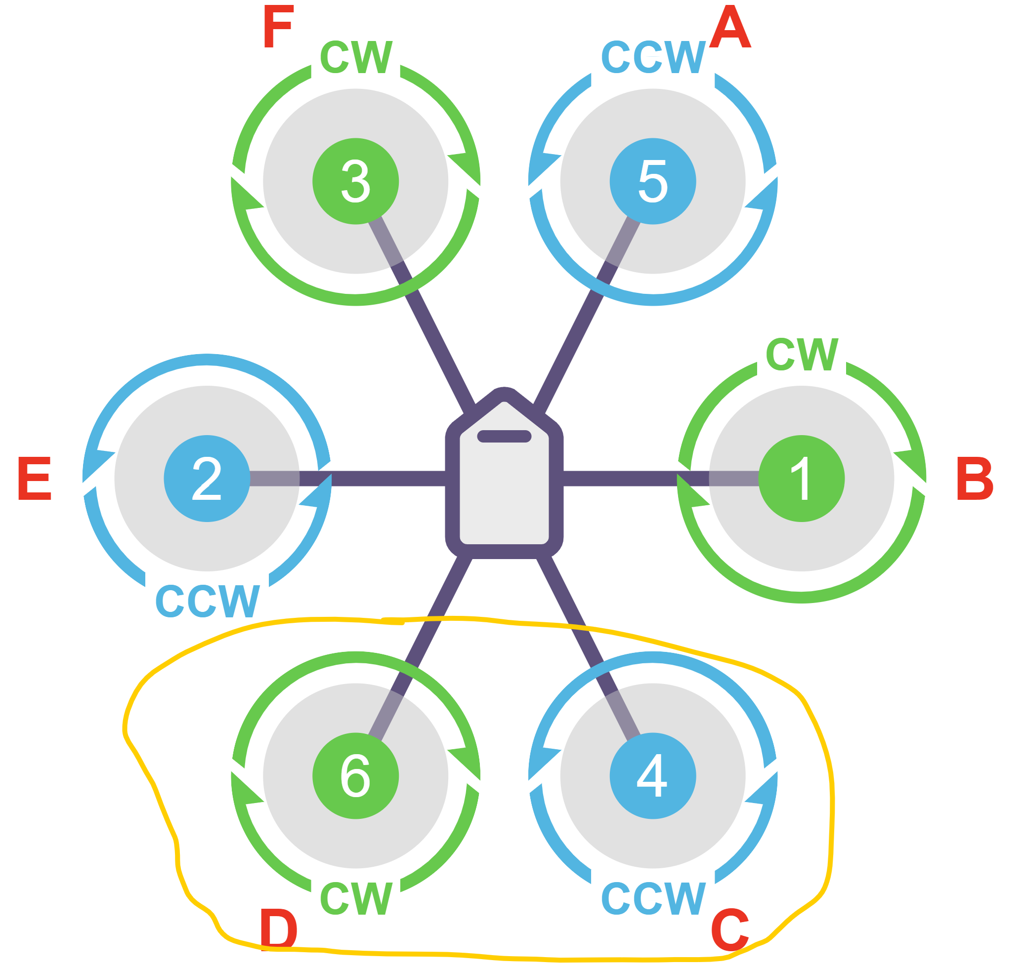

Any other clue ? I have one question, all the esc’s are Tmotor F45, but 2 are of a another series - the led is different and the blheli32 is different but same version. There is any problem using different ESC ? (they are the 6 and 4 - D and C).
Yes, using different ESC is a very bad idea.
This was the first try I made using 2 kind of escs - I didn’t realize they are different - I checked and alignment/level of the motors and they are aligned so I will change the esc’s.
