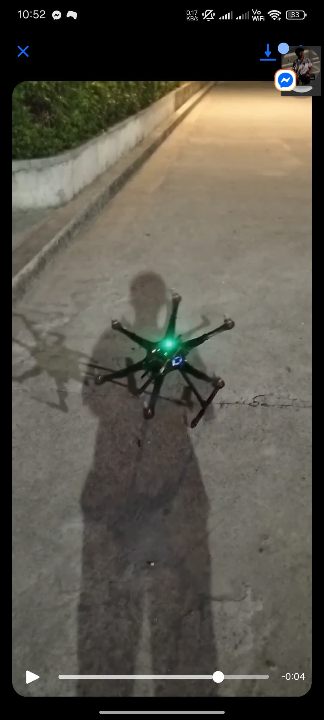

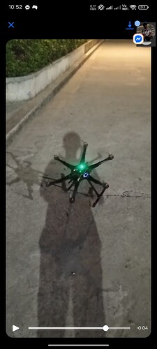

hello i successfully flew the drone one time but the problem came back again ill attach what it looks like when I throttle up
it tips to the side, this is after i replaced a motor
all escs are calibrated
An image of a video? I guess you are ignoring the suggestion to use the Methodic Configurator.
