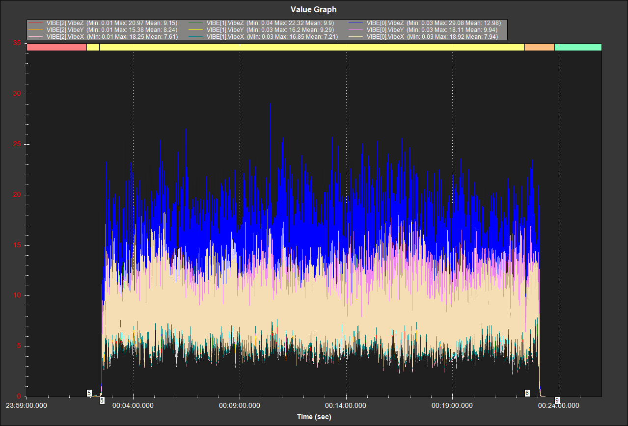

I need some help analyzing flight logs to better understand how my copter is performing.
I am currently working on a heavy-lift drone with a 10 kg payload, and I would really appreciate your guidance and feedback. I have attached the flight log below for reference.
Could you please review the log and share your valuable feedback, particularly regarding:
  • Overall flight performance
  • Stability under heavy payload
  • Any anomalies or warnings observed in the log
  • Suggestions for parameter tuning and improvements
Your insights and recommendations for optimization would be extremely helpful.
Problems Observed:
  1. Sudden yawing of the drone during flight.
  2. Voltage sag of approximately 5 volts at an MTOW of around 29 kg.
  3. Barometer accuracy issues:
    I can visually observe the drone oscillating in Loiter mode during the first 1 minute after takeoff. After some time, it stabilizes and holds altitude properly.
    The same behavior is observed in AltHold mode, but it self-corrects after a short duration.
  4. According to Logs i have obserevd vibration affecting the IMUs as well (according to logs)
Logs are present on the Drive

The noise is high, and the harmonic notch filter is not enabled.
The z-axis vibration is a bit high.
You can directly open the link and download the log
I am using a 24 inch propeller
With the parameters remaining the same as listed above, how can I reduce Z-axis vibrations when the flight controller is mounted flat on the mounting plate? The controller has approximately a 3 mm overhang at the front and rear, which corresponds to the X-axis. I have been tuning the system, and it initially exhibited significant altitude oscillations, which I was able to reduce it just yawing now.

It may be related to bad magnetometer calibration and using both, including FC internal.
Probably because to wrong vertical controller tune, review PSC_ACCZ_P / I as manual and configurator suggests.
You will need some dynamic notch.

Here is an article from a flight controller manufacturer to help their users identify the possible source of vibrations.
Contact the manufacturer for such an old Custom version of firmware. Perhaps suggest to them to get up to date.
