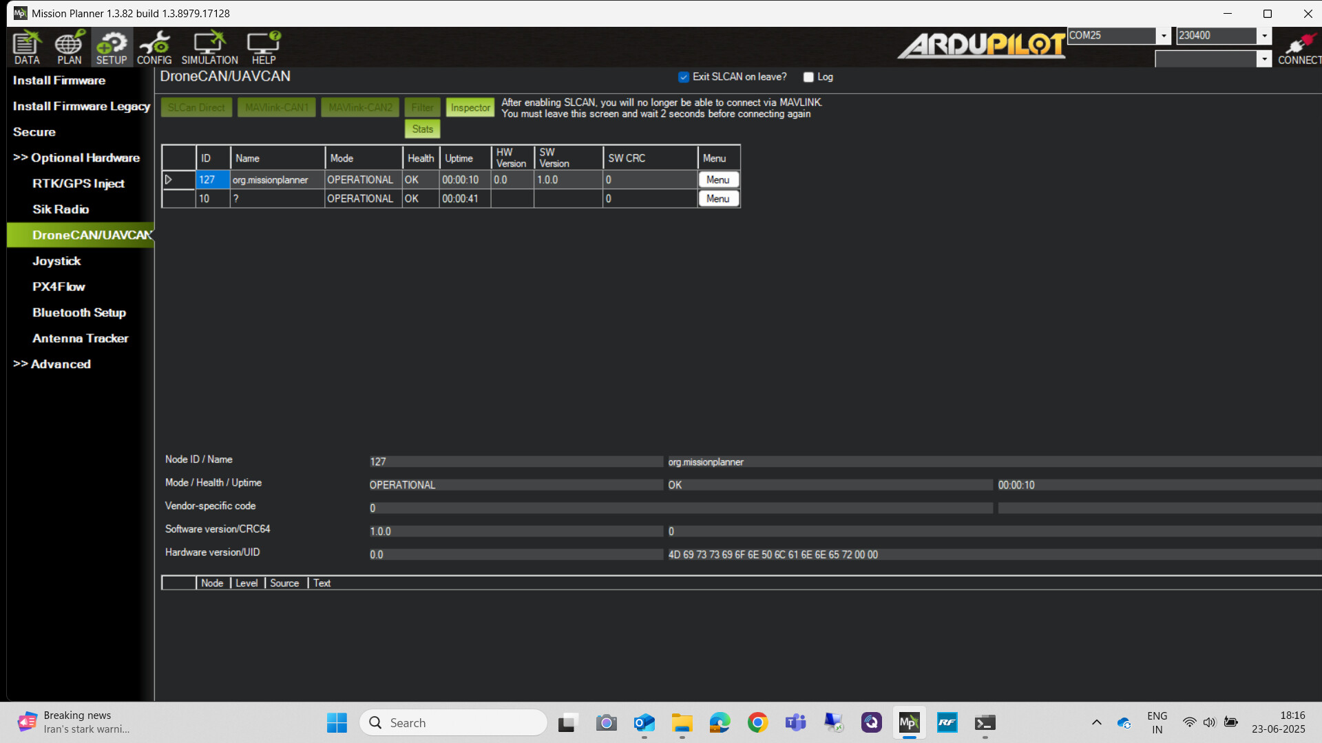

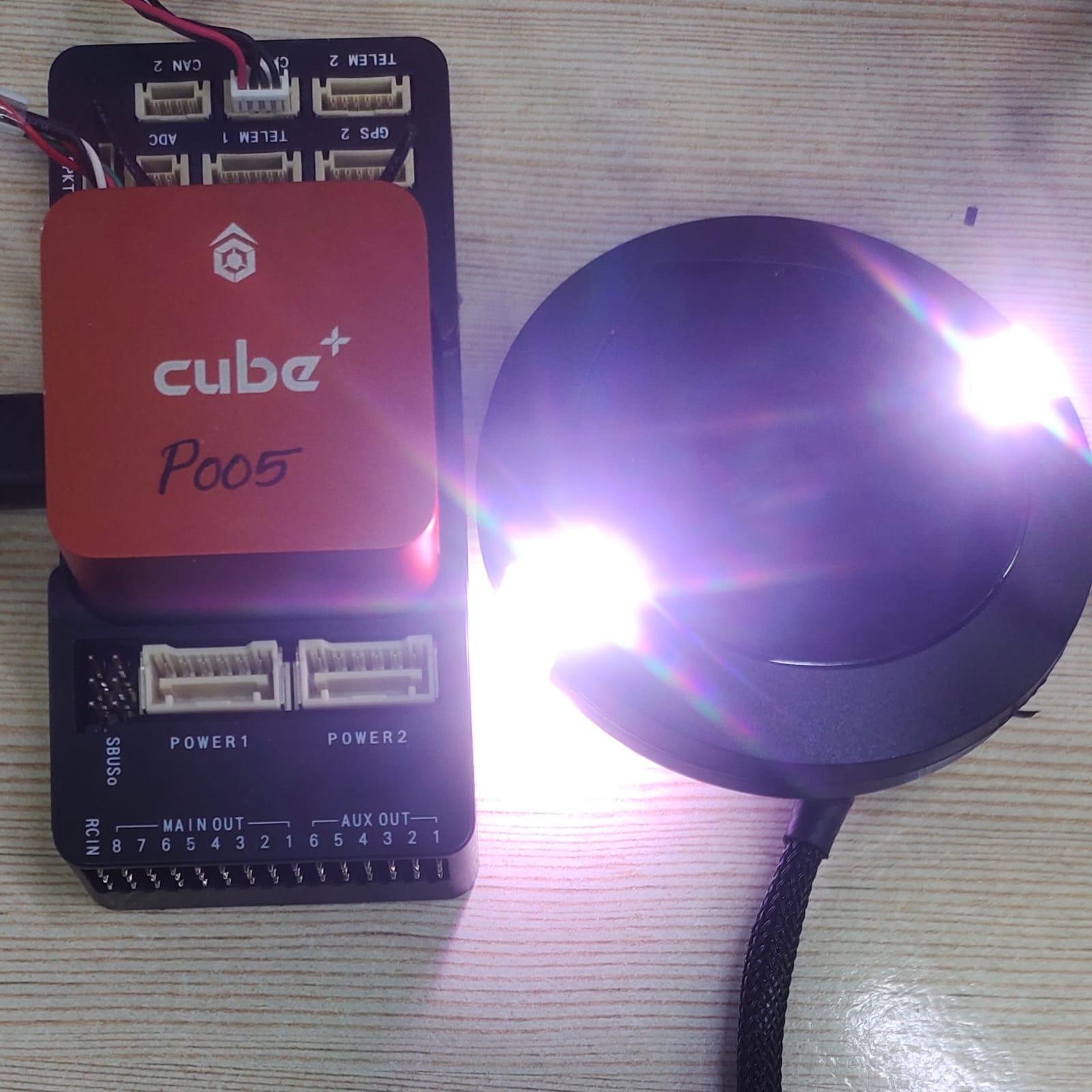

Hello Experts,
I am facing a issue where my Here 4 GPS is stuck at white light randomly after some flights (happened on 7 new GPS out of 100),
Configuration:-
I am using PX4 (1.15.2) autopilot running on Cube orange+, with Here4 GPS
Once the solid white light appear, the GPS is not detecting by the PX4. I also uploaded Ardupilot but the problem remains the same.
I also tried to update the firmware on the Here4 GPS using ardupilot and mission planner [https://docs.cubepilot.org/user-guides/here-4/here-4-manual#id-3.-firmware-update](https://official website)
but a ? appears in the name column, No HW version, No SW version,
I am not able to communicate with the GPS through Drone CAN GUI tool, nor by U blox U centre tool,
I am attaching a log file and videos for reference June_12_HERE4_Issue
Please help me to solve the issue.
Thank You

I believe the issue has been found, and something should be published soon.
There’s been two issues I think:
  1. broken track affecting the compass
  2. bootloader issue giving white LEDs - may require a JTAG programmer to update the bootloader so there will probably be a returns process.
This is just going by what I’ve read over at Cube Pilot.
Thanks for the update! Where can I specifically watch for further details?
UPDATE
  • Make sure the Here4 is connected to the CAN1 bus by the blue/white wires
  • Be sure to do the bootloader update procedure.
  • The SW version after update is: 1.15.5F1FC167
The Here4 I updated was not already bricked or faulty, but the update process did work.

do we have to update the bootloader for sure i have here4 unit paired with cube orange plus should i have to update it or wait.
Yes you definitely have to update the Here4 bootloader - read the original instructions carefully and you’ll see that it’s very easy to do.
