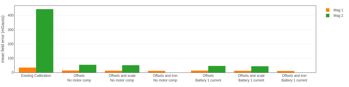

I installed another li-ion battery and thought maybe I needed to redo the Magfit calculation. I thought I would start by doing the same calculation you did for me two months ago and this way verify that I am doing it right. I took the same file: https://www.dropbox.com/scl/fi/bu99jwb8n7yj1qx63xreh/00000149.BIN?rlkey=8jk887677daok8x7ohd7kofwj&st=yk22xynh&dl=0 and used ArduPilot MAGFit in flight compass calibration but I am getting completely different values ​​than the ones I got from you. I am doing something wrong!.
My values ​​become

Open the web MagFit tool
ArduPilot MAGFit
  • Load the .bin log file.
  • Use the sliders at the ends of the Time scale to trim out unused portions of the flight.
  • Deselect all but Existing in the Calibrations section.
  • The Field X Y and Z graphs below will show who good the compasses are now, before you make any changes. The black line is where you want your orange and green lines to be.
You’ll notice the orange line, your active compass, is actually extremely good!
  • Scroll all the way down to the bar graphs and see which give the lowest valid bars
In your case, the “Offsets and scale - Battery 1 current”
  • Scroll back up to the calibrations section and select the appropriate option, and deselect Existing
  • If all looks OK, following the black “Expected” line, scroll all the way to the bottom and click “Save”
    Your web browser will download a .param file that you can apply to the copter via Full Parameters / Load from file
Unfortunately you internal compass is not going to get much better so probably best to leave it disabled, but the external one is great.
If you ever do a normal compass calibration it overwrites all this good work, so you dont have to do a normal compass cal unless you make significant change.
