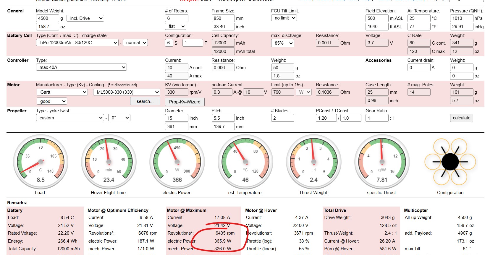

Hey Folks,
As many of you recommend, I used a paid Ecalc to order the parts for my new drone.
Unfortunately the motors do not spin fast enough to take off.
Stupid ECalc!!
Any advice on new motors.
6S, 15", 4500 gr weight.
See pics. =(
The Motors I have can do 8S batteries, but seems to me new motors might be cheaper than new batteries and ESCs?
Thanks!

330kv motors should be fine with 15inch props and 6S.
What ESCs do you have?
Provide a .bin log of an attempted take off.
EDIT: throwing some numbers into ecalc I get a similar result to your screenshot, so that’s at least consistent.

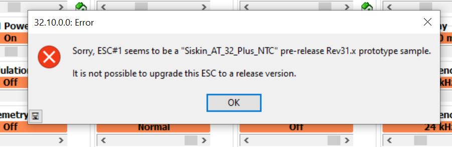

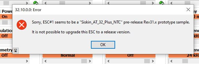

Never could get passthrough to work, so I checked the ESCs using a separate betaflight FC.
Apparently have some of the new “prototype” ECSs that can’t be programmed.
As per this vid: PSA on prototype ECSs Mine show up the same.
Thinking of sending them back.
Anyway, all the settings were okay on them except: Low RPM Power protect, that’s “on” and can’t be changed.

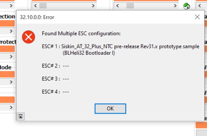

I’ll try, but they say “blheli32” right one them and did connect to the software, just yelled these errors:
That is AM32 firmware using a BlHeli boot loader. You need to use the AM32 configurator.
Then I think you were right when stating you cannot disable the feature causing the issue. At least by the product description “no configuration changes can be made”.
And this comment “ However, stock ESC settings work great for almost all applications”. Almost all application with motor kV>1200 maybe…,
Worth s try with the AM32 configurator anyway but I guess you are stuck.
