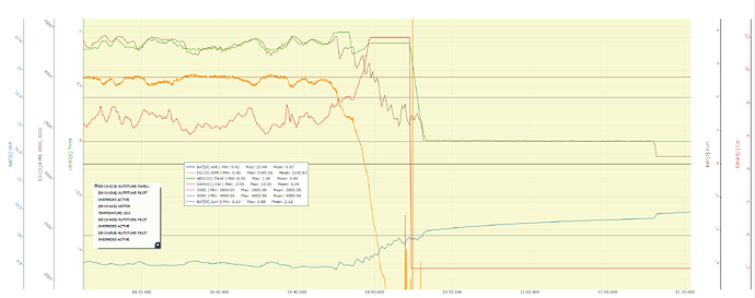

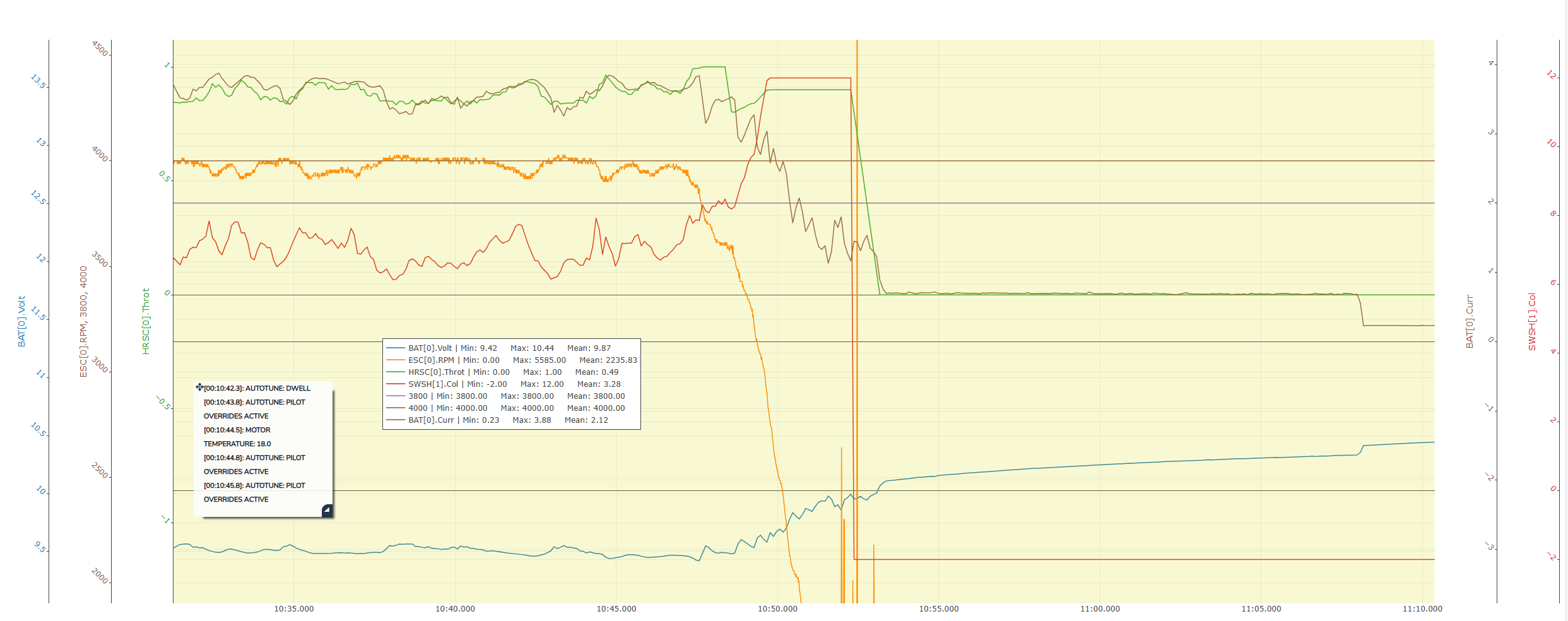

What’s the rpm drop you experienced? What’s the rpm range set at?
A log of this occurrence would be helpful.
I have set ­±200RPM range though the in practice the controller keeps it ±30RPM, (telemetry resolution is ~14RPM).
The RPM drop was caused by governor output saturation (throttle=1), that itself was probably caused by some ESC configuration change during avionics tidying (swapping ESC configs is PITA with AM32).
The RPM situation looks to be stabilizing just before the governor quits at ~10:49.

Do I see it correctly, it seems RPM went down (orange line)?
If my assumption is correct then it seems the governor did it’s job correctly until conditions for quitting were met.
Expensive dampers :sweat_smile:
Yes.
Yes. That’s the point I argue about, IMHO the condition is wrong. If the governor is doing its best (outputting full throttle) we shouldn’t drop it for the throttle curve, which most likely has lower values.

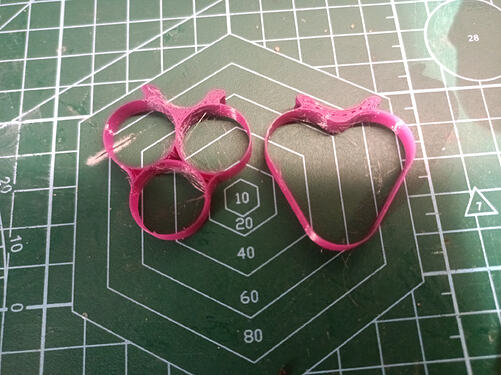

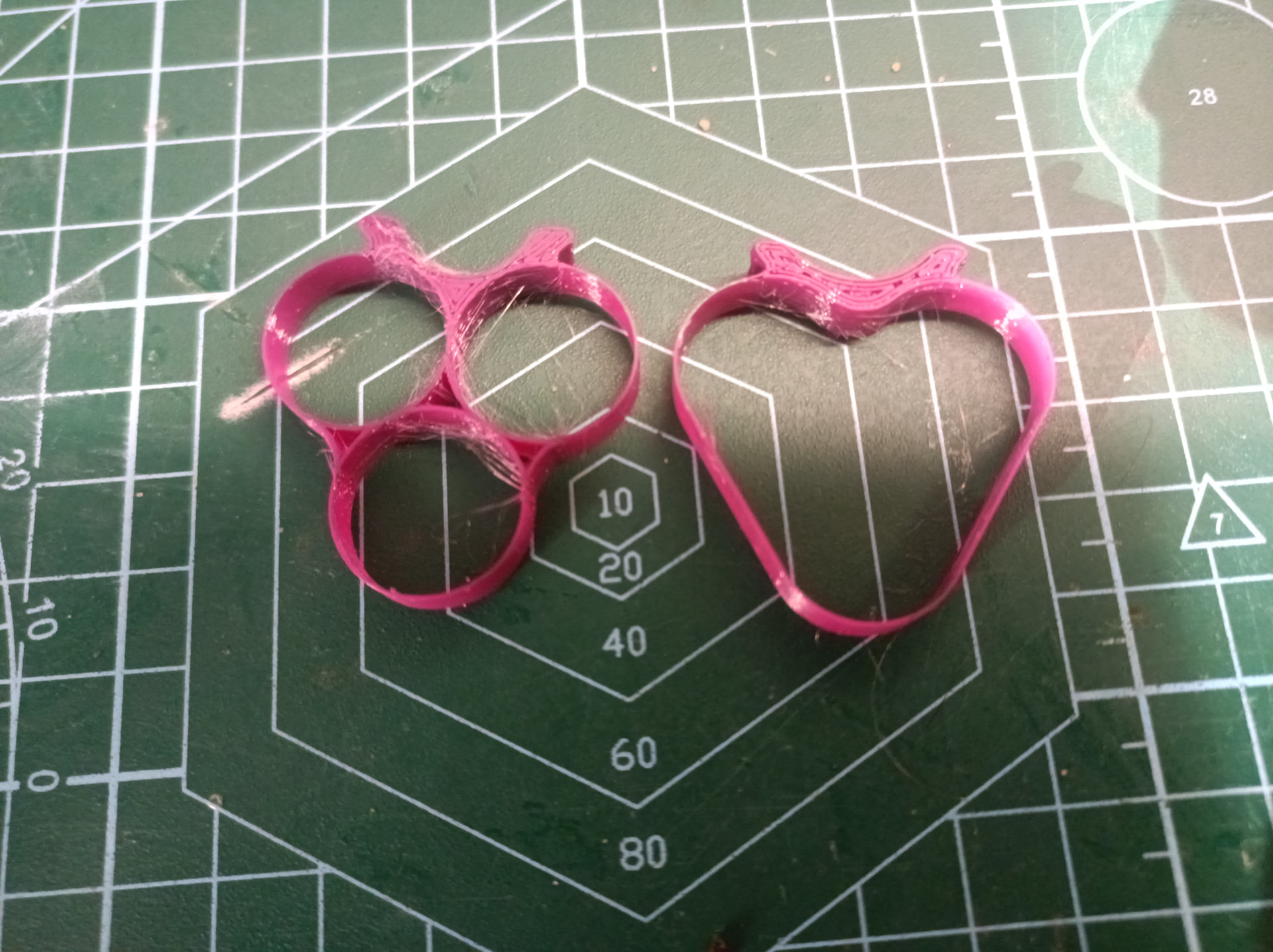

Not really, 2 3d printed loops with dovetail attachments,.the first version was PITA to replace as it had internal spacer integrated.
New version of the battery will have endcaps that don’t stick over the edges of the cells as it is a bit too hard pull the loop over them.
