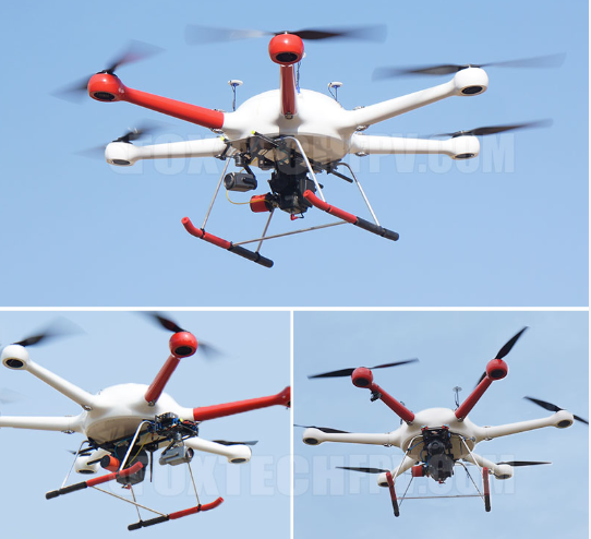

We were testing a Hexacopter with propeller size 29 inch (2995), drone wheelbase 1600mm and takeoff weight of 20kg (GAIA 160). We are using T-Motor U8lite 85KV motor with 60amps flame ESCs
We are using cube orange+ flight controller with here3 GPS. We tested it in altitude hold mode and confirmed that the vibrations were under control, and did some manual PID tuning. We have also done the harmonic notch filter set up.

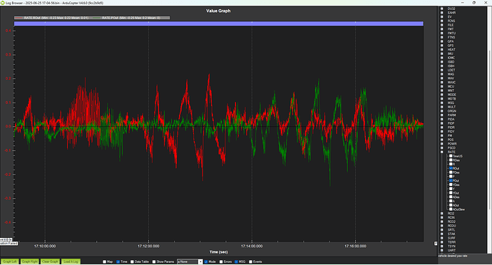

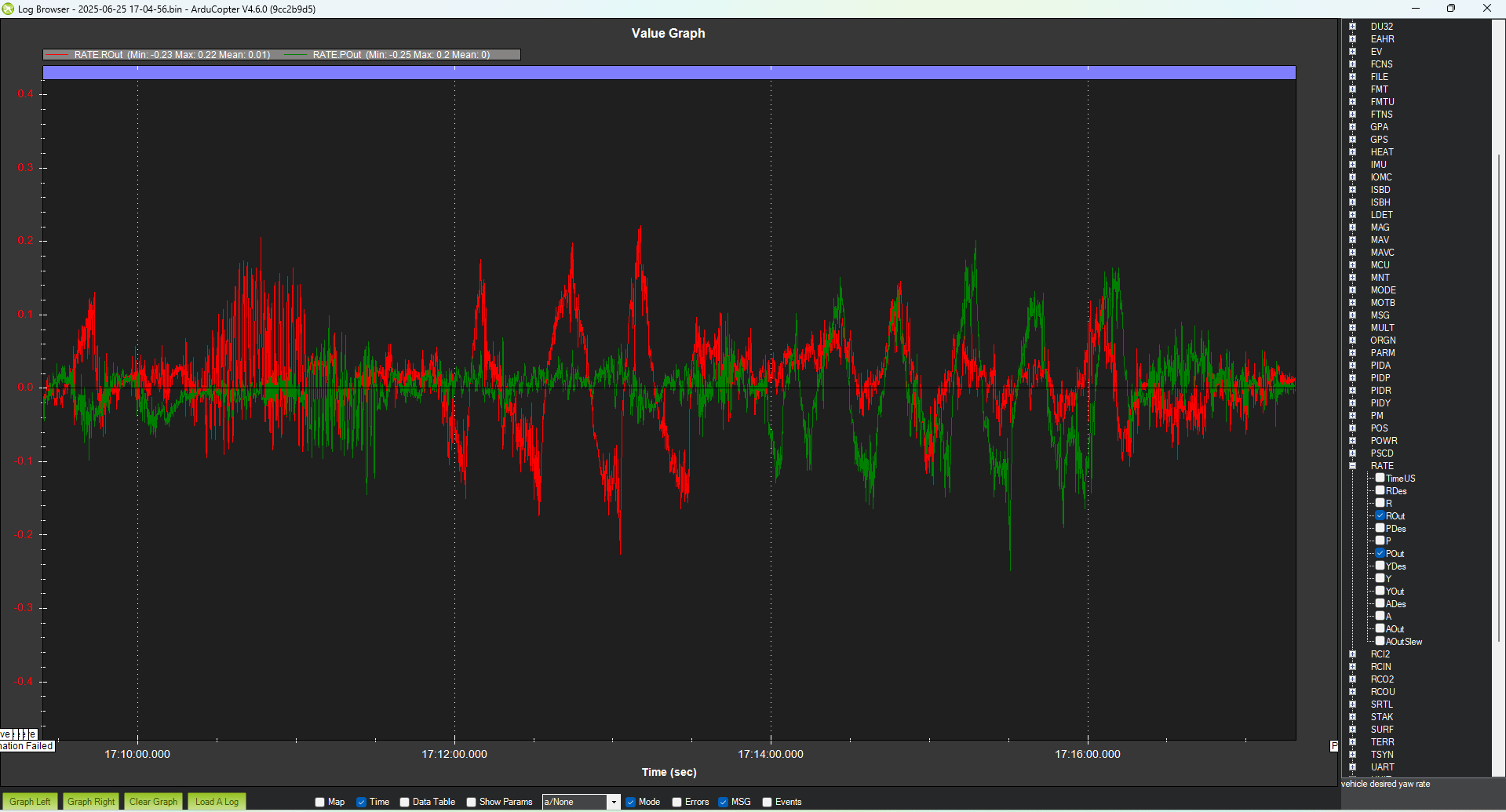

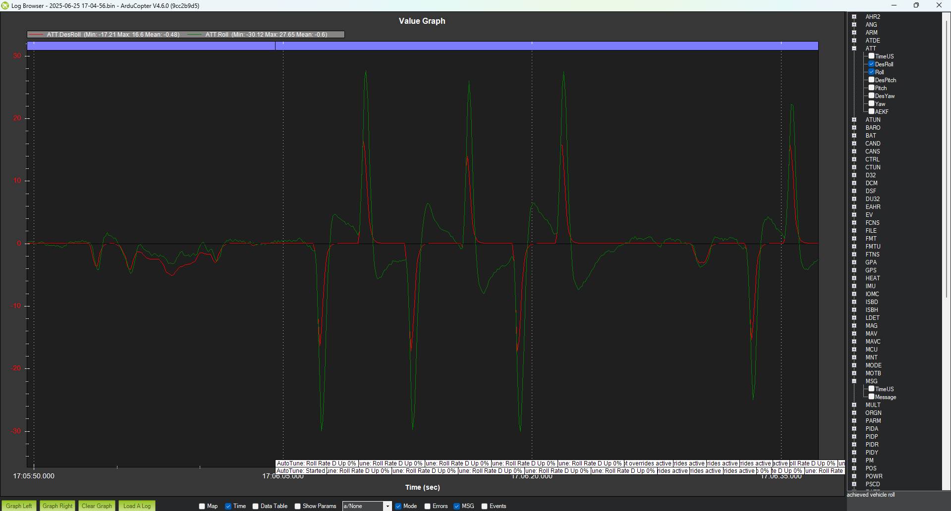

While attempting AUTOTUNE, the drone did some twitching around the roll axis aggressively(first we were trying to do it in roll axis) and after some time auto tune failed with message (AUTOTUNE: Twitch Size Determination Failed).
We did some search online and found suggestions that our ‘AUTOTUNE_MIN_D’ was too low and ATC_RAT_RLL_P was too high. We implemented the suggestions but nothing changed and the autotune failed again.
Our test logs are attached here.

I doubt that for a craft that size. I would reset the Rate PID’s back to default, set the vertical acceleration gains correctly based on hover thrust and then assuming there is no output oscillation run Quicktune before trying AutoTune.
Or reset to default and use The Methodic Configurator.
Thanks Dave for the your suggestions. Indeed your suggestions worked well, after Quicktune the autotune is working fine now. Will do the whole process and update the results soon.
