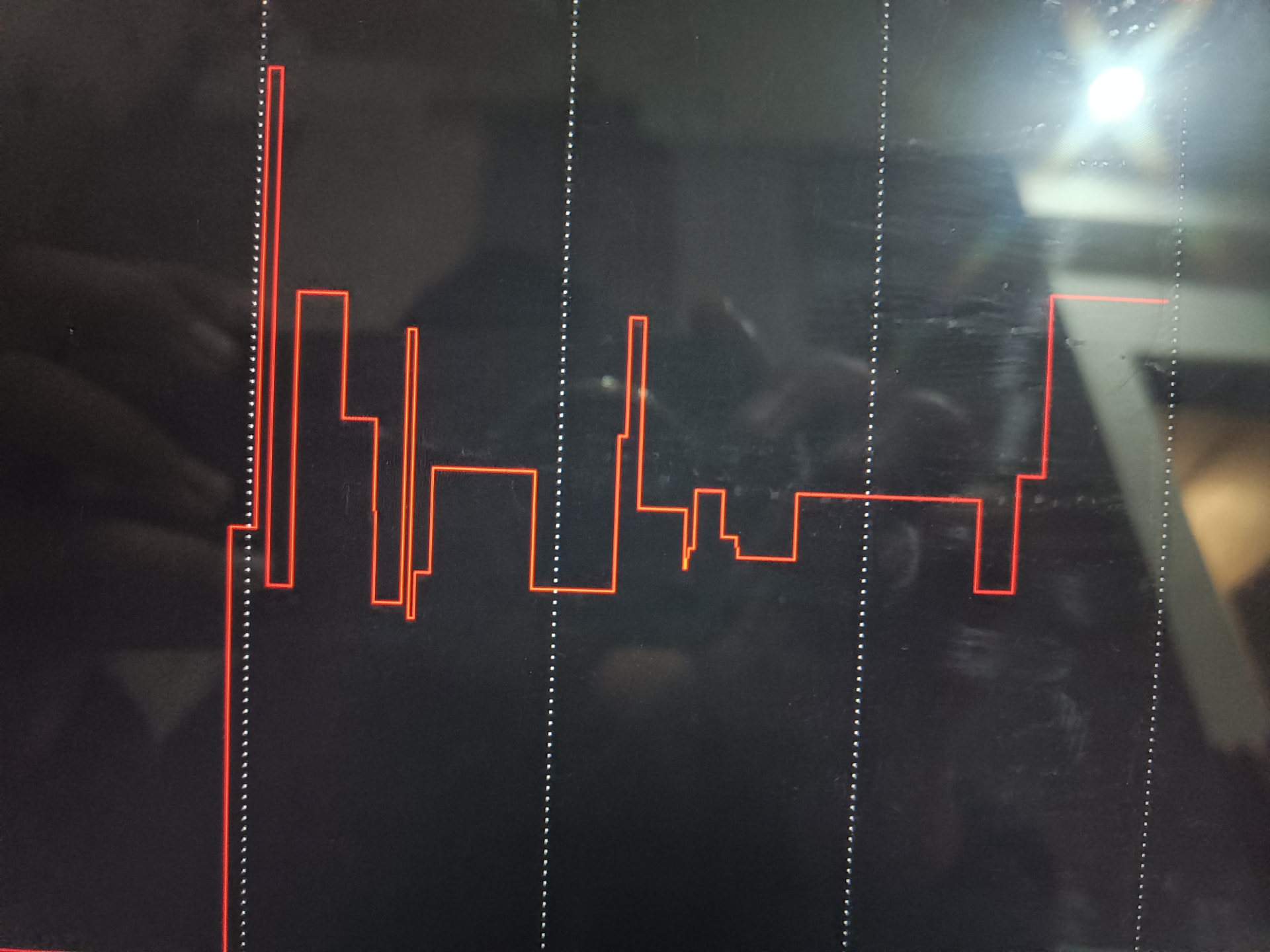

Now weirdly, it reads correctly on start and then reading stays stuck there until I reboot and then the new reading comes and stays there stuck what to do??
In a test flight it seems to be working weirdly:

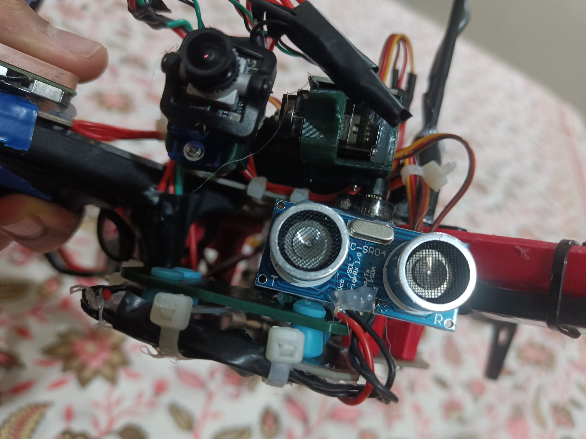

Here is the mounting
the soldering is also good.
