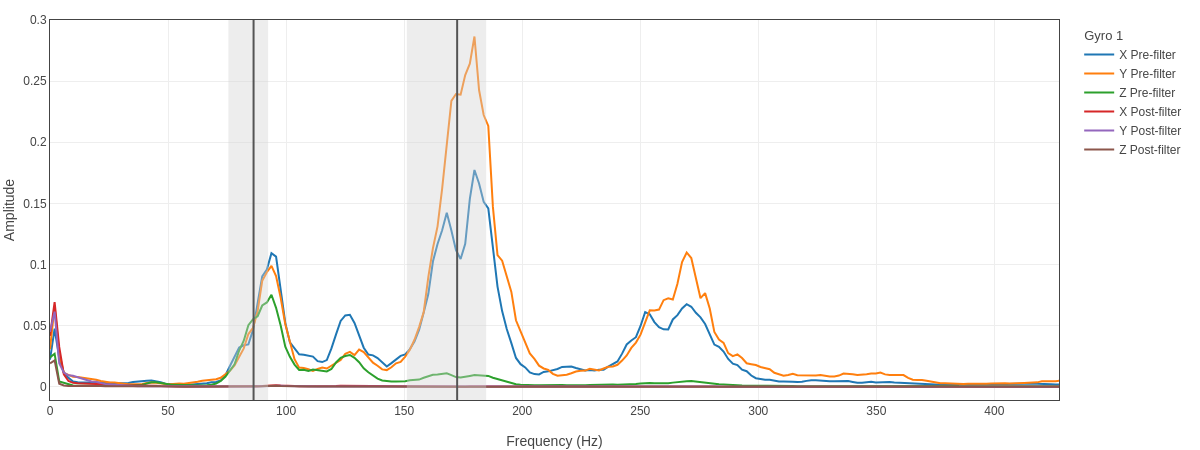

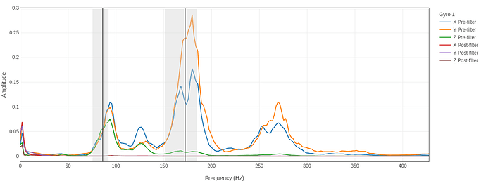

The harmonic notch filter wont reduce your vibrations, it’s job is to prevent those vibrations from affecting the control loops as much. So you wont see any difference in vibrations by changing filter settings.
You need to set INS_LOG_BAT_MASK,1 to log the pre-filter and post-filter noise (it seems you had already done all that measurement) - that’s what matters after you’ve done everything you can to reduce physical vibrations. You appear to have the other notch filter settings OK and it should be working with the ESC RPM.
If you are happy with it you can set INS_LOG_BAT_OPT,0 along with INS_LOG_BAT_MASK,0.

Cable-tying all the cables together can sometimes be part of the problem. They need flexibility where they go from being fixed to the frame to connecting to the flight controller, so they are not transferring vibrations or pulling on the FC.
EDIT:
Good news is the harmonic notch filter is working as planned:
