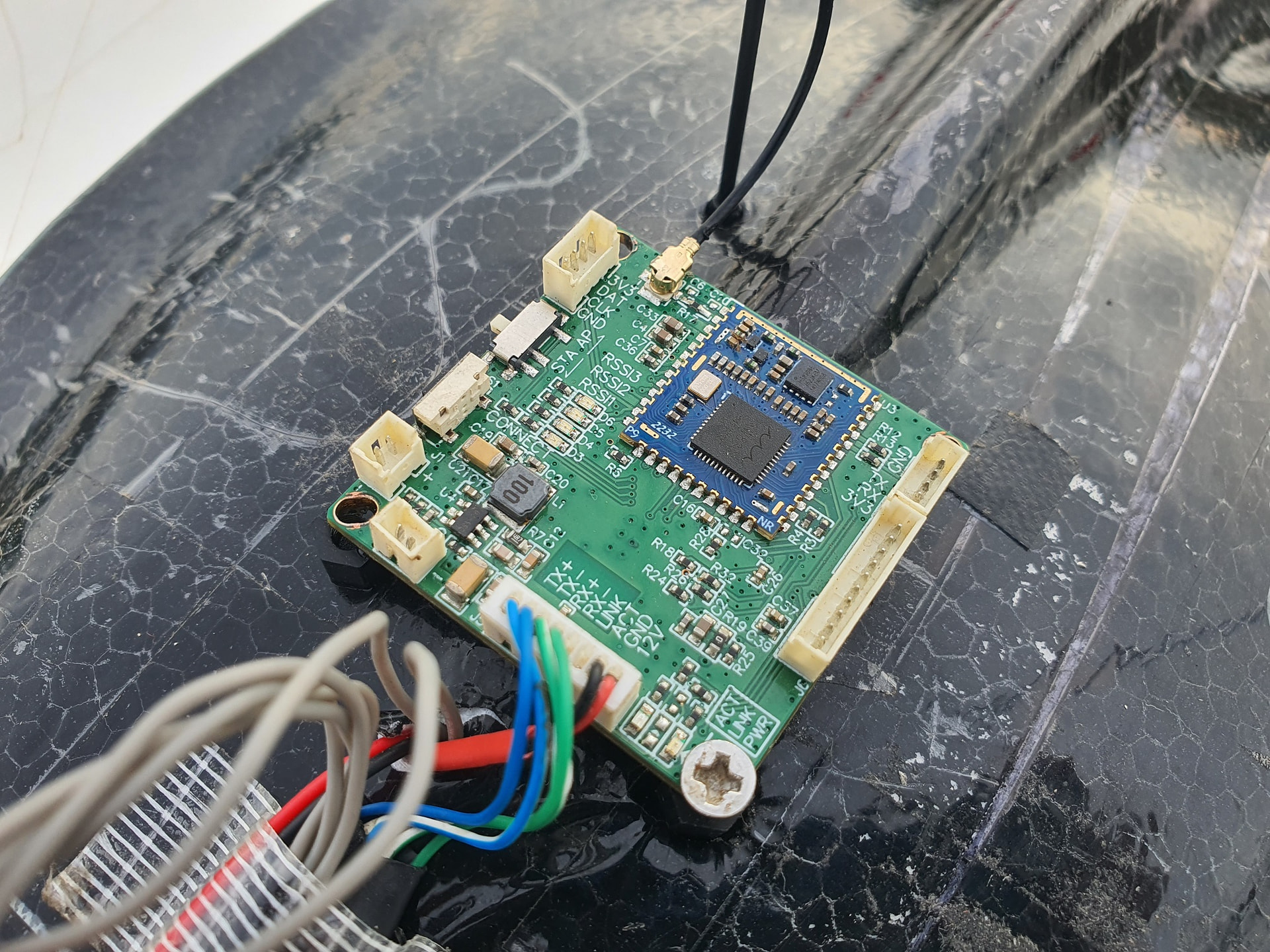

Enter HaLow WiFi devices that plug into any existing LAN and act as transparent bridges. HaLow devices operate using IEEE 802.11ah on 915 MHz in the US and on 868 MHz in the EU. Fair warning - EU-compliant devices tend to be significantly less performant due to regulatory restrictions. I tested only the 915 MHz US version.
The sub-GHz frequency band and direct link between HaLow devices allow for long range (~500m over the ground), moderate bandwidth (up to ~20 Mbps) connections, tolerant of some obstruction. Max range can be increased significantly in ideal, direct LOS conditions (ground-to-air).

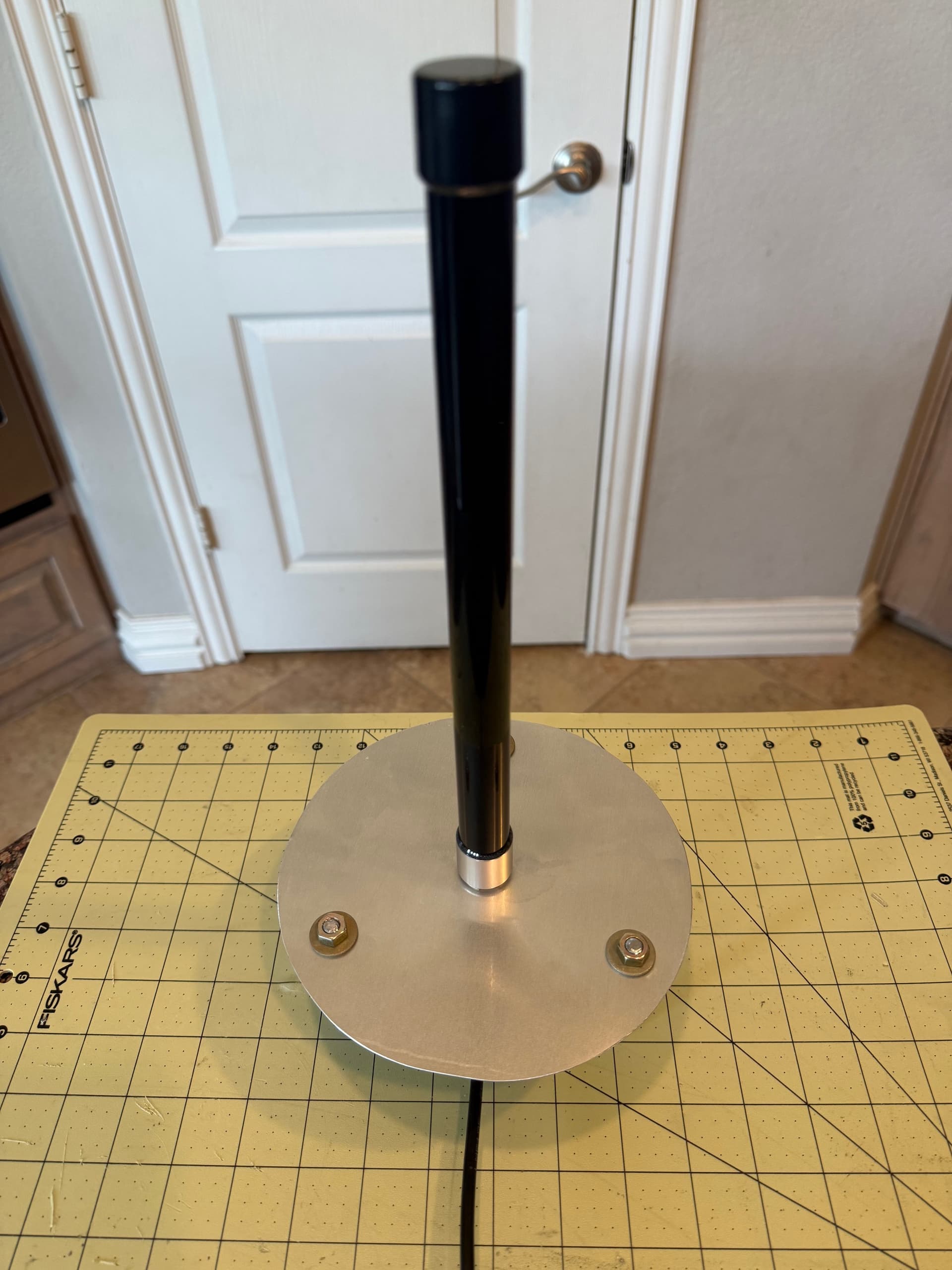

  • On the Rover, the antenna was mounted on an aluminum sun shield, which conveniently doubled as a ground plane.
  • The GCS antenna was mounted on a fabricated ground plane near the ceiling on the first floor of a brick house. While this indoor placement was less than ideal, it provided easy access and served as a stress test. I plan to roof-mount it permanently in the future.

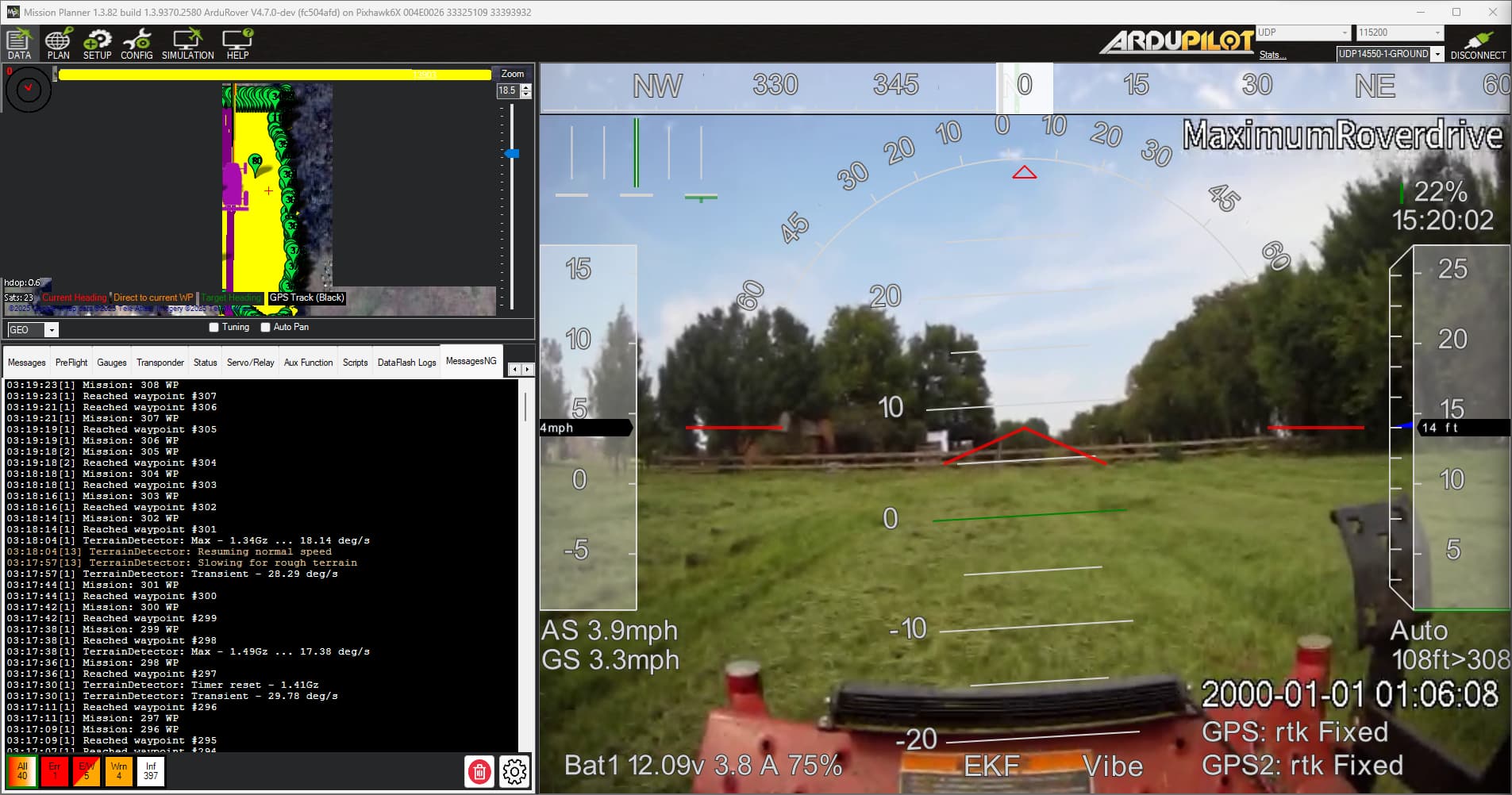

Mission Planner Video Streaming:
This configures Mission Planner to view the 480p substream.
  • Right click on the HUD in Mission Planner
  • Select Video->Set GStreamer Source
  • Enter the following pipeline, substituting your camera’s username, password, and IP address as appropriate:
rtspsrc location="rtsp://admin:password@xxx.xxx.xxx.xxx:554/cam/realmonitor?channel=1&subtype=1" latency=20 udp-reconnect=1 timeout=0 do-retransmission=false ! application/x-rtp ! decodebin3 ! queue max-size-buffers=1 leaky=2 ! videoconvert ! video/x-raw,format=BGRA ! appsink name=outsink sync=false
To achieve the results pictured below, right click the HUD again and select Swap with Map. I’m also using @Eosbandi’s NextGen Messages plugin.
Note: the screenshot shows 4.7-dev firmware, but all features described here are available in ArduPilot’s current 4.6.2 stable release.

try in this morning got video feed *2.2KM before went blank with stock antenna but RSSI never disconnected (-77 for the lowest) so basically still can go much further with just telemetry, so unfortunate the cable disconnect from the FC and no solder in the field, technically i want make the same like OpenIPC

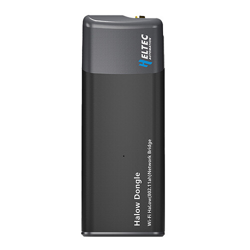

  • Heltec also have a dongle HT-HD01 US$69 that can either be an access point or a station. It also has both Wifi and Halow , USB and Ethernet ports. I’ve done some range testing using my phone connected to the Wifi and the Halow connected to the router. Seems pretty good. I waiting to upgrade my flight controller with Ethernet so I can deploy it.

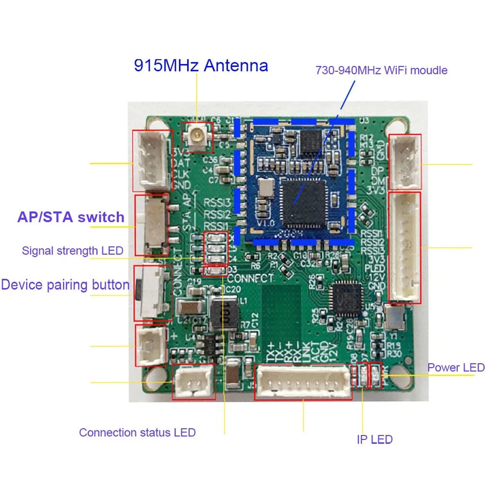

These Heltec units are about double the price of the Anjielo units Yuri used . But they have a proper router that you can get into. Whereas the Anjielo you have to press a button to pair the units and its a black box.
