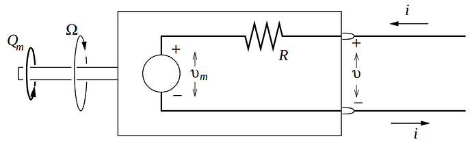

The electro-mechanical model is described as below:
Fig: Circuit of an Electric Motor

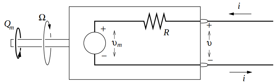

Fig: Nomenclature
The motor model I implemented is based on the theory described in “Motor and Propeller Models for Flight Dynamics Simulations” by Mark Drela (MIT). This model captures the electrical and mechanical behavior of brushless DC motors in a physically realistic way — making it ideal for improving the fidelity of drone simulations in Gazebo.
:high_voltage: 4.1 Electrical Model
The motor is treated as an electrical system, where the input is voltage VVV (derived from PWM and battery) and the output is torque.
The relationship is:
Where:
  • I = motor current [A]
  • V = applied voltage [V]
  • Ω = angular velocity [rad/s]
  • Kv = motor velocity constant [rpm/v]
  • R = internal resistance of the motor [Ω]
This reflects back-EMF: at higher speeds, the motor resists current flow due to the voltage generated by rotation.

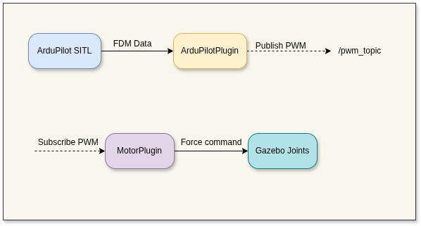

5. Implementation outline
  • ArduPilot SITL transmits FDM (Flight Dynamics Model) data over the local network(127.0.0.1) on port 9002.
  • The FDM also consists of pwm signals (16 or 32 channel) based on the configuration.
  • If the control type is set to “COMMAND” and a topic is provided in cmd_topic then the ArduPilotPlugin publishes the pwm values on the given topic.
This is what the MotorPlugin will subscribe to and calculate the output force which will be then be given in respective joints in gazebo using JointForceCmd
