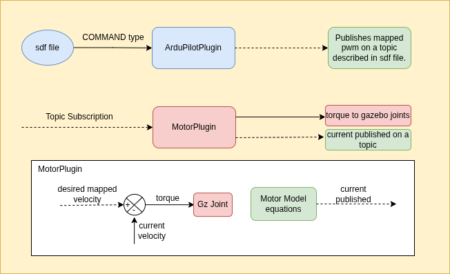

2. Current Implementation
The below block diagram explains the data flow of motor model.
The process flow goes like this. When the type is set to COMMAND in SDF file (COMMAND) for ArduPilotPlugin in the control channel then the commanded signal is mapped to velocity. This is then published on a topic either specified by the user is <cmd_topic>topic_name</cmd_topic> or a default topic. That topic is then subscribed by MotorPlugin which calculates torque required for the joint using the model equations and also publishes the calculated current on a topic for future use.
The parameters required from the user are listed below:-
1. maxVolts:- This represents the voltage of the battery. It’s currently being set to a constant value but will be updated in the future to support reading battery state.
2. velocityConstant:- This is the Kv rating of the motor.
3. coilResistance:- This represents the internal resistance of the motor.
4. noLoadCurrent:- This represents the current consumed by the motor when no load is applied.

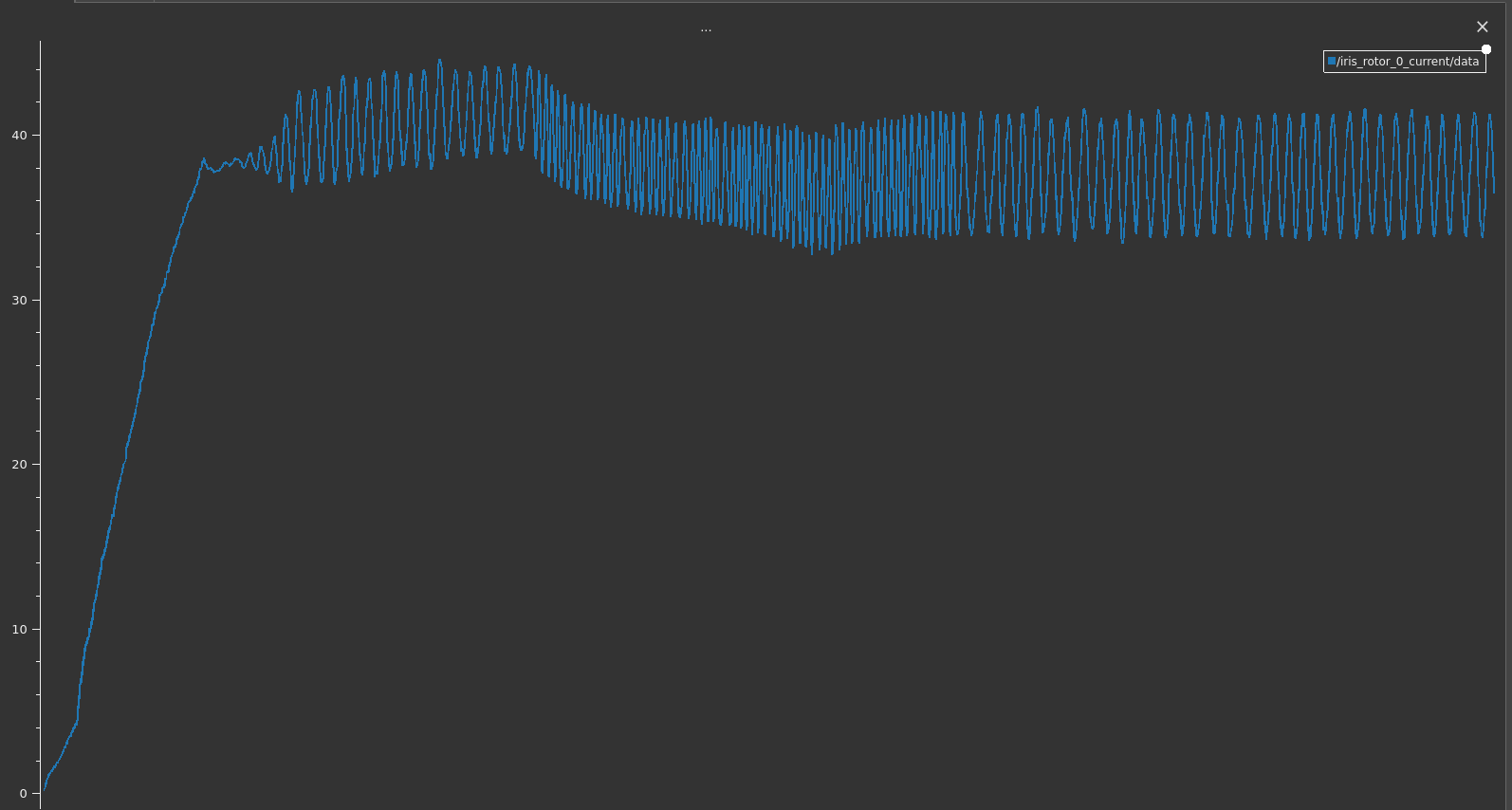

3. Results
The above image is the output of the current being published on a gz topic.
The above images show the stall current of the motor which the motor can withstand. This model only contains the characteristics of a motor now and does not account for propeller dynamics. The rapid, fine ripples come from the ESC firing thousands of pulses per second to spin the motor typical of how brushless motors work. On top of that, the slower waves reflect the flight controller’s constant tweaks to keep the drone stable. Together, they show the motor balancing raw power and precise control in real-time.
