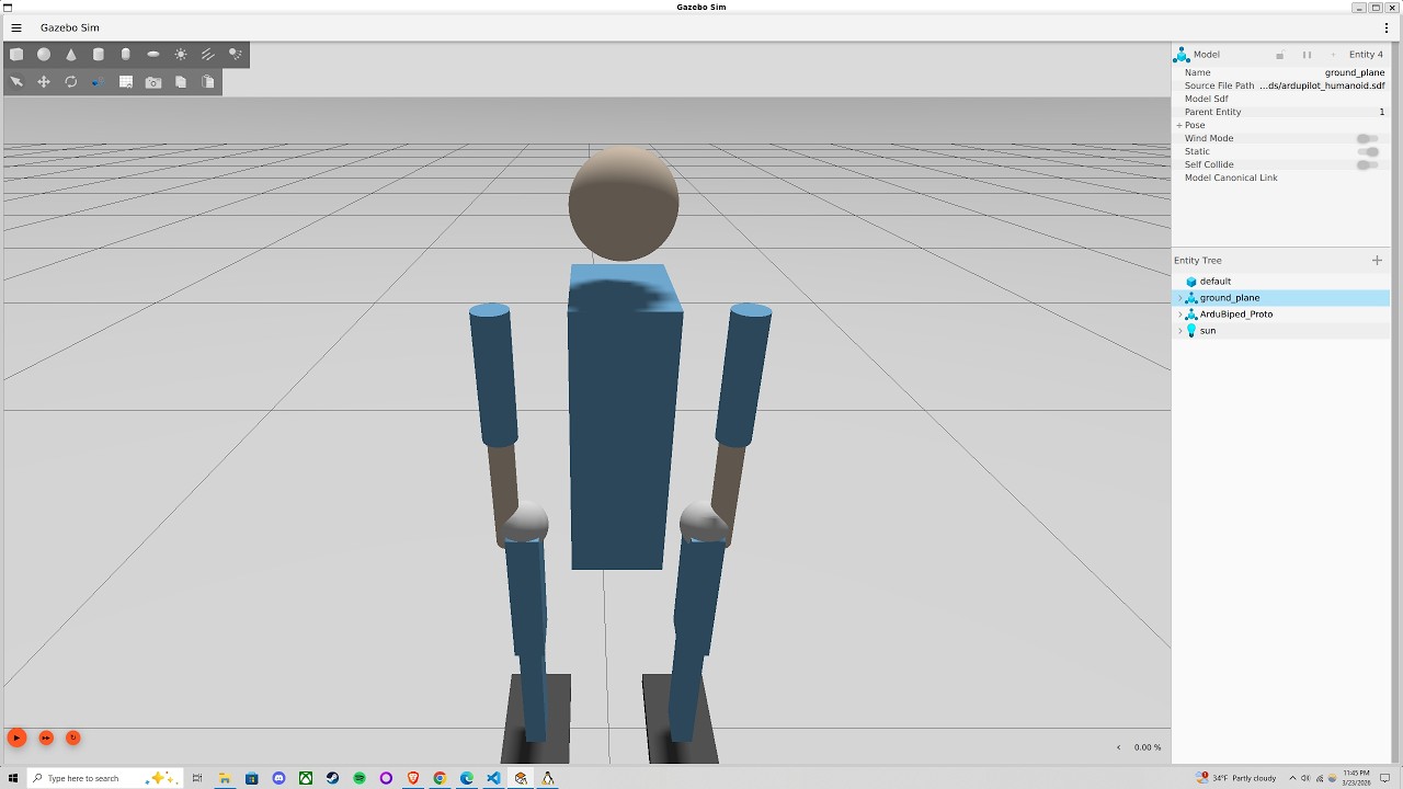

  • ArduBiped_Proto (8-DOF custom humanoid built from scratch) stable in Gazebo
    Harmonic with correct joint limits, inertia tensors, and contact frames.
  • ZMP preview controller in Python: Linear Inverted Pendulum Model, 20-step lookahead
    horizon, DARE-precomputed gains.

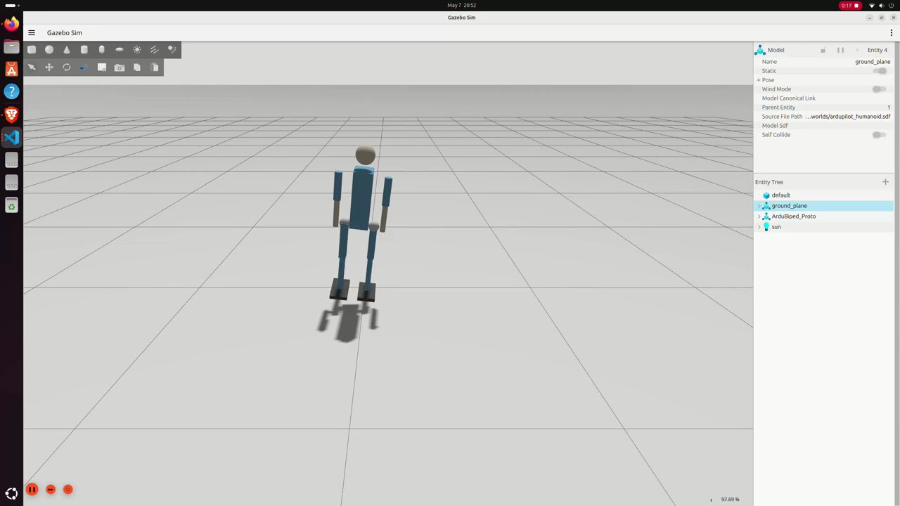

  • Lua library complete: joints, balance, gait, and IK modules. humanoid.lua loads and runs
    inside ArduPilot.
  • EKF3 attitude feedback working via the ardupilot_gazebo plugin.
  • Robot walks 3+ consecutive steps under Lua gait control.

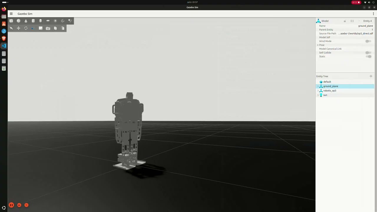

The Lua prototype is replaced, the C++ library is running, and the full pipeline is confirmed end to end.
1. AP_Biomimetic C++ library
Stand and gait primitives run inside ArduPilot firmware. Mode 20 triggers the stand sequence, joints ramp to target angles, and AP_Biomimetic: standing confirms completion before gait starts.
1.1 DroneCAN joint telemetry β€” all 12 leg joints
All 12 leg joints publish position, velocity, and force back to ArduPilot via DroneCAN actuator.Status at 50Hz. joint_state_bridge.py reads Gazebo joint states and publishes them as DroneCAN messages, received by AP_Servo_Telem inside ArduPilot. This is the bidirectional feedback loop the balance controller depends on.
1.2 Full pipeline confirmed end to end
Gazebo Harmonic β†’ JSON bridge β†’ ArduPilot Rover SITL β†’ EKF3 β†’ AP_Biomimetic β†’ 12 joint commands β†’ Gazebo JPC. All 12 JPC topics confirmed receiving data. SERVO_OUTPUT_RAW showing non-1500 values on all mapped channels.

Stage 1 β€” Early prototype, robot standing under Python ZMP controller:
Stage 2 β€” First walking steps via Lua gait controller:
Stage 3 β€” AP_Biomimetic C++ gait running natively inside ArduPilot SITL:
