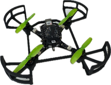

Hi ArduPilot community! My name is Kwaku and I am currently pursuing a Masters degree in Mechanical Engineering at the University of Ottawa. Over the past year, I have been working on a project which provides an open-source swarming platform for aerial drones using off-the-shelf micro-drone hardware called ArduSwarm. ArduSwarm mates Bitcraze Crazyflie hardware with a custom version of ArduPilot to enable self-contained decentralized indoor swarming, with the end goal of using the platform to support my current research into decentralized indoor swarming algorithms.
ArduSwarm drone hardware. Experimental validation of critical ArduSwarm functionality
Figure 1 - From left to right: ArduSwarm drone hardware, Experimental validation of critical ArduSwarm functionality.
In this time, I have become very familiar with the topic of swarming and peer-to-peer (P2P) networks in particular, and as such I’m excited to be working on this with the community!

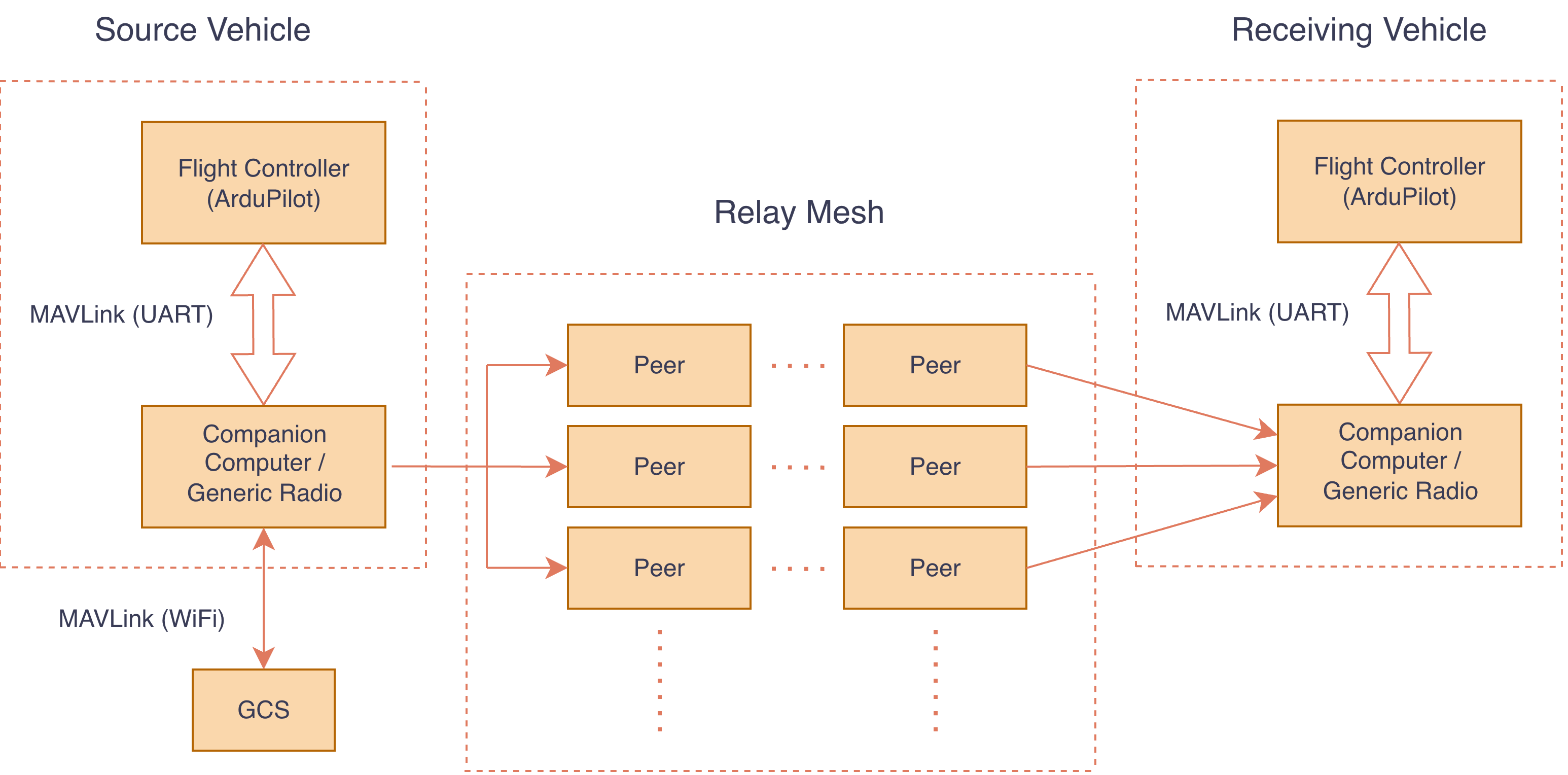

This project builds a scalable communication backend within ArduPilot for decentralized peer-to-peer networks for swarm coordination

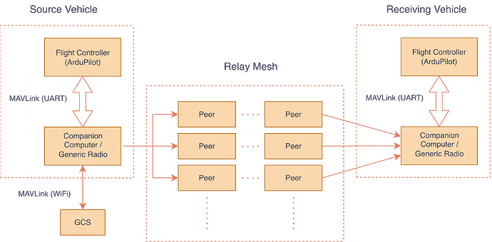

Figure 2 - High-level overview of the AP_SwarmMesh software and hardware structure. Each vehicle connects to onboard radios through two UART ports (one for standard telemetry, one for P2P mesh). AP_SwarmMesh serializes a stream of peer data into MAVLink packets and then encapsules them in a peer routing header. These peer packets are broadcast to neighbors and are distributed throughout the swarm. Upon receiving a peer packet, a vehicle parses the packet and stores a limited state of each peer.
The project introduces:

5. TX Path - Outbound
AP_Scheduler passes AP_SwarmMesh::update() at a reduced frequency of around 100 Hz to reduce compute overhead. If a serial port is bound to AP_SwarmMesh, it passes AP_SwarmMesh_Serial::update(), which iterates through the MAVLink streams (POSITION, ATTITUDE, STATUS, etc.), which are enabled by bitmask parameter. When a stream’s interval elapses, it checks for any priority deferred messages (HEARTBEAT / PARAM_SET) first, then falls through to stream messages serialised with the existing MAVLink macros.
Before sending the packet out, txspace() is checked for adequate space (packet is discarded if full). The P2P header is then prepended, and the packet is written as two succussive buffers to uart, which is the bound serial port which is connected to the P2P radio (either a companion computer in a ‘Full’ peer stream, or a generic radio in a ‘Lite’ peer stream). Also, forwarded packets are written to uart if there is space in txspace().
Any dropped packets are counted, and the loop yields if the scheduler’s 5ms budget is exceeded.

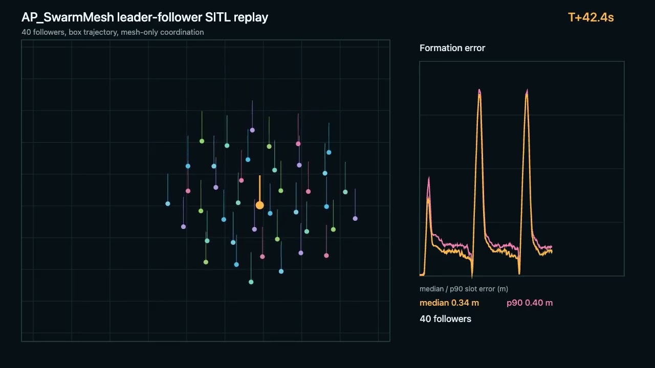

8. SITL and Hardware Demos
I am planning on completing an initial prototype for AP_SwarmMesh within the next couple of weeks. For the midterm evaluation, I would like to have a working demo of AP_SwarmMesh on SITL.
The SITL backend (AP_SwarmMesh_SITL) will replace the physical serial connection with a UDP socket. Each simulated vehicle binds to a known port and sends/receives the same p2p_header_t framed packets in a loop. This means:
  • TX: instead of uart->write(), serialize the header + MAVLink payload into a buffer and sendto() each peer’s UDP port (or a multicast address).
  • RX: recvfrom() in update() feeds bytes into the same parse_byte() state machine. No changes needed to the parsing or forwarding logic.
TTL and forwarding still work as-is, so we can test multi-hop routing by running 3+ SITL instances and blocking direct links by not sending to certain ports.
The key advantage is that the entire framing/routing stack (parse_byte, process_packet, forward_mavlink) is shared and tested in SITL before testing the same code on real hardware.
After SITL testing, I would like to try implementing a hardware demo showcasing a leader-follower formation flight using AP_SwarmMesh as the inter-vehicle communication layer.
A small fleet of ArduCopter drones would be powered on and each vehicle would initialize its peer state table by exchanging MAVLink heartbeat and position messages over the mesh network until every node has a complete view of the swarm. Once the tables are populated, an onboard Lua script reads the local peer state and computes each drone’s target position as a fixed NED offset from the designated leader.
The leader drone would hover in GUIDED mode and would be flown manually via RC_CHANNELS_OVERRIDE. As it moves, AP_SwarmMesh propagates its updated GLOBAL_POSITION_INT to all followers, where the Lua script continuously recomputes the offset target and issues SET_POSITION_TARGET_GLOBAL_INT commands to maintain formation.
The demo would showcase the full library stack: serial framing, header CRC, deduplication, TTL-based multi-hop forwarding, peer state updates, and the onboard logger.

  1. I see no hardware specified here, what system will be used and how does it handles collisions and what it is throughput
  2. 2 serial ports to FC shouldn’t be necessary.
  3. Duplicating sysids and other MAVLink message fields wastes airtime and IMHO is pointless
  4. storing both local and global coordinates in peer state is wasteful
  5. IMHO velocity vector is much more useful than attitude for coordination, maybe velocity and acceleration, additionally having both actual target and actual velocity and acceleration would allow feed forward in position control.
  6. storing other node vehicle internal state seems wasteful,
  7. Coordination state requires explaination of its purpose and seems application specific.
  8. Required message rates fall off with distance (which can be approximated by hop count) so how will seq_seen_mask work if vehicle reports its position at 10Hz with ttl=0 and at 1Hz with ttl=5 (example)
  9. If the system needs common time and (deadline_ms) suggests that it does there must be provision for automatic clock synchronization.
  10. IMHO mesh management should be handled by the mesh radio and it probably should be done by a separate component comparable to ESP32 based DroneBridge, AFAIK ELRS team found incorporating radio code into FC and managing versions to be problematic wrt user experience.
  11. How will assymetric reception be handled by this system ie. node A hears node B but node B can’t hear node A due to eg. background noise.
  12. Limiting swarms to a dozen or so vehicles is constraining even compared to paltry 255 vehicles supported by MAVLink.
  13. IMHO routing data and neighbour data should be handled separately as you should be able to route to any peer but only close neighbours are relevant for navigation (assuming boid type swarming)
  14. Logging a lot of information about neighbours seems pointless. IMHO it would be much better to develop multi log capable log viewer eg as an option in the Ardupilot log viewer. (plot.ardupilot.org)
Congratulations on taking a very ambitious project and good luck.
Hi, thanks for the detailed feedback!
  1. I am considering two distinct reference hardware backends. The first being the “Full” backend which would use an RPi with a Wio-WM6108 pcie board which would provide full 802.11s support and would provide upwards of ~15mbps bandwidth. The second being the “Lite” backend which would attempt to target “generic” hardware (ie. ESP32) at a raw 1mbps. This would require some heavy work into writing embedded firmware for the ESP and would need to implement its own routing algorithm (unlike the Full backend). For CA, I eventually envision implementing something like using voronoi cells to bound trajectory for drones within their local neighbourhood, but this is very much a stretch goal.
  2. Yes I should clarify, AP_SwarmMesh will only use one serial port. The other is used by the standard telemetry link.
  3. This is still a question for me as well. The idea here is to eliminate the dependance on any MAVLink fields so the new protocol can be easily extended for other message types (ie. ACK, SYNC, etc.) in the future. Also, both the external radio and the FC don’t need to parse the wrapped MAVLink packet for routing this way. I am still torn as to what is the best compromise here.
  4. This is a good point the idea was that local coords would only be stored if global were not available. However maybe I can reuse the same field for both to save 12 bytes per peer?
  5. Yes this makes sense. Perhaps I do pos, vel, accel 3 DoF, reusing the same fields for global and local depending on if the peer has a global stream or not. Do you mean having target vel and accel as well as target pos is useful?
  6. My thinking was some vehicle state data could be useful for some safe coordination functions and health monitoring of local neighbours. Do you have any thoughts on a more succinct way of monitoring health/safety? Also worth noting that these streams would not be enabled by default and would be up to the user to determine what data they deem necessary by setting a bitmask.
  7. Yes I completely agree, I am not yet sure what the best way to generalize this data is. As you mention, it is application specific. Do you have any ideas? Or maybe I can omit the coord state entirely and leave that up to a downstream coordination algorithm to handle?
  8. The idea with seq_seen_mask is to add some basic duplicate rejection in the edge case that two of the same packet arrive from different peers at around the same time but last_seq != seq due to another packet arriving in-between. seq_seen_mask is a sliding window bit mask which allows you to check up to last_seq - 32 for these duplicates. Duplicates should in theory be caught by the routing protocol on the external radio, but I thought I’d add this check on the FC as well.
  9. Yes absolutely the staleness check will only apply if the drone has a time sync source. If not deadline_ms is ignored and staleness check falls back to TTL only.
  10. I completely agree, my plan was to leave all routing and radio management to the external radio (either the “Full” or “Lite” backend). The idea is that the peer header is visible to the FC, but its fields are primarily intended to be used by the external radio for its routing algorithm.
  11. Currently the first implementation is not “synchronized” and does not handle asymmetric reception, however this is where the modularity of the peer header (as mentioned in #3) would come into play. A stretch goal could be to implement ACKs on certain critical data without needing a new header and infrastructure.
  12. Yes I agree, I have been debating how to balance sufficient data for coordination with sufficient room for scalability. Currently my code initializes a state table in memory based on a set max peers which limits total ram usage to around 2.5 kb. Perhaps a better approach would be a dynamic max peer allocation depending on which FC you are using (ie. lower end FCs would be limited in scale, while FCs such as an H7 could support much larger swarms)? I would also think that in many decentralized swarming applications a massive peer table in memory wouldn’t be strictly necessary. In many use cases you probably only need to maintain memory of a relatively small amount of local neighbours. However, I think you are right in that this determination should be up to the user and their specific hardware config.
  13. Yes I agree, my intention is that routing will be handled by the external radio and peer state data will likely be limited to local neighbours as mentioned above.
  14. Yes I think the majority of the data shared between peers here would not be logged. My intention was to provide the capability to log most peer data if the user should choose to. A logging bitmask would be provided similar to standard telemetry streams.

swarm_formation_scale_test.py launches up to 254 ArduCopter SITL instances (staggered to avoid a boot time CPU spike), brings them up concurrently, arranges the followers in a sunflower pattern around the leader for even spacing, and then flies the leader through a box trajectory in GUIDED. As the leader moves, its GLOBAL_POSITION_INT propagates over the mesh and every follower recomputes and commands its slot offset.
3.2 Results
The main result is that a swarm at the full sysid range holds sub-meter formation (ran on a 48 GB M4 Pro MacBook Pro):
Table 2 - Leader-follower formation accuracy in SITL (leader flying a box trajectory)
Followers Armed & airborne Tracking moving leader Median formation error
40 100% 100% 0.36 m
253 253 / 254 236 / 252 (94%) 0.87 m (p90 5.3 m)
Getting almost the full 254 node run to hold this tightly came down to the freshness/position lesson from section 2.3. Before silencing the follower position streams, the same 254 node run tracked the leader at a median error of about 19 m. Afterwards it dropped to 0.87 m simply by not flooding the mesh with unused data.
It is also worth noting what does not scale well. AP_SwarmMesh’s peer table and routing layer scale cleanly to the full 253 peers, which I verified by injecting synthetic peers over UDP. That test shows the same process_packet() path without needing to generate hundreds of vehicles. The practical ceiling in the flying experiment is thus most likely the simulation hardware as expected, not the mesh itself.
To view interactive replay of the experiments, download the following and open the html files on any web browser: swarm_formation_runs.zip (493.5 KB)
Figure 5 - Replay of the 40 follower leader-follower run. The leader is shown in amber, followers are shown as the surrounding swarm, and the right panel shows formation error over time.
Figure 6 - Replay of the full 253 follower leader-follower run. The leader is shown in amber, followers are shown as the surrounding swarm, and the right panel shows formation error over time. Notice some followers lose tracking (around ~6%) due to SITL hardware limitations.
