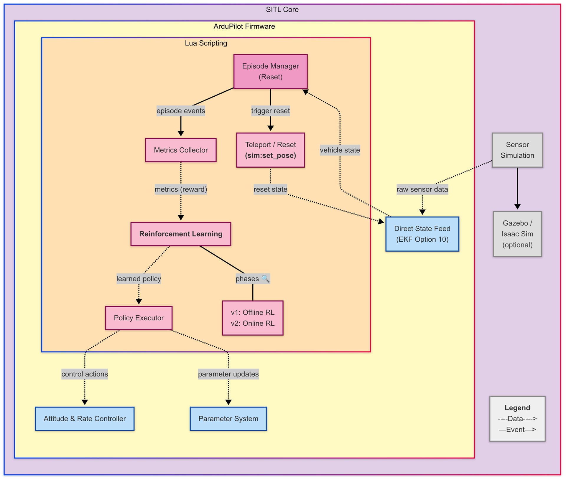

4. Solution Diagram :framed_picture:
4.1 Block‑by‑Block Breakdown
Block Role Key ArduPilot / Lua APIs
Episode Manager Detects episode termination (e.g. time‑out, crash, success) and fires a reset. time:millis(), custom state checks
Teleport / Reset Instantaneously re‑positions vehicle & zeros attitude/vel using sim:set_pose(). sim:set_pose(instance, loc, orient, vel_bf, gyro)
Metrics Collector Computes reward signals (tracking error, overshoot, energy) every tick. ahrs:get_pitch(), vehicle:get_target_alt(), custom math
Reinforcement Learning Updates Q‑table / value function in‑place at ≈ 10 Hz; selects next action. During the Offline RL Phase it runs in log‑only mode to gather state–action–reward traces for baseline training, switching to live updates in the Online RL Phase. Pure Lua tables for Q‑table; math lib
Policy Executor Applies action by tweaking params or sending direct control: param:set("ATC_RAT_PIT_P", val), vehicle:set_target_roll()
Direct State Feed (EKF Opt 10) Supplies fused state to Lua via binding helpers (ahrs, ins, etc.). Firmware internal
Sensor Simulation Generates IMU/GPS from physics backend (Gazebo or built‑in). SITL C++

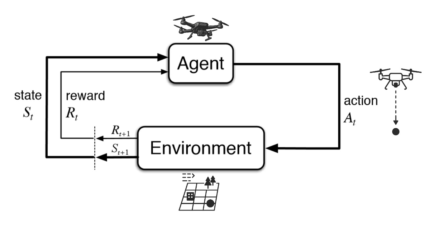

5. How the Loop Runs :counterclockwise_arrows_button:
  1. Reset → Script arms vehicle, immediately calls sim:set_pose() to starting state.
  2. Episode → RL chooses an action (e.g., ±5 % on ATC_RAT_RLL_P).
  3. Flight → Controller responds; Metrics Collector accumulates reward.
  4. Terminate → After N steps or goal reached, Episode Manager logs result and triggers new reset.
  5. Learn → RL updates its policy online before next episode begins.
