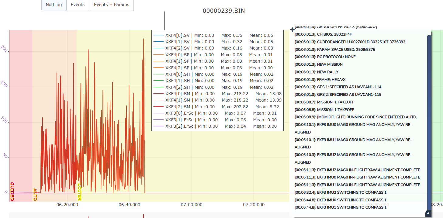

Today we had a “Yaw Re-aligned” after takeoff, during a pilot training session.
LOG: https://drive.google.com/file/d/1lY8S1yFkH-2_G-jdE1jrf3OiwSWrIA8h/view?usp=sharing
Checking the log, I noticed some insane values for XKF4.SM, and they suddenly go back to normal as soon as IMU0 and IMU1 switch to COMPASS 1.

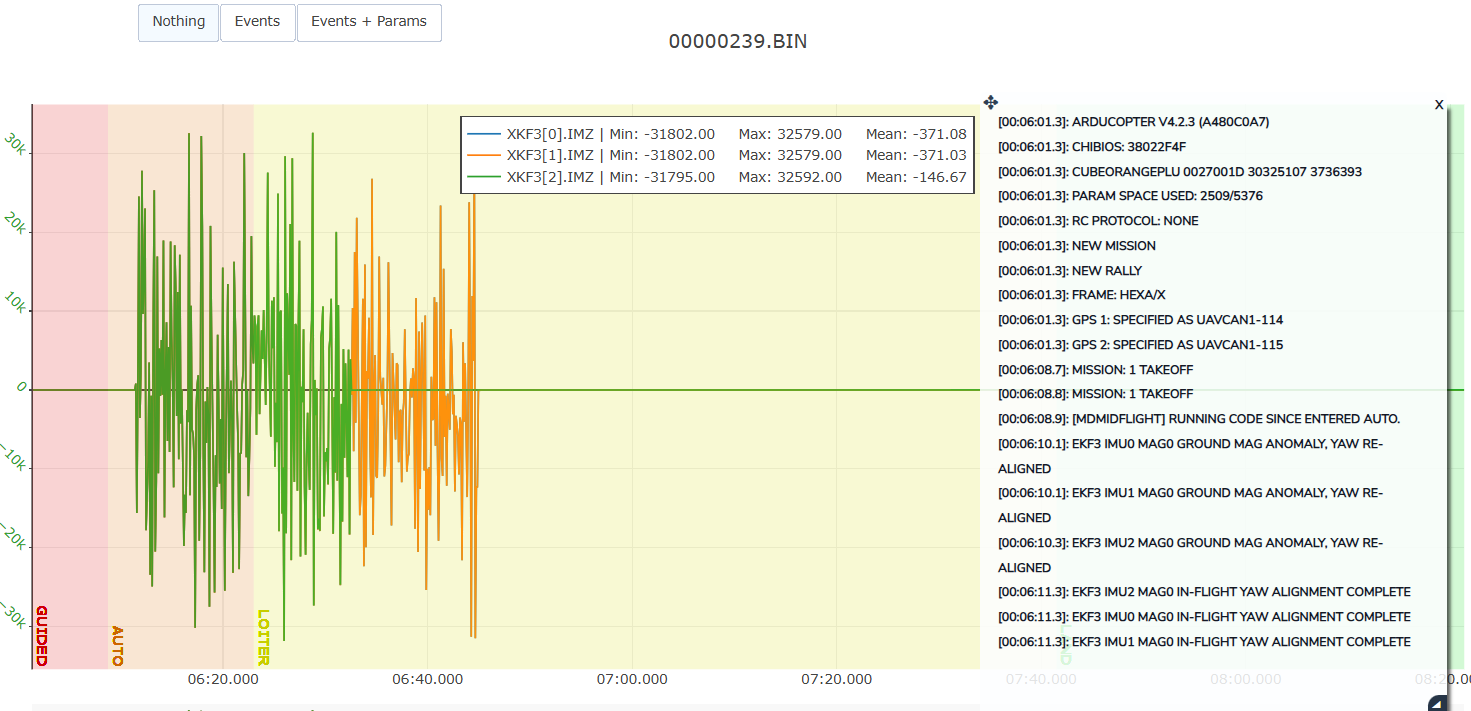

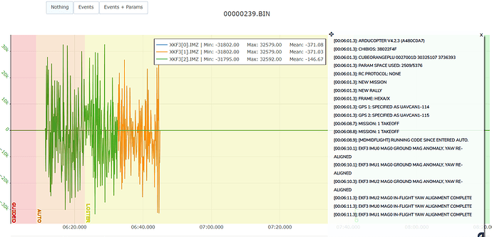

Digging a bit, I found that these crazy values came from XKF3.IMZ

Mag1 has lots of noise on the Z axis, this looks like a fault to me.
Mag3 is just typical for a Kore carrier onboard compass.
At this stage it’s not worth messing with small calibration changes, Mag1 and Mag2 were good enough before Mag1 went bad. It seems it was already bad before this flight - there’s no change in quality during the flight.
I would say disable Mag1 until it’s replaced and just rely on Mag2 for now - the copter would be fine for all but critical operations.

I cant say why it took so long to switch to the second compass, even though the noisy Z field of the first compass was was quite bad. EKF does consider the GPS heading too, so that could be a factor.

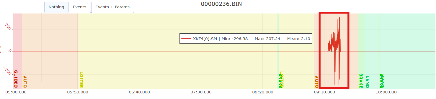

We’re replacing that compass now. I’m asking the local team to send older logs to understand when this GPS/Compass unit started to show these measurements.
We see the same issue in the two previous logs (237 and 238), but no one noticed anything unusual since the switch occurred right after takeoff.
LOG 237: https://drive.google.com/file/d/1F81gGKqm_5Ep2hm-l_WcI675wYV6sBEQ/view?usp=drive_link
LOG 238: https://drive.google.com/file/d/1WM6dRbE-SRWCtDalqkGYjUXFFPMNYgRw/view?usp=drive_link
The issue appeared during the flight from the log 236.
LOG 236: https://drive.google.com/file/d/1uN8vjzXd9mY1-MugW2__X6HcPacqnJPV/view?usp=drive_link
Before 236, it was performing normally.
LOG 235: https://drive.google.com/file/d/1LWBDzQsqsVBpsEIAhRVAYbIOe1kzq9QH/view?usp=drive_link
LOG 228: https://drive.google.com/file/d/1YWURdlIMuVT7gsJmaOqX0AUfTVEwmuE7/view?usp=drive_link
After replacing the compass, all back to normal
