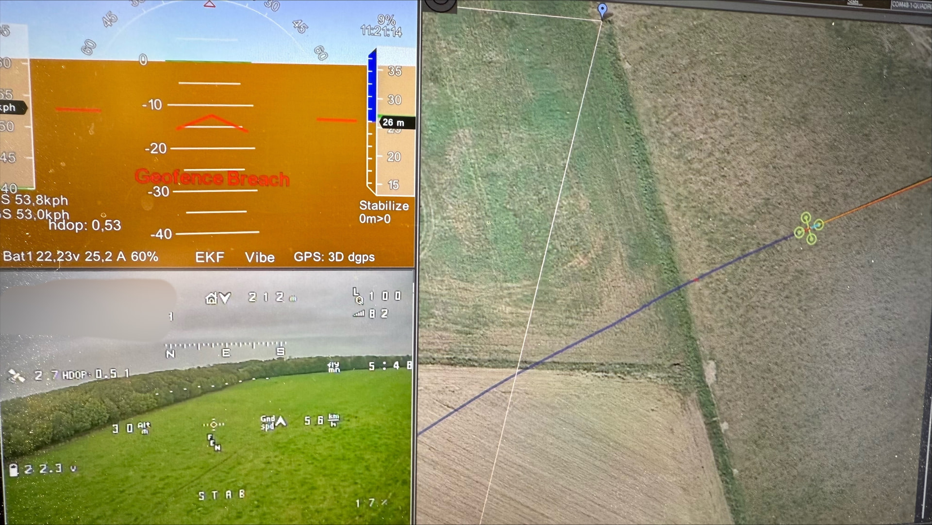

Geofence breach no backup fences

After the first breach, the vehicle brakes as expected. But when I change mode to take over and continue flying outside the fence boundary, the backup fence does not activate.

Brake mode, Im flying acro into the fence, it brakes, then I switch to another mode, stabilize, to take over control again, I continue flying outside the fence bounderary without ardu kicks in a backup fence after 20m.
I flew up to 200m away from the fence without backup in stabilize or acro mode.

Ah. I think I see the problem.
Your image there shows a polygon fence. If you are expecting a backup fence to be created for that polygon fence you will be disappointed - we only create the backup fence for the cylindrical fence (creating a backup fence for a polygon fence rather harder.
@andyp1per has done some work recently that might allow for a polygon backup fence, however.
Could you confirm that you were expecting a backup fence for polygons, please? If so we probably need some documentation fixes.
Thanks you so much! So I must have circle fence on in my tests in 4.5.7 while ago.
writing SOP for custom drones on ARDU. So thats an important detail for flight safety SOP. :wink:
So yes I confirm I was explenting backup fence for Polygons.
