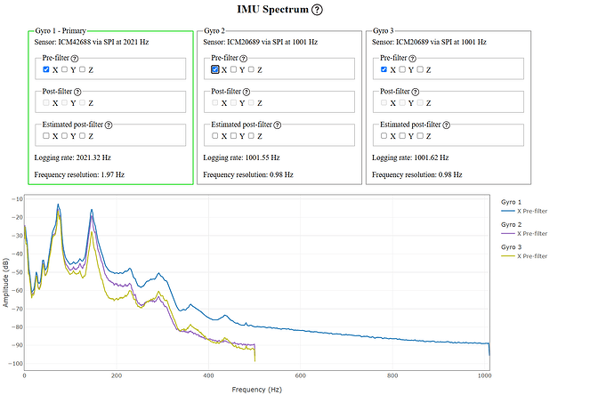

However, the vibration dampening seems ineffective in this case.

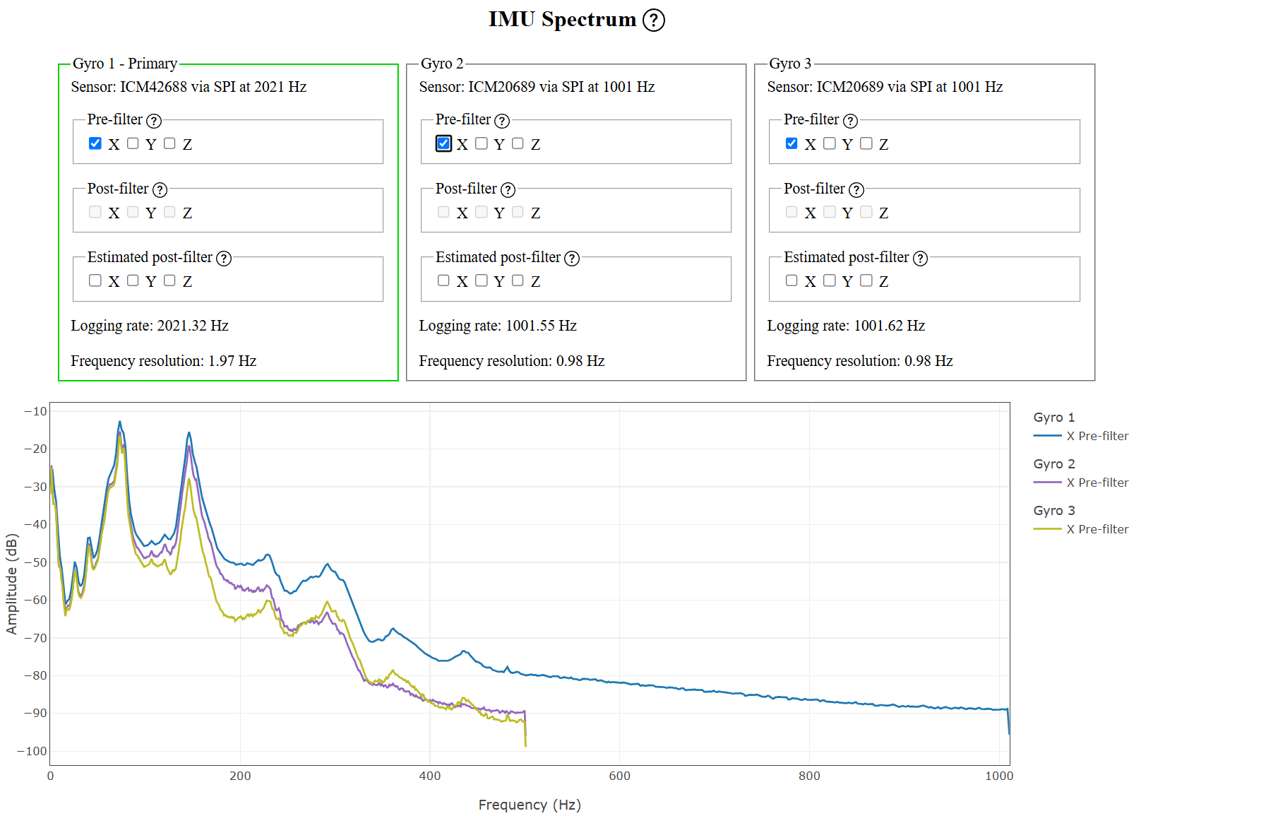

Do you have an FFT log for that board?

What looks much better, the PCB design or the general insides housing for those PCBs? I don’t have FFT log yet, only flight logs. I mean, the least I can say is that on a gas UAV I have a green vibration tab on all RPMs using just a Chinese made vibration platform sitting under the flight controller, which costs like $2.
Interchangeable dampers is a cool idea. For me personally, I don’t have any specific issues flying on electric drones, I sensed vibration problems only with gas powered drones :slight_smile:

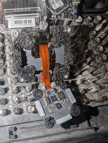

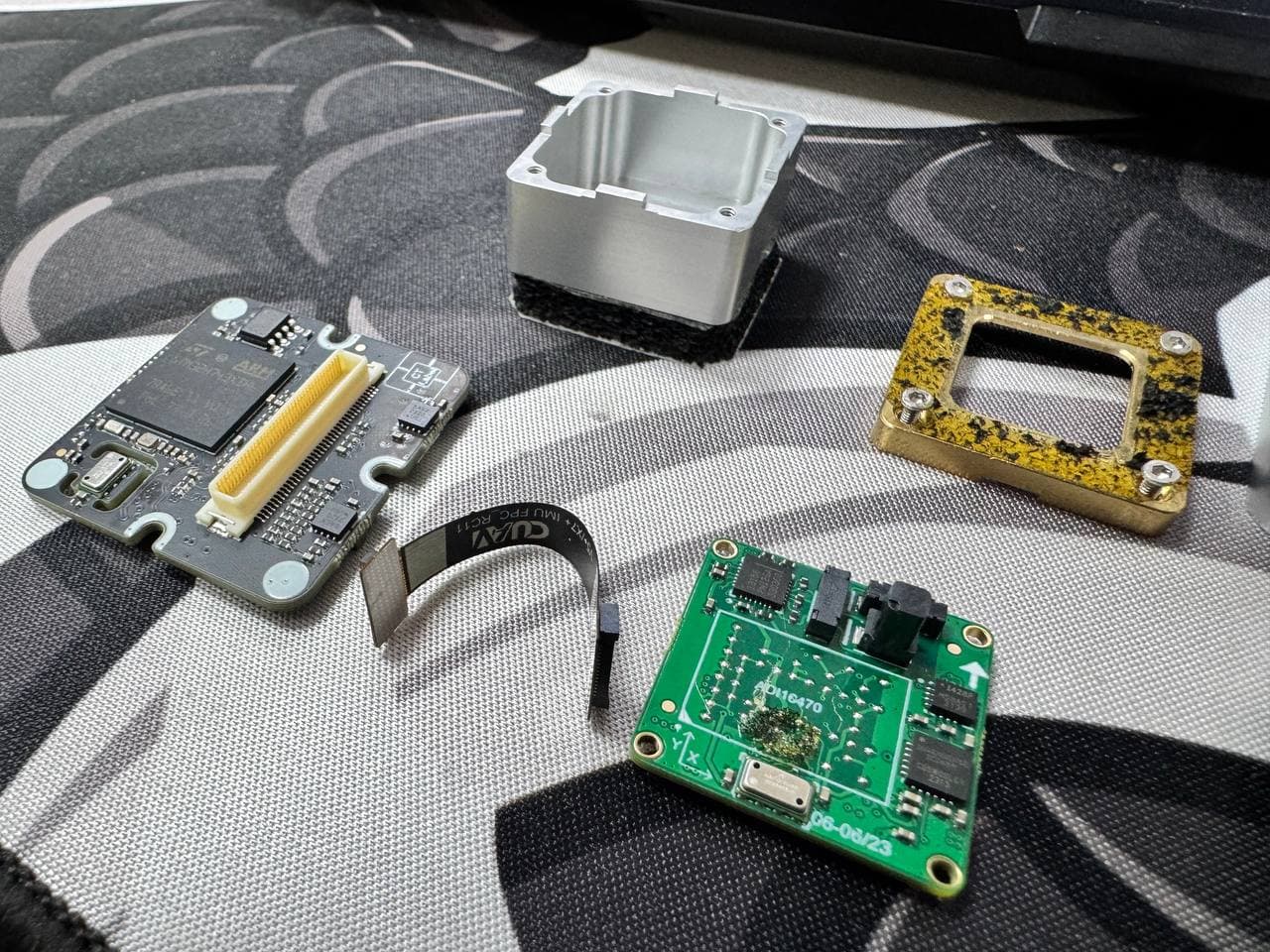

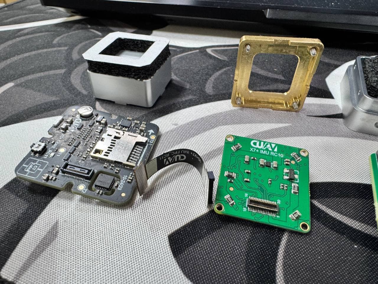

CUAV X7+ insides

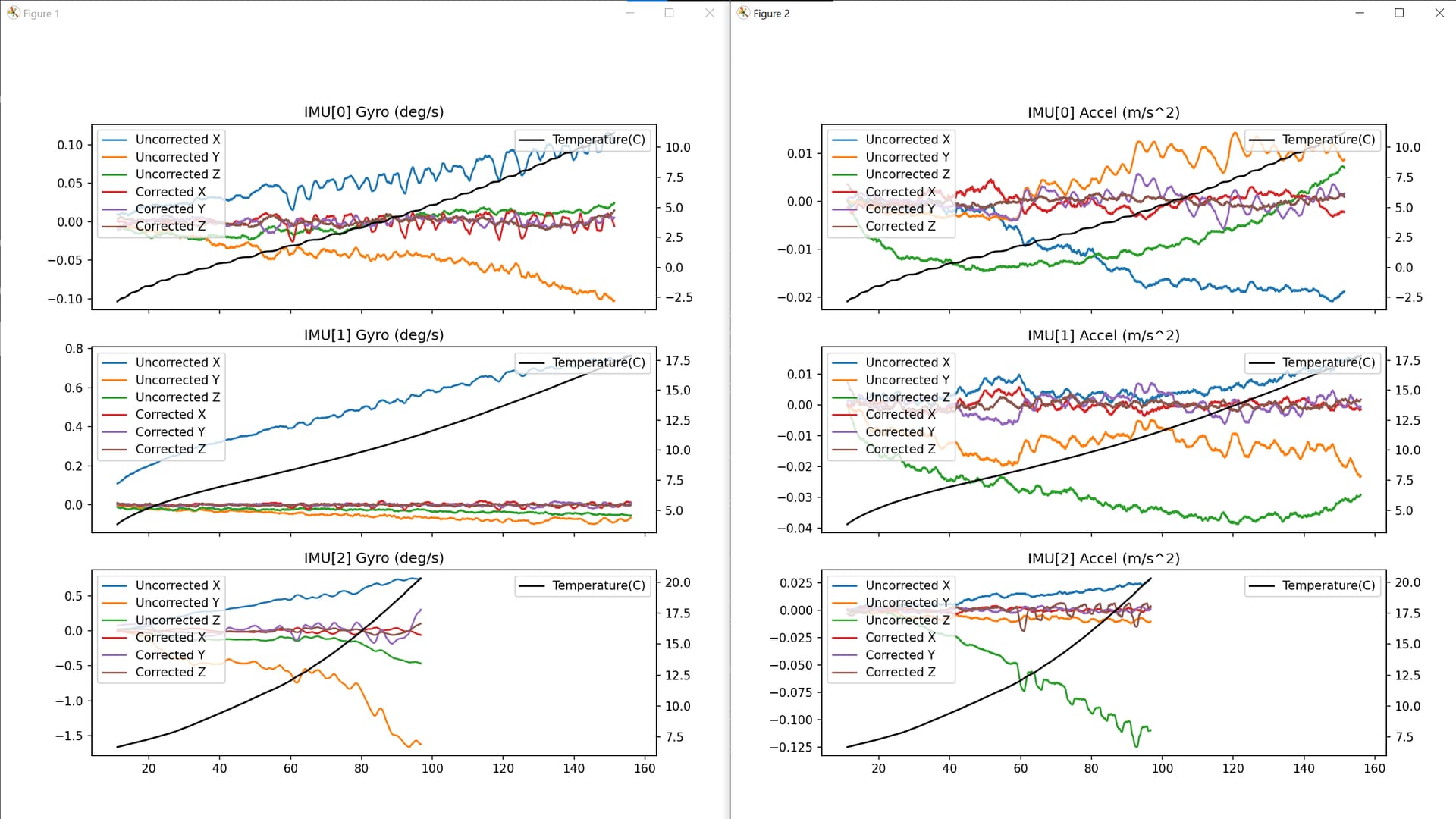

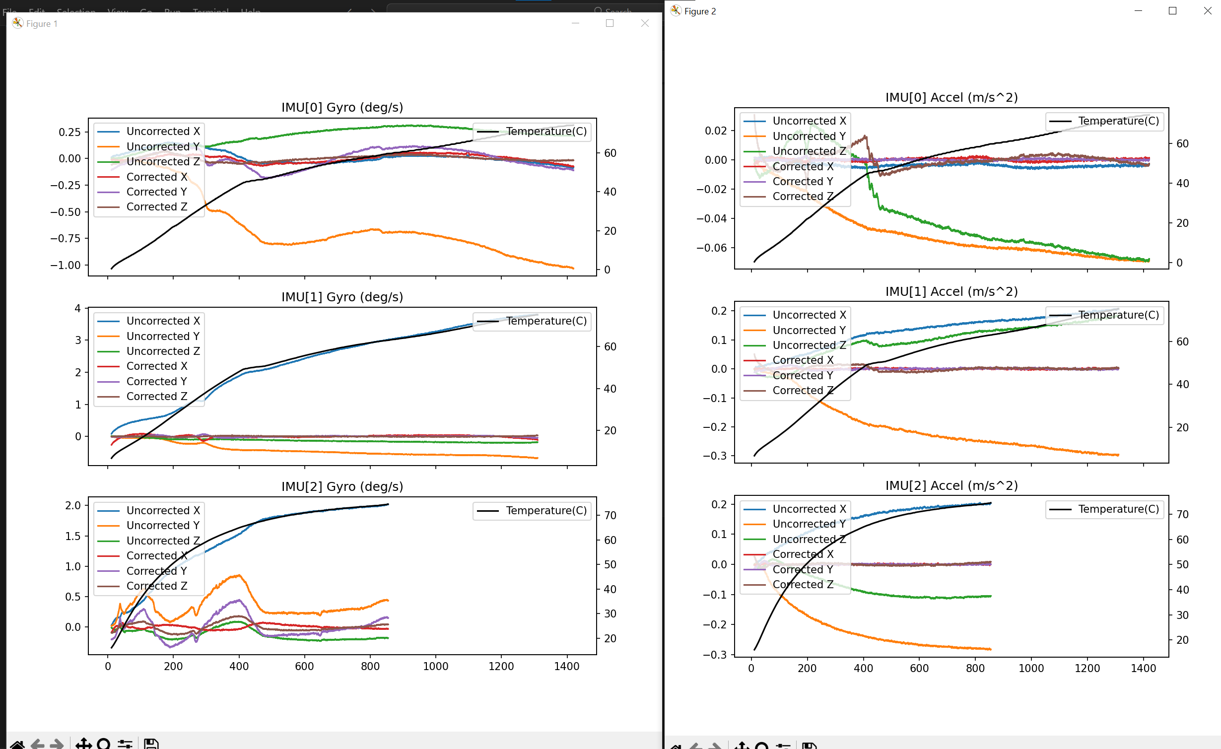

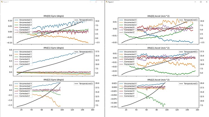

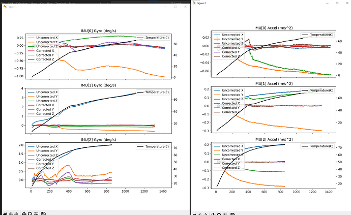

This flight controller has issues with IMU heatingβ€”each sensor heats up at a different speed and lacks proper thermal calibration for the temperature sensor.
To improve temperature scaling and IMU deviation alignment, we made a small firmware change, as the stock calibration is quite poor.
before
after

Disassembled the CUAV X7+ there’s absolutely no reason to design a separate IMU the way they did.

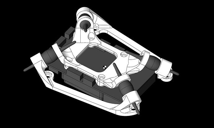

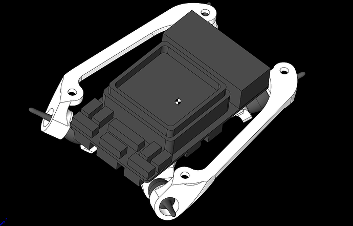

First step in evaluating vibration dampening:
I had some discussions with CAE engineers. They suggested aligning the damper vector through the vertical line from the center of gravity (CoG), with the ideal case being the IMU sensor centered on this line.
I’ll work on the design.

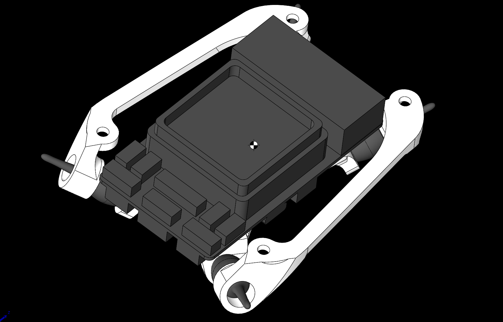

First layer of vibration dampening
Second layer on the IMU
Still thinking about it
