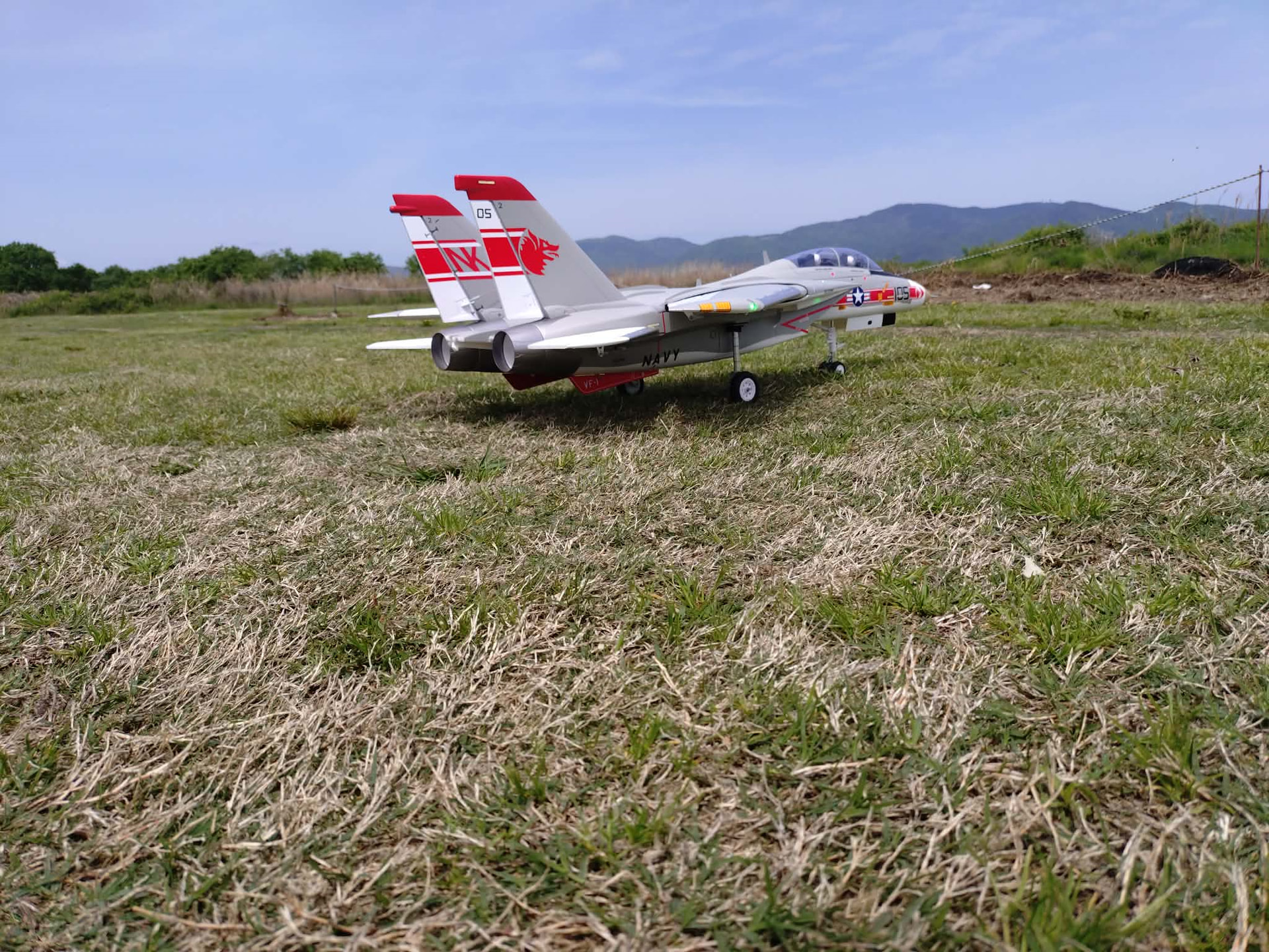

Hi all!
I got FreeWing F-14 64mm V2.

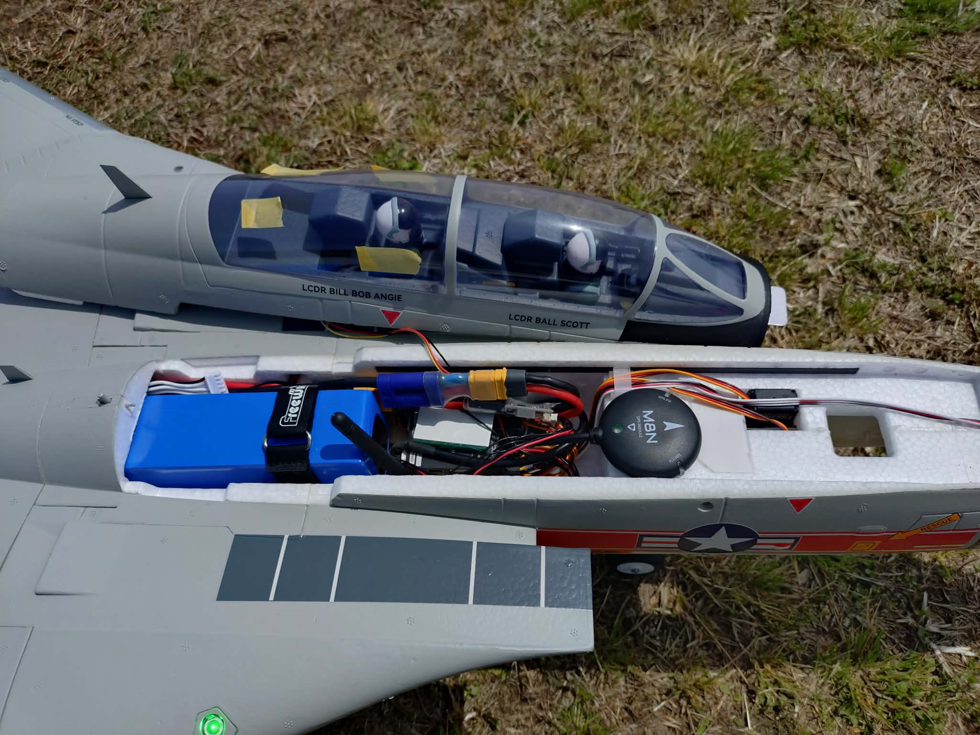

I set Pixhawk6C mini + M8N and Plane 4.6.3.
The GPS was touching a small part of the underside of the canopy, so I shaved off a little bit of that area. No other modifications were needed for mounting the FC or similar.
It can fly for about 4 minutes with a 6-cell 5200mAh battery.
Attitude control works well by default setting.
I’ve set the roll angle limit in FBWA to 60 degrees.
I’ll try the autopilot from takeoff to landing sometime soon.
For landing, if you don’t keep the descent rate low, it bounces around.
I think it’s a fairly easy-to-fly ducted airplane.
1st Flight.
2nd Flight.
3rd Flight.
