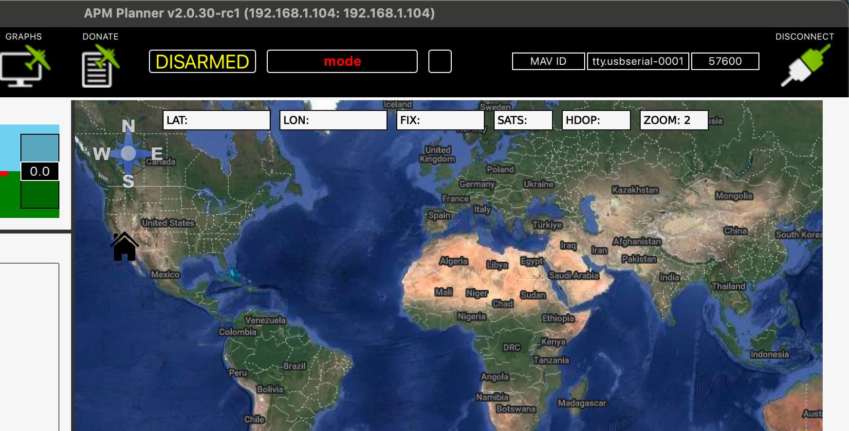

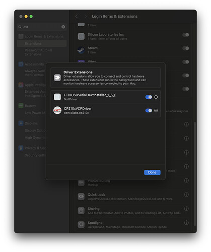

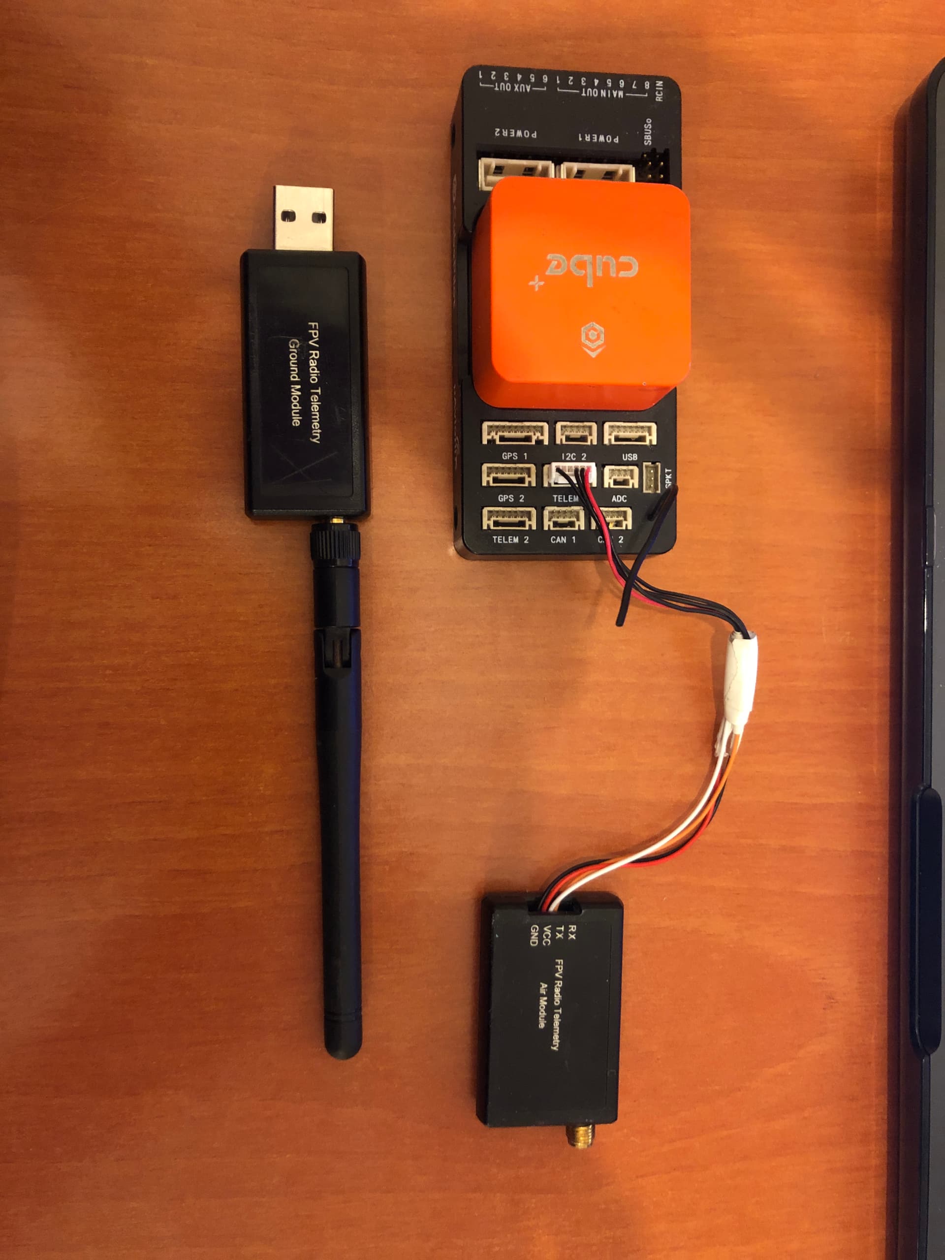

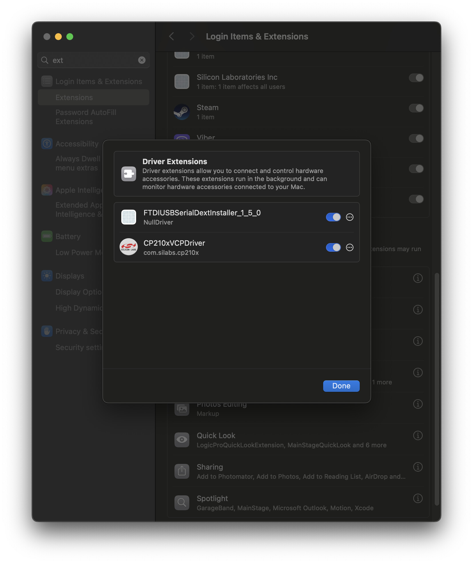

On my Mac 15.3.1 OS X I still get the issue… Here are some pictures to give you context:
Everything seems to be in order, but to no avail. It doesn’t want to recognise my Cube Orange Plus no matter what I do.
The Cube Orange Plus is flashed with Ground Rover Firmware. When I connect it to my laptop through a USB cable, I can interact with it.
I have all the drivers necessary (or at least I believe so), but still nothing is going my way…
What am I doing wrong here?
I hope that someone can see my hopefully silly error, and fix it…
I know that @timtuxworth , @drnic use a Mac for sure, so maybe you 2 are knowlegdeable about this?
Thank you for your time in advance!

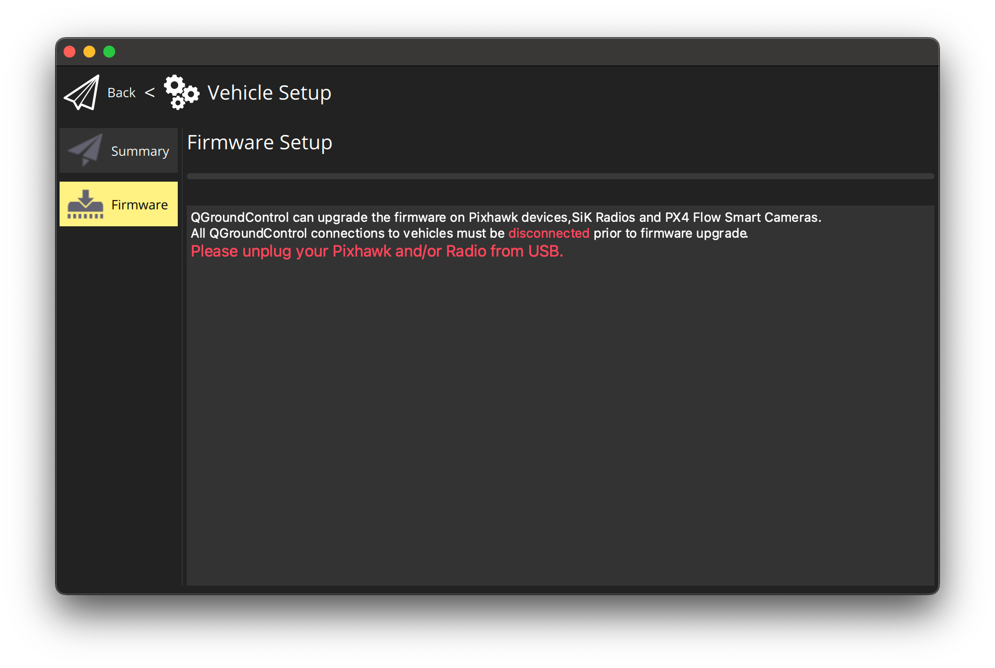

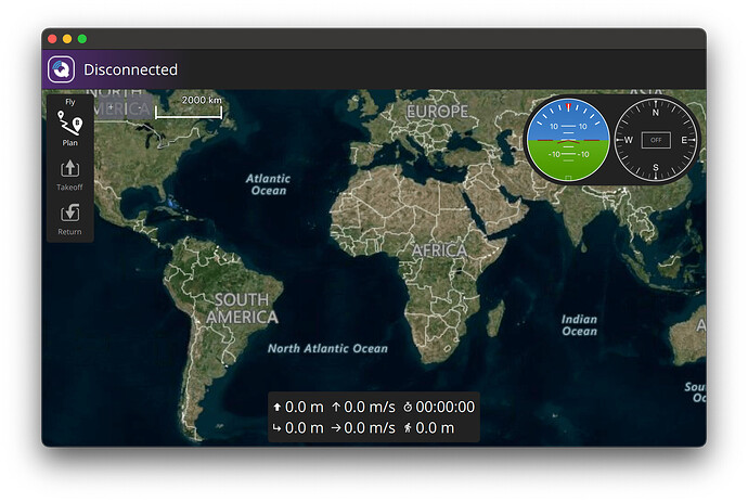

Here is what I get in my QGS:
Does anything here give you any insights, or am I just f***ed… Thank you in advance

The “permission error” is a clue I’m sure.
I’ll try on my Mac when I get home tonight and see how I’ve got it configured and get back to you.

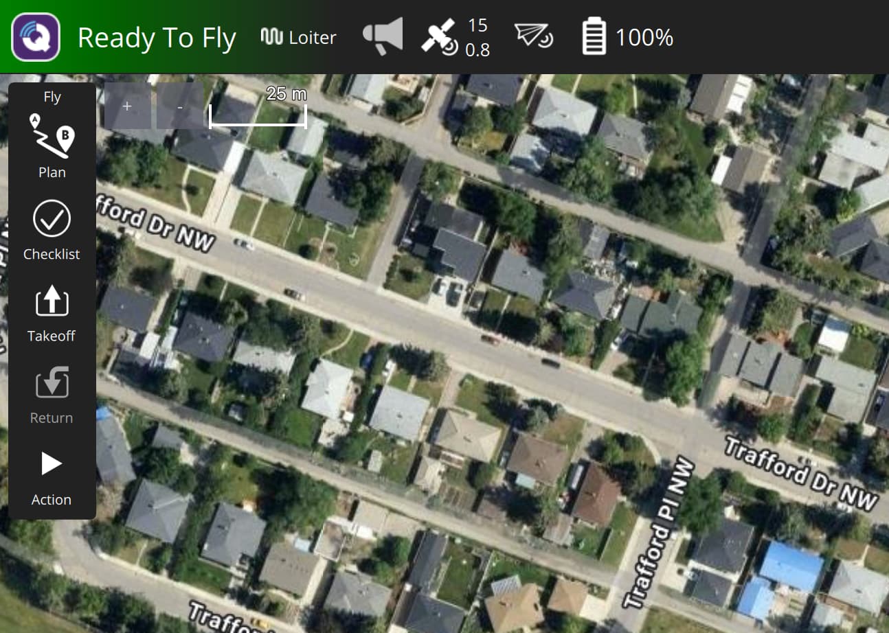

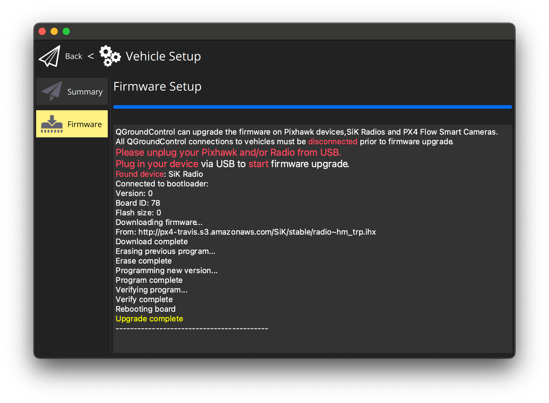

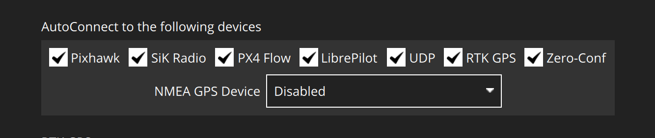

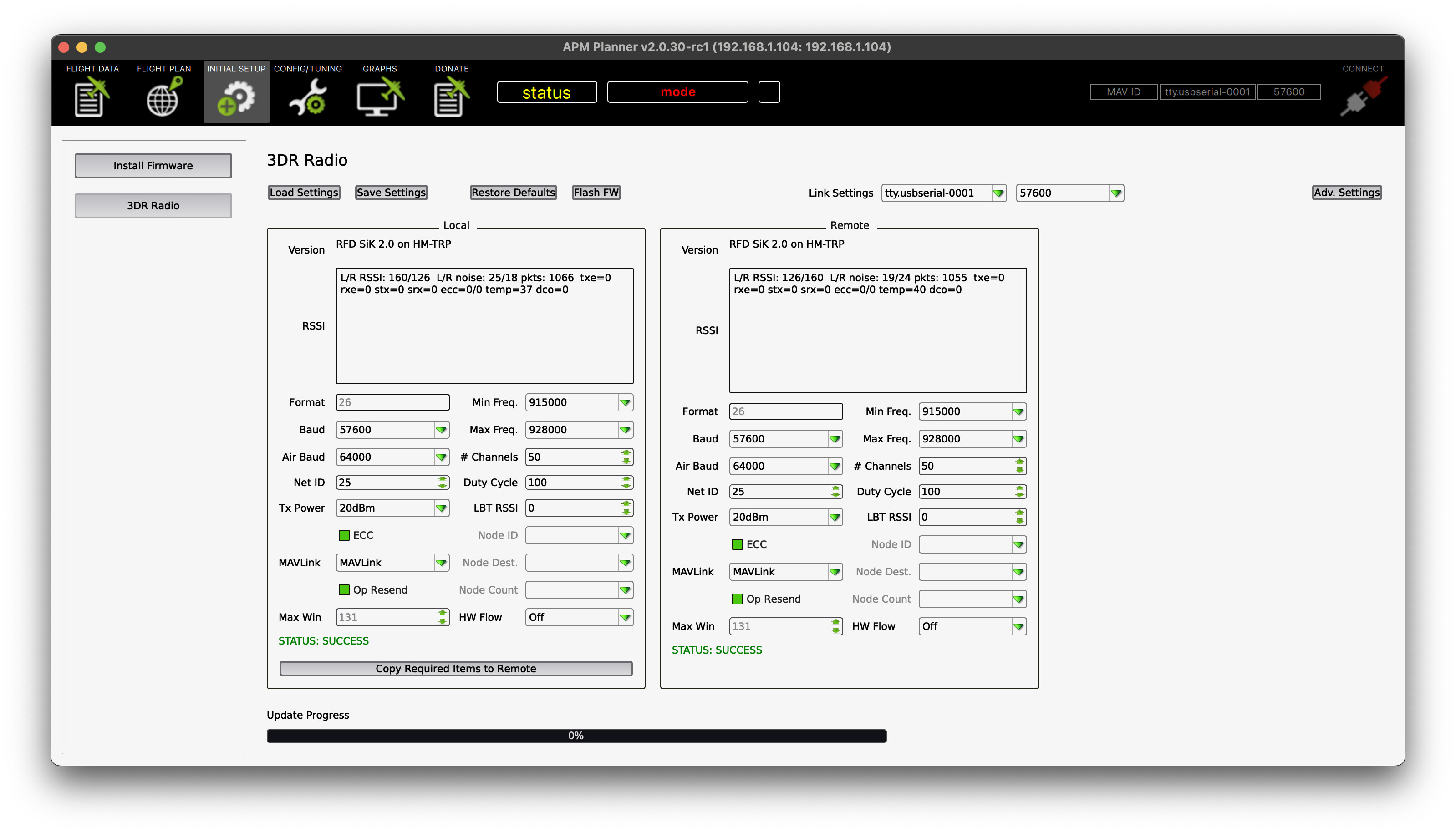

I’m connected via a SiK radio to a quad via QGC on my macbook.
I have no comm-links set up on this install (nothing relevant anyhow) and AutoConnect is turned on for everything.
Anything here help:

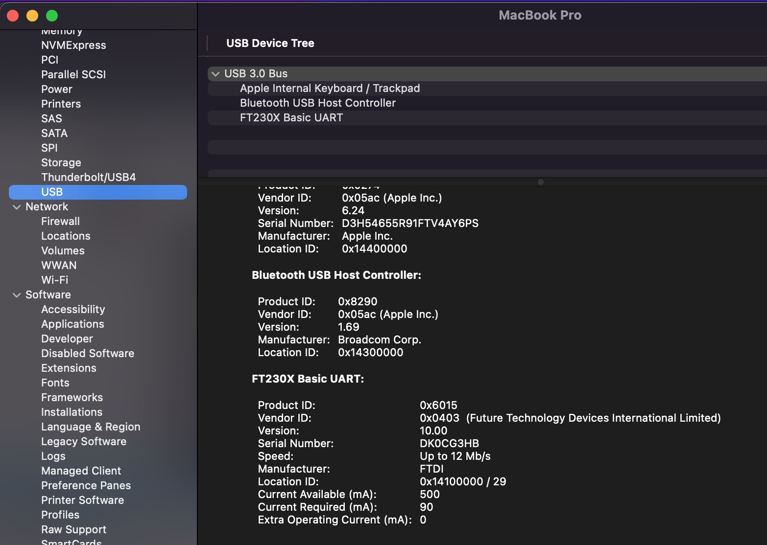

Sefibrah
(Ibrahim Sefer)
March 21, 2025, 3:22am
9

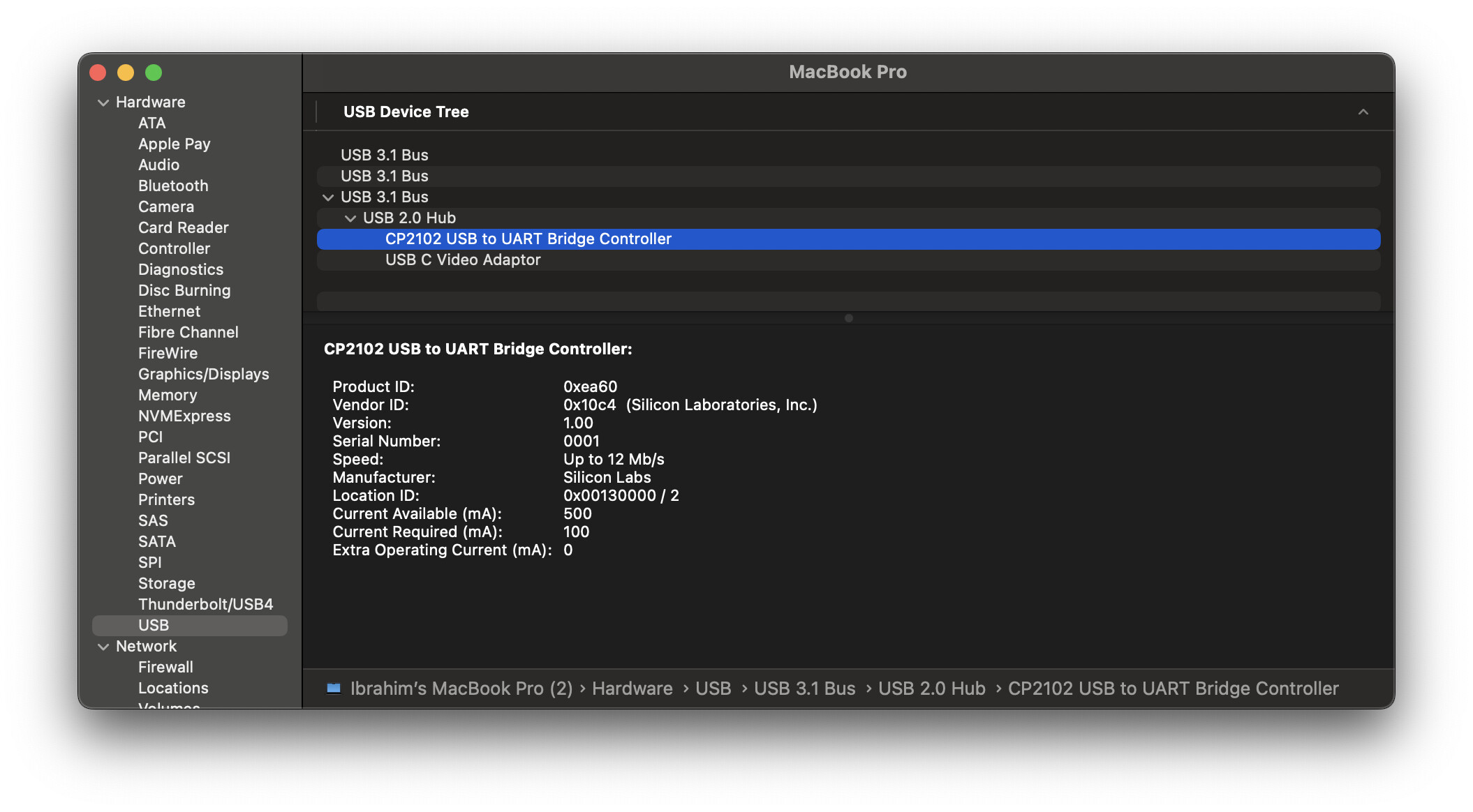

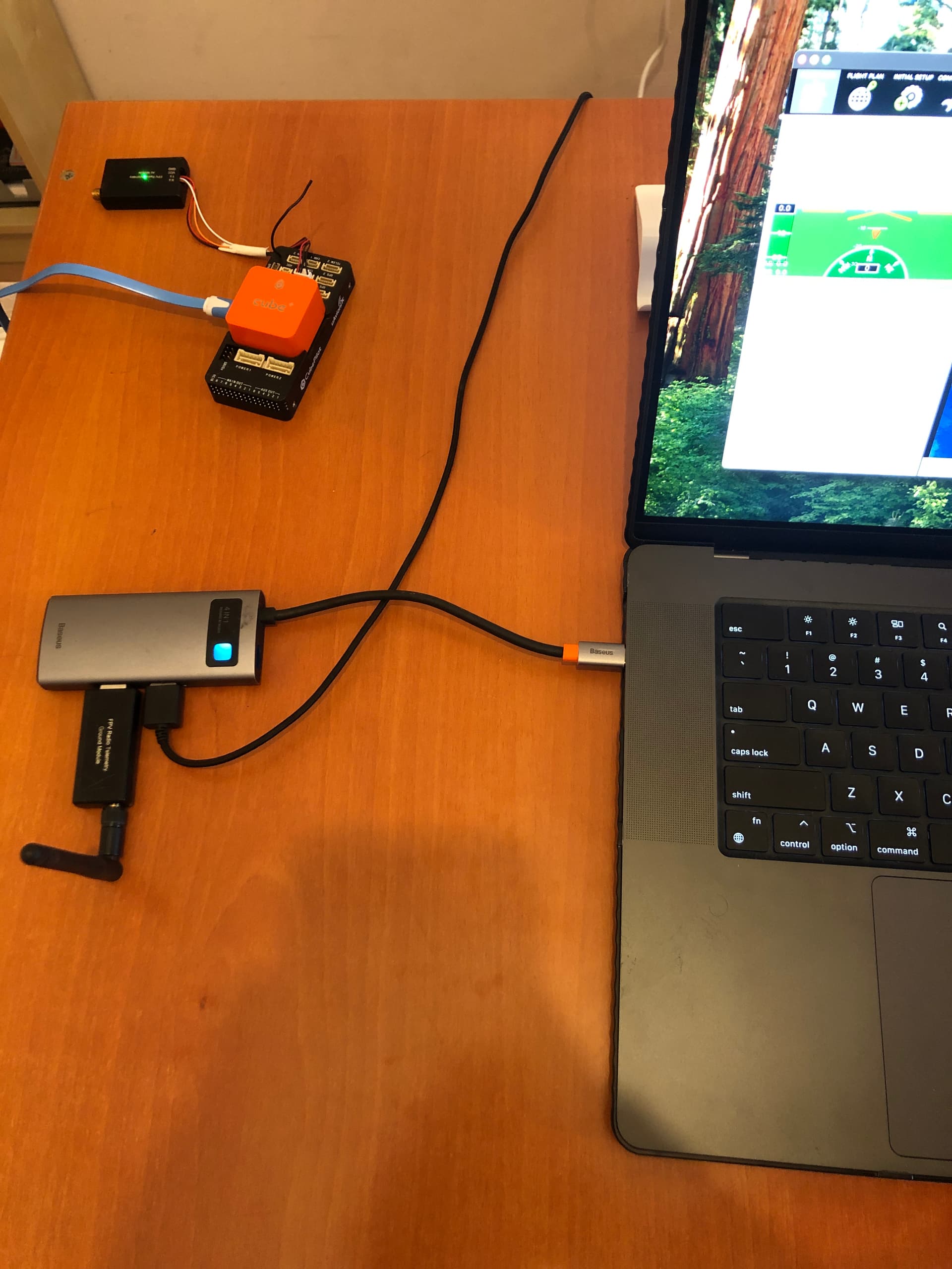

@Allister This is what I see in my System Information:
Anything out of the ordinary here?
Also, your 2nd screenshot is the same as mine…
Did you ever have to setup Comm Links? If so, then could you perhaps share that as well?
Right now, I am also trying to find anything related to that Permission thing…
But thank you so far nonetheless!
Sefibrah
(Ibrahim Sefer)
March 21, 2025, 3:32am
10
Additional information is that QGC is giving me the following error:
“Error on link X. Error Connecting: Could not create port. Permission error while locking this device”
What could this possibly mean?
Also, my QGC is 4.4.0, because at the time of writing this, 4.4.4 is having some strange bugs and crashes…
Sefibrah
(Ibrahim Sefer)
July 1, 2025, 8:22am
11
I was able to solve my issue by just plugging the Air Module from TELEM 1 into TELEM 2… Sounds silly indeed
