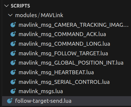

To set up for Drone 2 following Drone 1, I created ardupilot/ArduCopter/scripts/modules/MAVLink and pulled Lua from the ArduPilot repo
On Drone 1, I run param set SCR_ENABLE 1, then a reboot, and after rebooting, I see it successfully load follow-target-send.lua. I can also watch FOLLOW_TARGET and see data moving. I then run param set FOLT_ENABLE 1, set mode to guided, takeoff, and move to some other position. On Drone 2, I run param set FOLL_ENABLE 1 and param set FOLL_SYSID 1.
