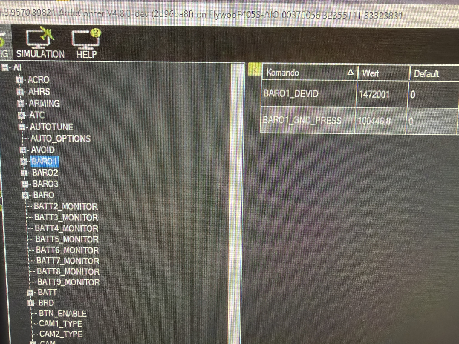

FlywooF405HD-AIOv2 - Onboard barometer not detected (BARO1_DEVID = 0) on two different boards
I am trying to use ArduPilot on a Flywoo GOKU F405 HD 1-2S ELRS AIO V2 flight controller.
I have tested two different flight controllers of the same model, and both show exactly the same behaviour.
Firmware tested
  • ArduCopter 4.6.3 (official release)
  • ArduCopter 4.8.0-dev
  • Board target: FlywooF405HD-AIOv2
  • Full Chip Erase (Mass Erase) performed before every flash.
Problem

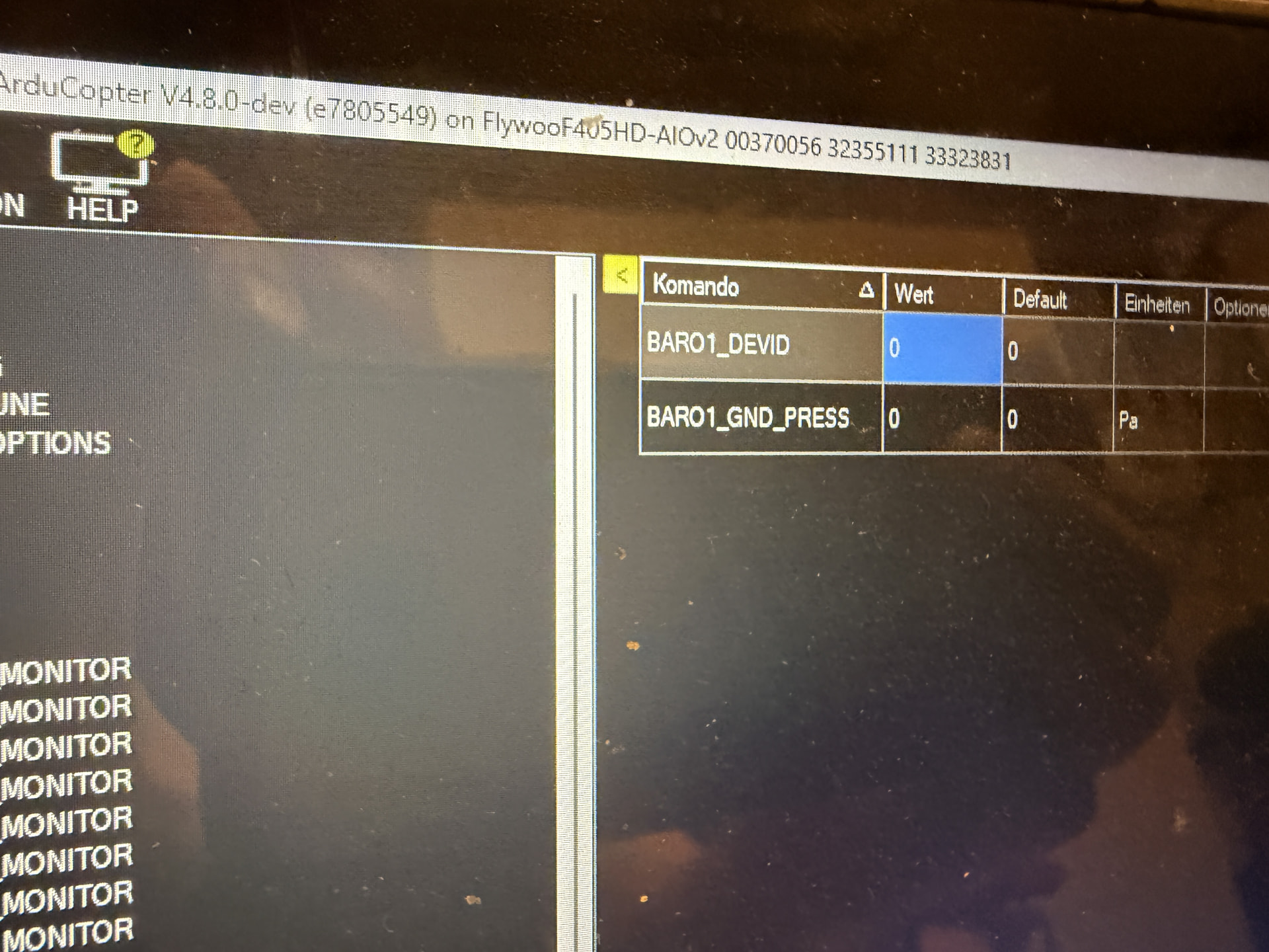

The onboard barometer is never detected.
  • BARO1_DEVID = 0
  • BARO1_GND_PRESS = 0
  • No barometric altitude is available.
  • Both flight controllers behave exactly the same.

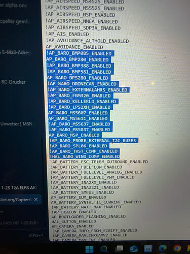

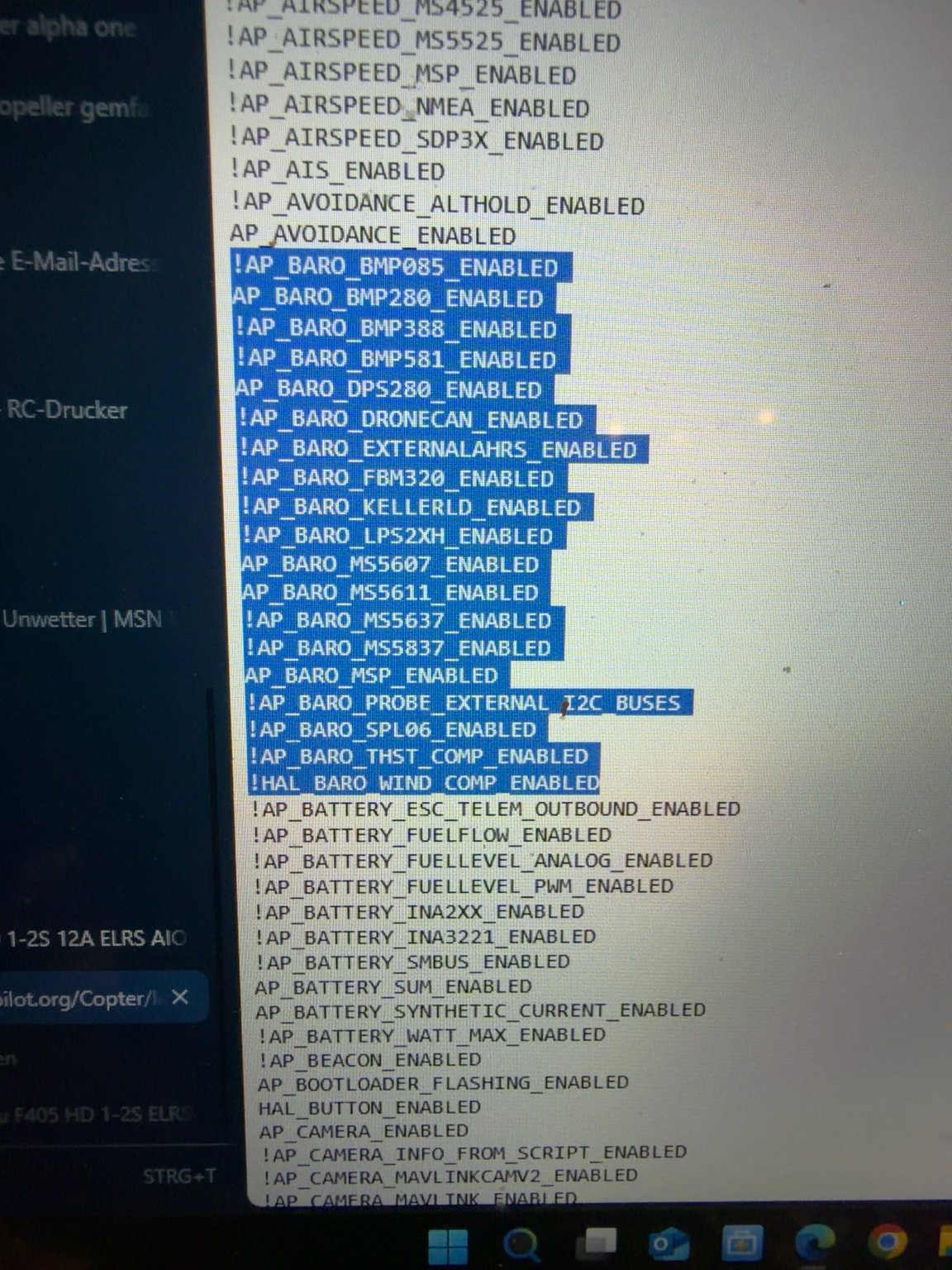

I checked the official firmware package (features.txt).
The firmware already includes:
  • AP_BARO_DPS280_ENABLED
  • AP_BARO_SPL06_ENABLED
According to Flywoo, this board may be equipped with either a DPS310 or an SPL06 barometer depending on the hardware revision.
Since the same problem occurs on two different boards with both ArduCopter 4.6.3 and 4.8.0-dev, I suspect this may not be a hardware failure.
Could this be related to the board definition (hwdef) for the FlywooF405HD-AIOv2 target, or is there anything else I should check?
I have attached screenshots showing:
  • BARO1_DEVID = 0
  • the enabled barometer drivers from features.txt

Update: Flashed original Betaflight target FLYWOOF405S_AIO. Gyro and accelerometer work normally. Betaflight detects a DPS310 barometer. Under ArduPilot the barometer fails to initialize (Baro: unable to initialise driver, BARO1_DEVID=0). This suggests a board-definition or DPS310 initialization issue rather than faulty hardware.

Hi @Cloudpeak,
From a bit of searching and googling, I suspect the issue is that the DSP310 can use I2C address 0x76 or 0x77. AP’s Flywoo hwdef says it should be 0x76 but perhaps the board you’ve got is 0x77. There is apparently a pulldown on the sensor that allows choosing which address is used but no idea of course as to whether that’s exposed on the board (probably not) or whether it’s hard-coded.
If you’re comfortable compiling the code yourself, it would be good to test changing this line to 0x77 and see if that helps.
If that works then the next question will be whether all the Flywoo boards use 0x77 or is it a hardware mistake in the board you have.

I am also a user of a similar Flywoo board, and while not exactly brand new, it does fly with Ardupilot. But I had to enable SPL06 for barometers (by the looks of my hwdef changes).
Could you try this binary please? It has few other changes apart from enabling SPL06, but these are strictly about adding features, so it should be working well.
UPD: And my apologies, it’s not the FlywooF405HD-AIOv2 binary, but its predecessor FlywooF405S-AIO. By the looks of it, two relay pins would not work with this, but if the barometer would work with the one above, I will compile the “HD” binary too.
@rmackay9 I do have these lines:
BARO SPL06  I2C:0:0x76
define AP_BARO_SPL06_ENABLED 1
in my hwdef, and I was sure that I made that following some discussions that resulted in some accepted changes, but as I see now these actually did not make it into master. (As you see from the post, SPL06 is indeed a possibility as advertised by Flywoo).

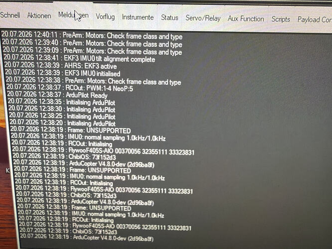

Hello Maxim,
good news: the barometer is now working. BARO1_DEVID is non-zero and pressure data is available.
The IMU also provides live raw gyro data: gx, gy, gz and gyrosq all change when I move the board.
However, roll, pitch, nav_roll, nav_pitch and the artificial horizon remain at 0. The accelerometer calibration starts but fails maybe I wiggled it too much.
So the sensor is being read, but AHRS/EKF does not produce attitude data. Could you please check the IMU type, orientation and SPI configuration in the hwdef?
Thank you again for all your effort. I really appreciate your support and I’m happy to test any further builds if it helps.

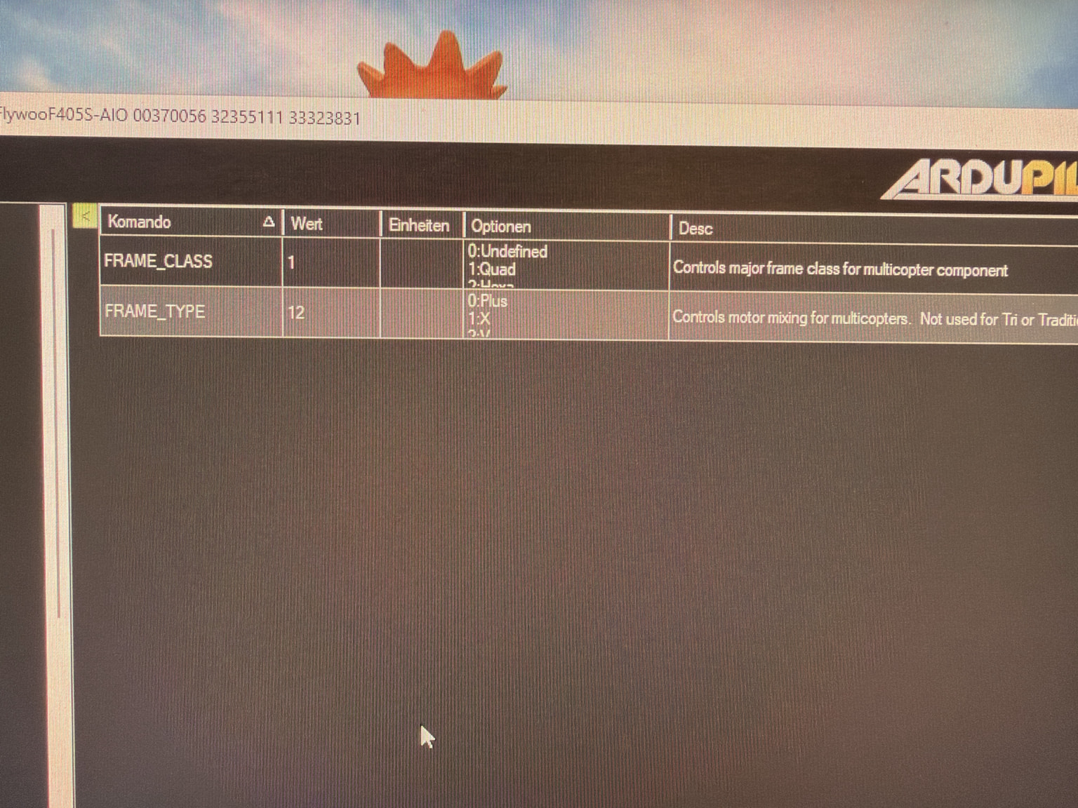

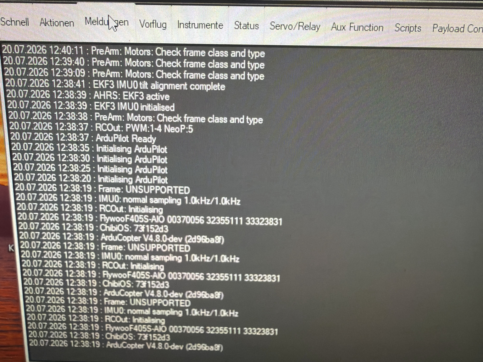

Could you please, just in case, set up the frame (FRAME_CLASS = 1 for quad, whereas FRAME_TYPE = 12 should be already set up), then reboot - so that all pending initialisation is completed?
I tested it.
FRAME_CLASS = 1 and FRAME_TYPE = 12 are set correctly. After reboot, Mission Planner reports Frame: QUAD/BF_X.
The behavior is still unchanged.
The barometer is working correctly.
Both the gyro and accelerometer still provide live raw data. gx, gy, gz change when I move the board, and ax, ay, az also change significantly when I rotate it.
However, roll, pitch, nav_roll, nav_pitch, and the artificial horizon all remain at zero. The EKF initializes successfully (EKF3 IMU0 tilt alignment complete), but no attitude is produced.
Many thanks for looking into this.
I have also tried the accelerometer calibration twice, but it failed both times.
I am a bit confused with RCOut: Initialising still. Not sure if it is just DShot misconfigured, or a sign of something, perhaps that you are running a slightly different firmware.

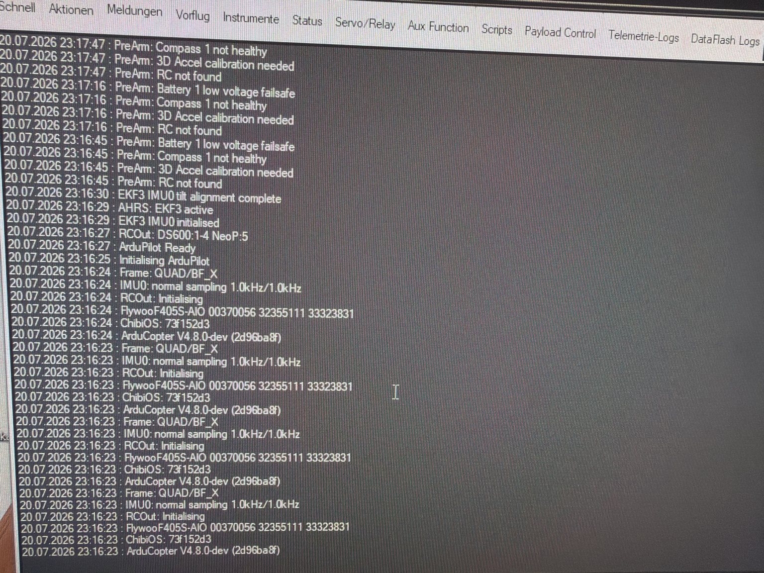

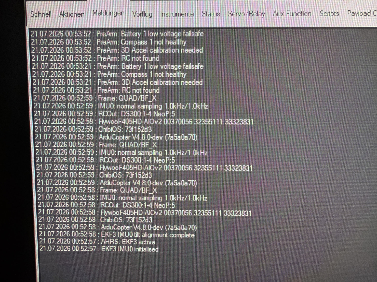

Thanks, Maxim.
I reflashed the latest HD firmware and repeated the tests.
RCOut now reports DS300:1-4 NeoP:5, and the frame is correctly detected as QUAD/BF_X, so those issues seem to be fixed.
Unfortunately, the artificial horizon still does not move. roll, pitch, nav_roll, and nav_pitch all remain at zero, although the raw gyro and accelerometer values update correctly. I also set AHRS_ORIENTATION = 6 and tried the accelerometer calibration again, but it still failed.
Thanks again for your help. I’m happy to test any further builds or suggestions.
