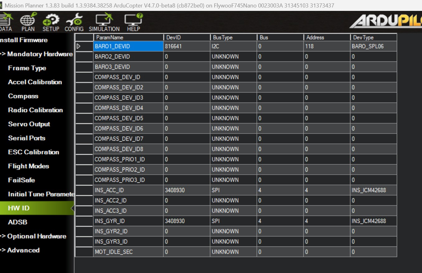

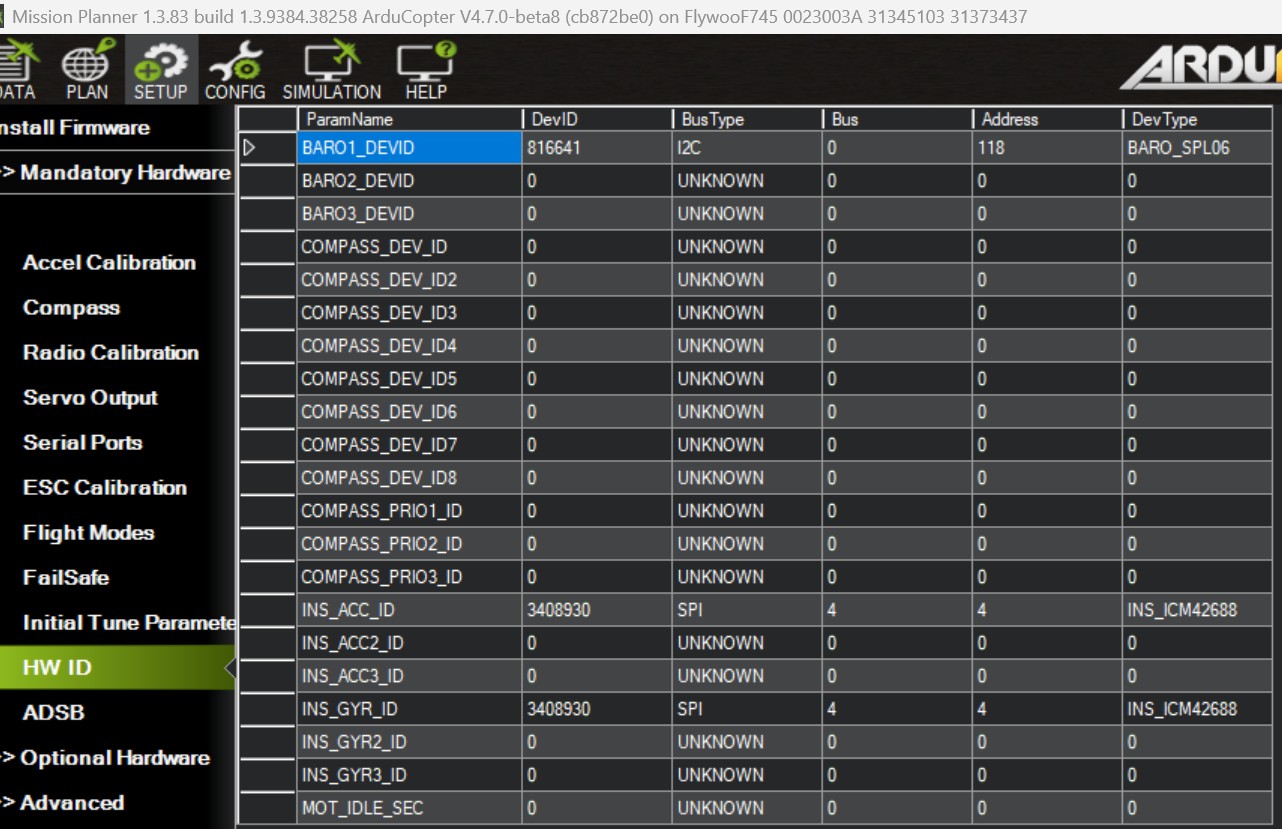

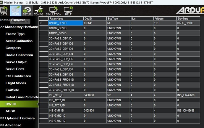

Of the 2 Flywoo Goku GN 745 AIO V3, one of which is BLHeli32 based gets GPS recognized not the compass, whereby the compass does not get the HW ID and therefore does not show in Compass window in AP for calibration. This same GPS/compass gets recognized on the AM32 based Flywoo GN745 AIO. Same issue was reported earlier here . Here a new hwdef was created by @andyp1per to fix this issue. I am on AP 4.6.3.
Please try on 4.7.0 to see if its fixed
Tried both Flywoo 745 and FlywooF745Nano Targets for 4.7.0. No success.

My feeling is that it is the I2C (SDA/SCL) bus on the FC is defective. Thoughts?
It can be that. To test that out, you may try to connect a different I2C device (a compass by a different manufacturer, or an airspeed device, or something else you have available) and see if it is recognised by a “good” board and a “bad” one. It may indeed be that you are unlucky with the I2C bus on that board, in which case you may try to contact your reseller or Flywoo themselves.
I did exactly that as well, and I forgot to mention it. I did test with this working Mateksys GPS with the same results.

I looked at the hwdef - its all correct on 4.7. Probing is enabled and there are pullups on i2c
