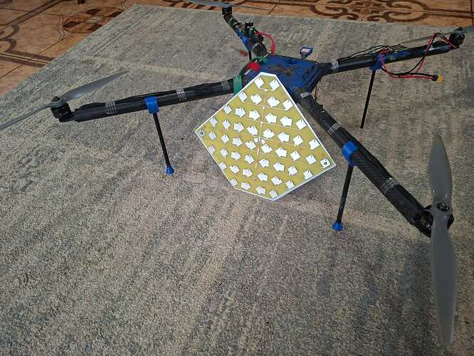

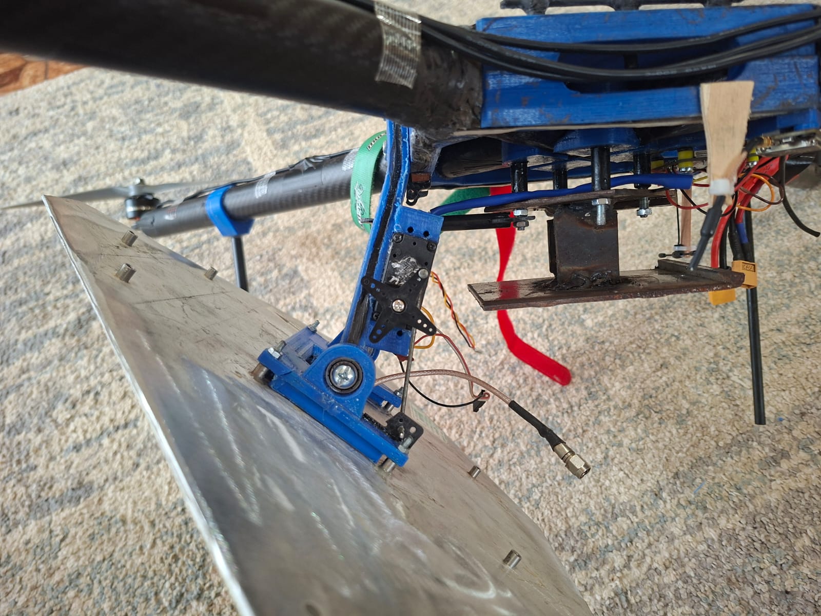

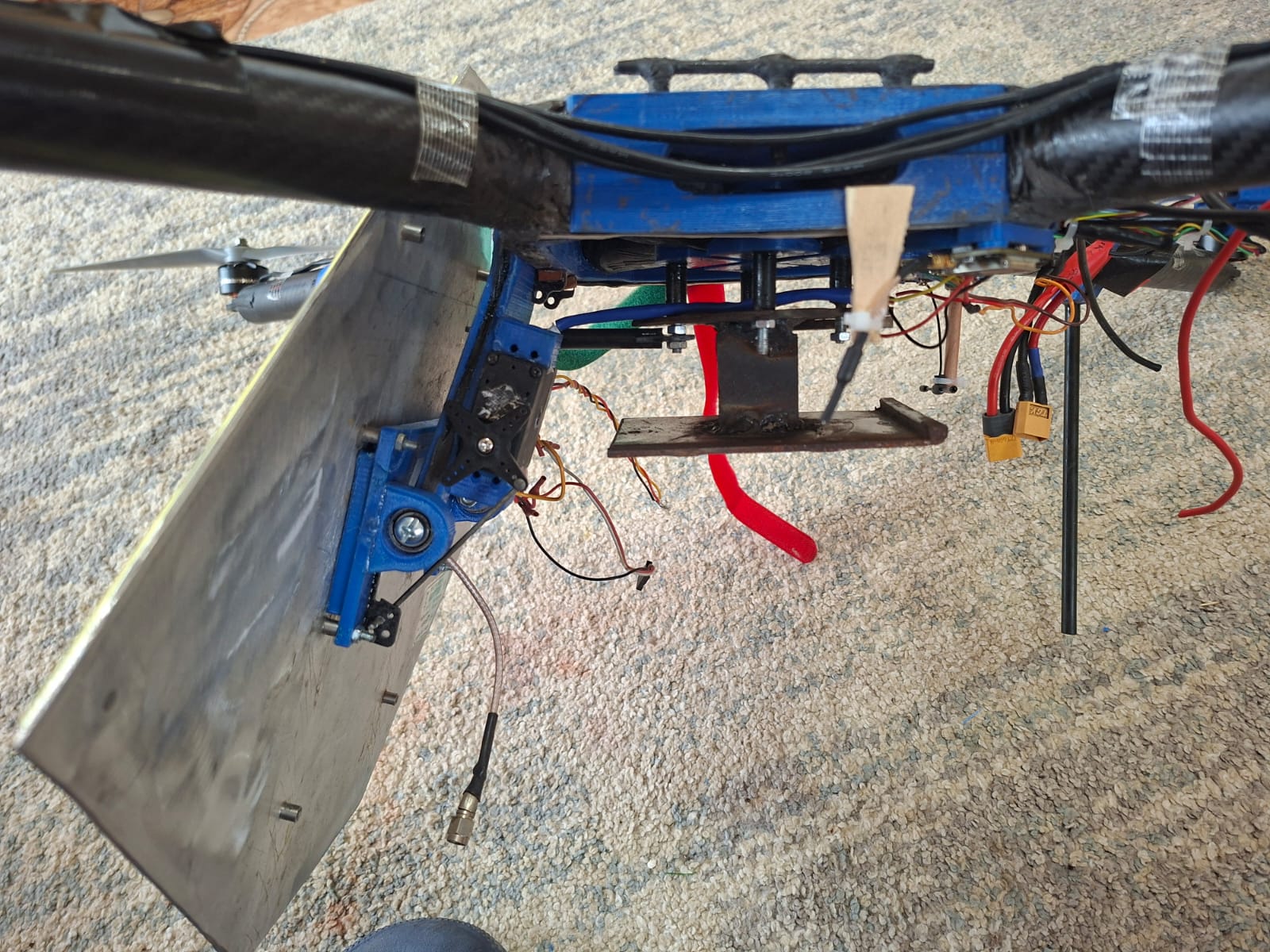

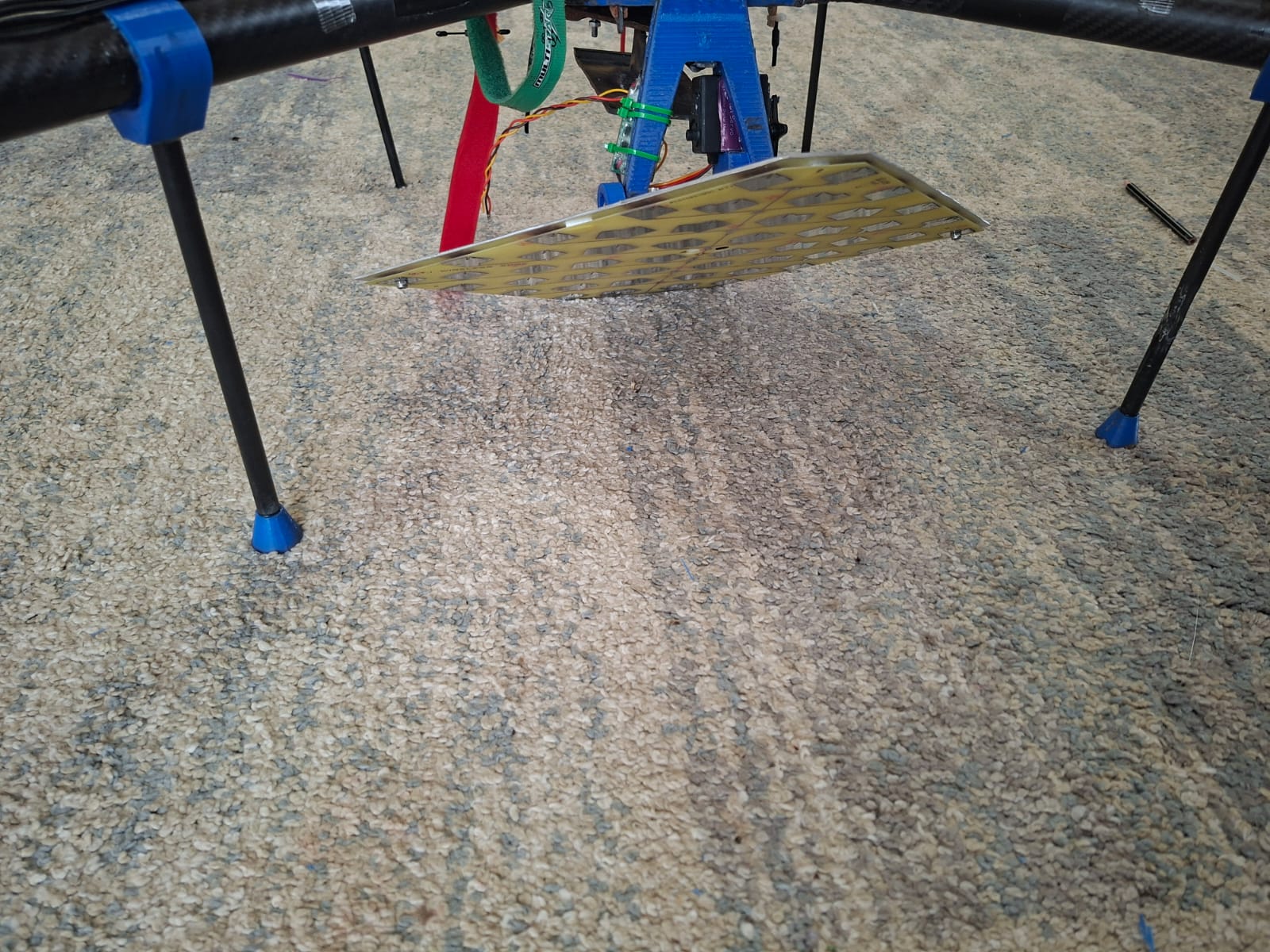

The hardware part was relatively easy to design and fabricate: The key piece is the main antenna, 21 dbi patch antenna of about 28 x 28 cm. and with a weight of 480 grams “as is”.

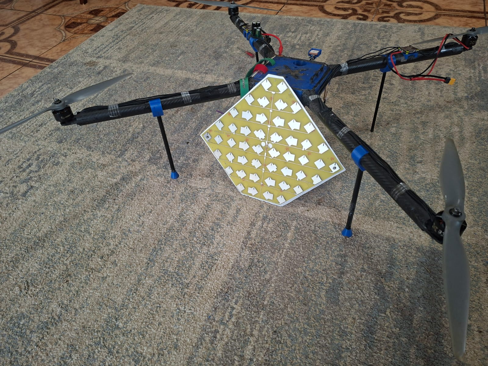

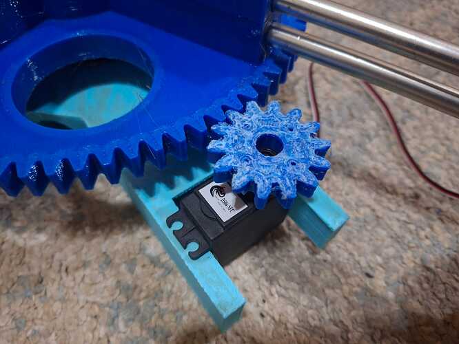

The antenna can be moved from about -15 degrees to down to 45 degrees using standard servo (there is a small mistake in the lever connecting point, I had to extend it in the final version). The weight of the whole assembly is 190 grams.:
When pointing at 45 degrees, the antenna barely clears ground, so for take offs and landings that is its home position:

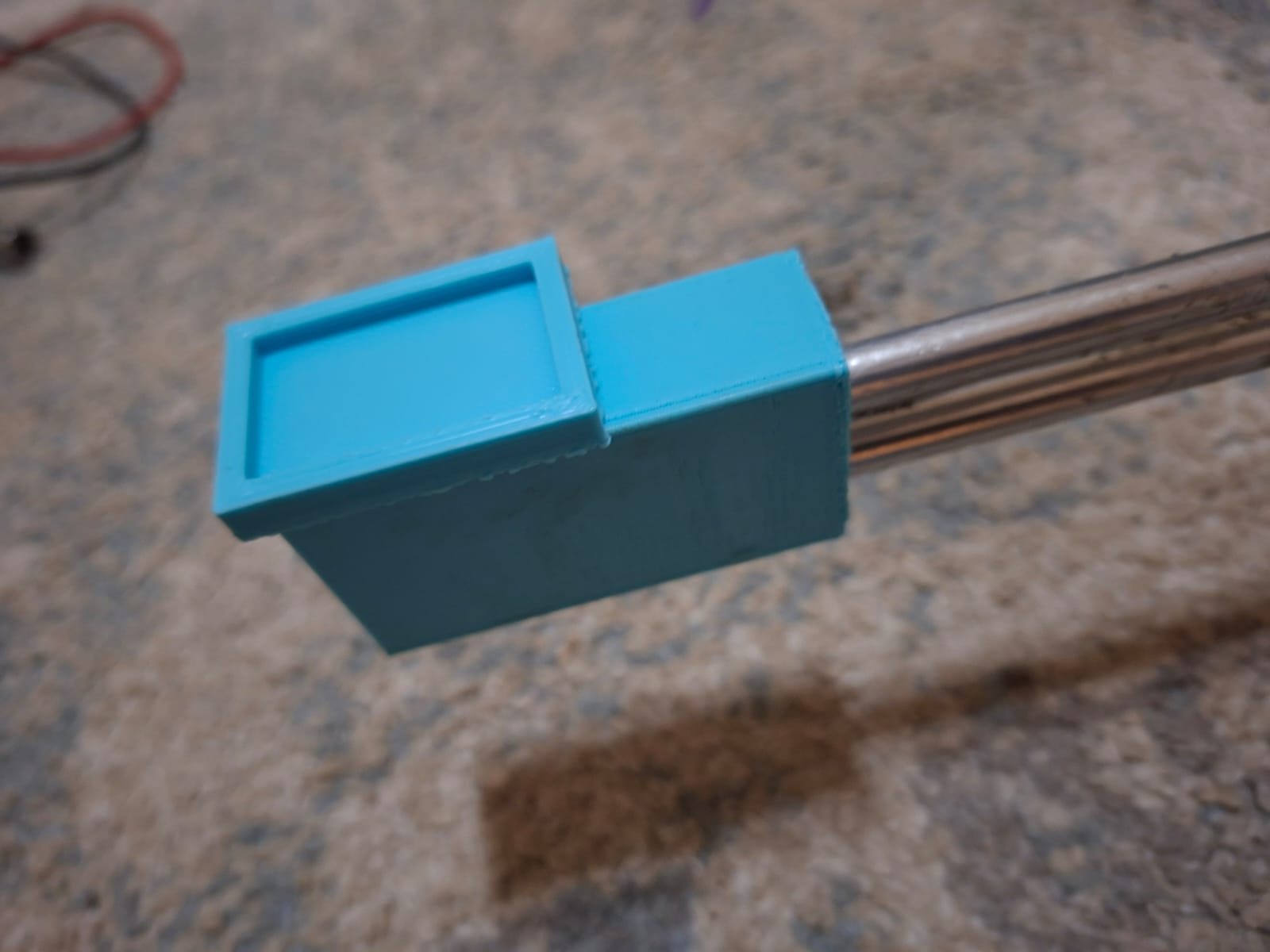

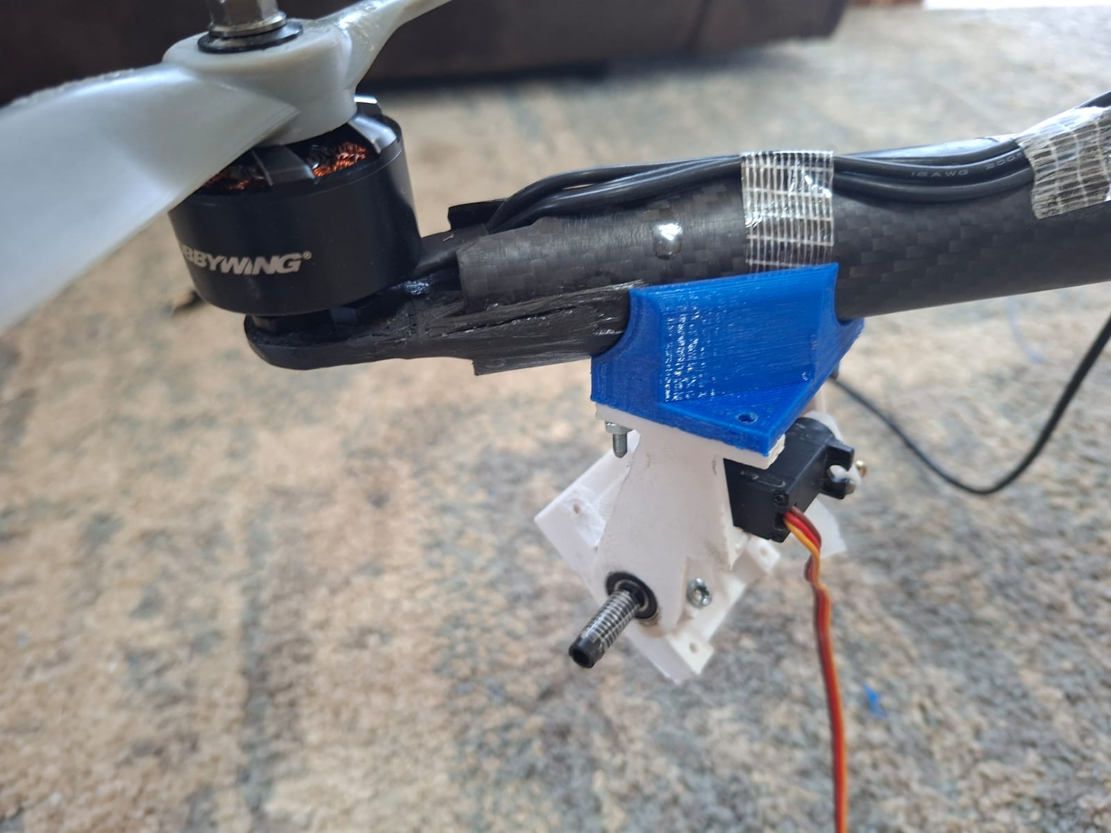

On the other end, there is the smaller antenna mechanismo for pointing in elevation, which weighs 40 grams, without the antenna:
So the total weight of the video retransmission is
Main antenna: 480
Mount and servo: 180
RC305 and cable: 60
Secondary anntena: 40
Mount and servo: 40
VTX: 20
TOTAL 820 grams

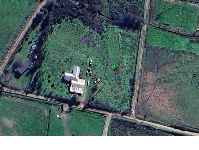

Discovered issue with altitude control. Not sure what is happenning, but after issuing vehicle:set_target_location(Copter_target) command, the copter correctly flew to the GPS position, including altitude. After that it stayed there for about one minute, but began slowly descending. Is it normal behaviour for Guided mode, after the vehicle reached the destination? During this time, there were yaw commands issued for yaw control tracking, but the target was not updated, i.e, no vehicle:set target commands were issued. There was no LAT LNG drift at all
Looking deeper into it, during the second section of flight, the target altitude was constantly updated, at a rate of 10 HZ:
Copter_target:alt(MAX_HOVER_ALT * 100)
MAX_HOVER_ALT was fixed the whole time at 50 m, and home was set Field Elevation Set: 141m, so it should be 191 m absolute GPS. But the graph below shows considerable variation of altitude, and the descent and bobbing up and down were noticeable from the ground (it was not a GPS drift). For this flight, I did not have Baro logging enabled, but I believe the baro altitude was also changing in a different flight, although I am not 100 % sure.
The graph below is from yet another flight, but it shows the correlation between GPS and BARO, which seem to indicate that both work correctly.
Any ideas as to why?

After fighting for two days with unexplained altitude changes which I initially attributed to my programming, it turned out that the barometer is failing, the ahrs:position is not very good at catching this, and I had to revert to gps:location as the main source for altitude.
It worked finally very well.
The test speeds were very low, 1..4 m/s to be able to follow it.
I was able to fly a complete mission just by switching one rotary switch with 6 positions:
I enabled a fake plane which was going round the base, and the copter followed it exactly as expected, tracking it by going where the copter is supposed to be (on the line betwen GS and Plane), yawing towards the Plane, and also following the inclination of the plane.
And it landed within 1 meter from where it took off.

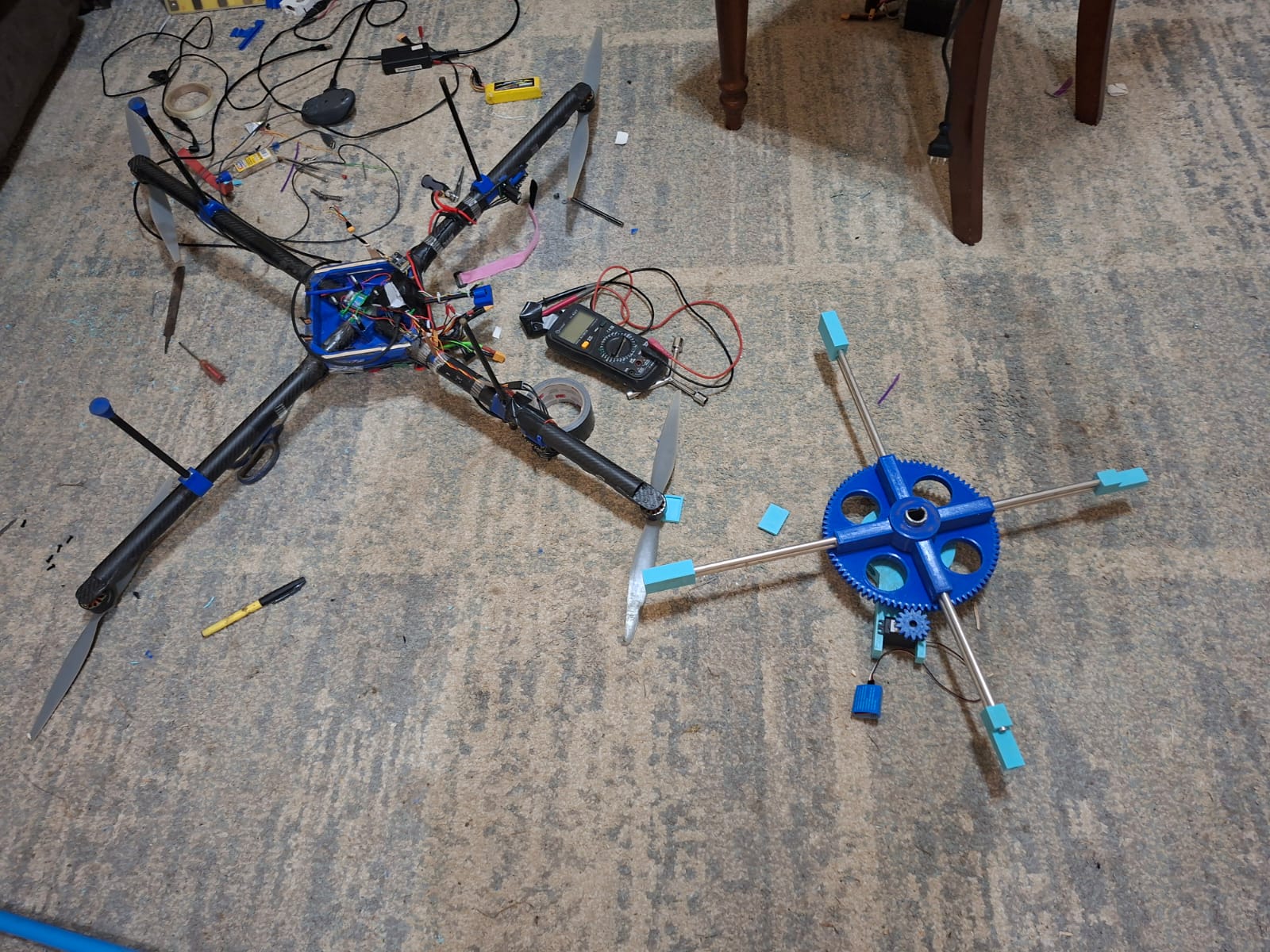

  2. The other idea is to make a turntable on to which the copter will be placed. So when you start the mission, you first let your normal copter/plane fly off and you start tracking it by using the retranmission copter which is on this turntable and which follows the target plane/copter by using a servo in the turntable, inclination of the antenna by the copter itself (with a limited up angle of about 15 degrees as designed now). When the plane begins to come close to the point where it could go beyond the LOS, the retransmission copter would be given the command to fly off. This would reduce the air time considerably, especially if the ridge is far off and plane needs time to get there. The climb of the retranmission copter can be very fast actually, it can reach 1000 meters in about 1.5 minutes.
The lua script in the copter would control the servo (continuous rotation). The copter could be connected to it through a simple connector which would disconnect on take off, and on basis of the compass it would determine when to cut the servo rotation.

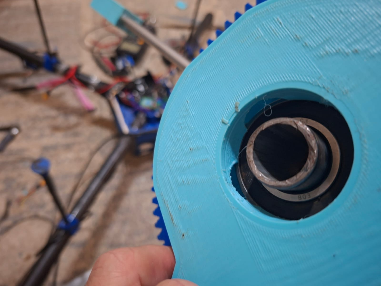

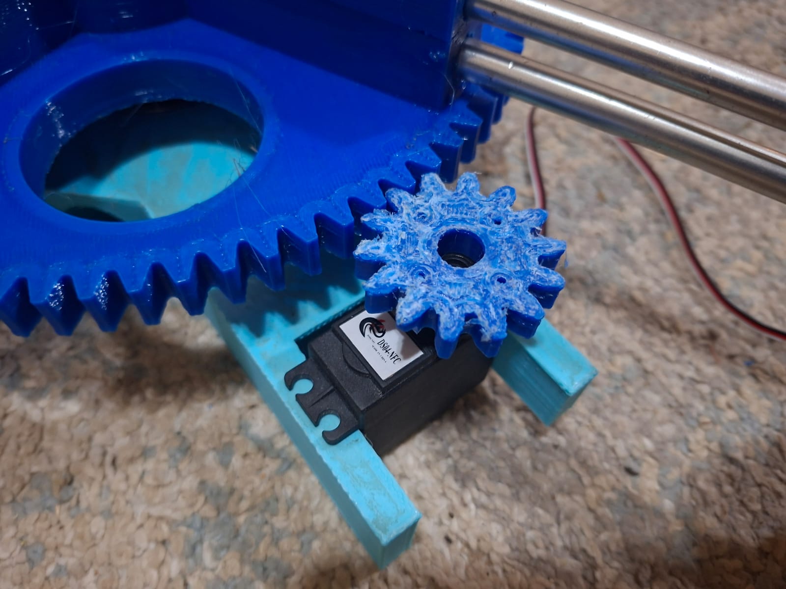

Could not resist building the rotating turntable… it was a very easy project, took me less than a couple of hours designing and an overnight printing, but it is almost done…
Turntable uses a ball bearing which is pressed into the base, and the rotating part is pressed on to the axis (it is 52 o.d. 25 i.d.). A continuous rotation 50 gram servo rotates the whole thing easily. The legs of the copter would be placed in these shallow leg restrainers so that the copter would not fall off. The servo cable would go through the axis (axis is a hollow 25 mm. pipe) and would connect to the copter through simple pins. Since the antenna has a relatively limited upward movement (15 degrees), the uneven leg supports would provide an extra 7 degrees of inclination. I believe that should not affect arming of the copter.
