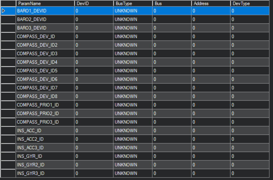

I went ahead and got some basic spi check running to see if I can read the chip_id. The baro that im using is the BMP581, so the value for the 0x01 register is 0x50 which is what im reading here. However, in the hwid section I dont see it reading anything about my baro or my imu (icm20948)
im assuming it something in my hwdef file, so can yall tell what it is?

Oh just an update, I figured out what it was. It was the hwdef file. If you think you’ve checked it, check it again I swear. Compare with hwdef.h as well.
What ultimately was the discrepancy?
It was really stupid :frowning: . The spi pins were defined to the right pins in the IMU and BARO definitions and used the right spidevs, but the spi dev spi busses were flipped. I kept on overlooking it…
