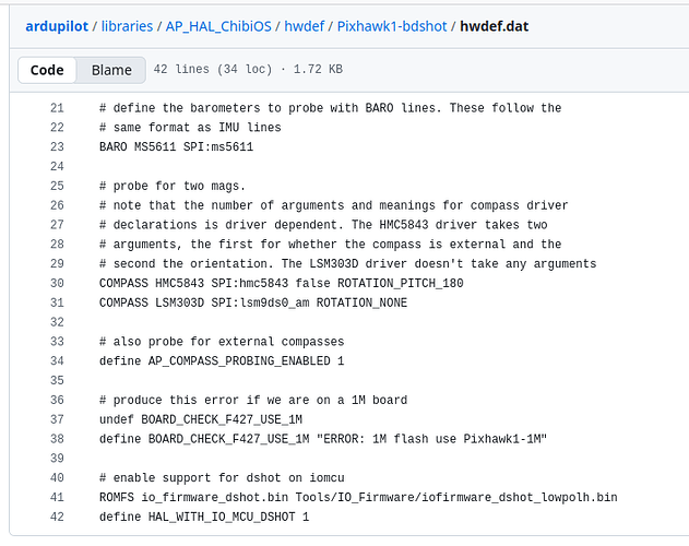

So my Pixhawk 2.4.8 has a F103 IOMCU instead of F100. I was wondering if replacing the second last line from iofirmware_dshot_lowpolh.bin with iofirmware_f103_8MHz_dshot_lowpolh.bin will solve the issue ( ardupilot/Tools/IO_Firmware at master · ArduPilot/ardupilot · GitHub ).
Thanks
It might if the oscillator is 8Mhz or you might have to use the other f103 version
The hardware oscillator was 24 Mhz, same as the FMU, if I remember correctly. I guess I should use the other non 8Mhz version
I just found out there is an iomcu-f103 in the custom firmware builder. If I use this, will it be compatible with the 2.4.8?
Also, can you tell me if there is any difference between fmuv3 and Pixhawk1?
Pixhawk1 includes fmuv3 plus what you see after it in the Hwdef.dat file
Pixhawk1

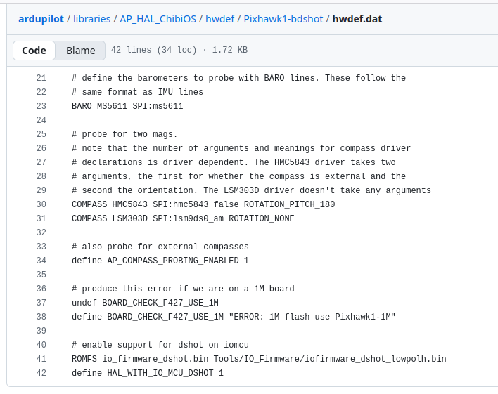

@andyp1per I wrote the hwdef for the 2.4.8 using iofirmware_f103_dshot_lowpolh.bin and now I seem to be hot water after I tried flashing the dshot fw onto it. Now, firwmware erases doesn’t seem to rewrite the fw on the iomcu to the standard version. What can I do? I don’t have the safety switch with me now so can you tell me which two pins I have to short while restarting the FC to try booting it into bootloader mode?

The Pixhawk 1 has a boot switch for FMU and for IO. (see pictures in the wiki)
Schematics:
Thanks and never mind, I shorted pins 1 and 3 of the switch port on startup and now its back

Yes, anyway now it’s back. Just needed to hold down the safety switch
