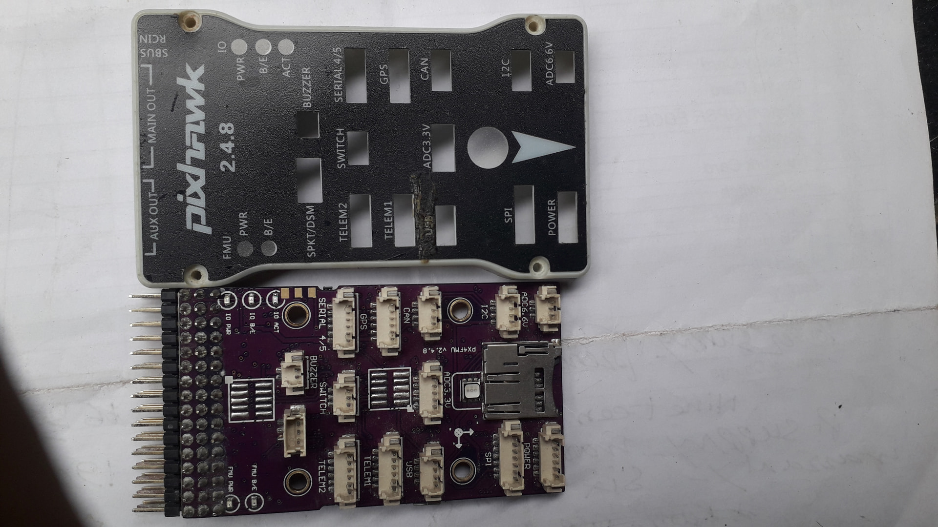

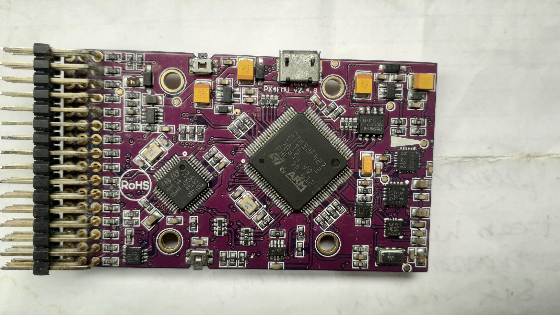

What Pixhawk1 flight Controller? Post a photo of it. Something from Radiolink maybe?
No sir, it is not Radiolink.
I carefully checked the Pixhawk’s processor and found it to be the STM32F427 VIT6 Revision 3. I flashed it with the AC_4.6.3 firmware. After performing AutoTune in Loiter mode, I switched to a different battery because the previous one had run out of charge. The copter was extremely stable, but it suddenly plummeted in a pond from a height of 35 meters. The battery charge level was adequate. When I lifted it out the water, the main indicator LED was not on lit. FMU B/E and IO B/E LEDs were lit.

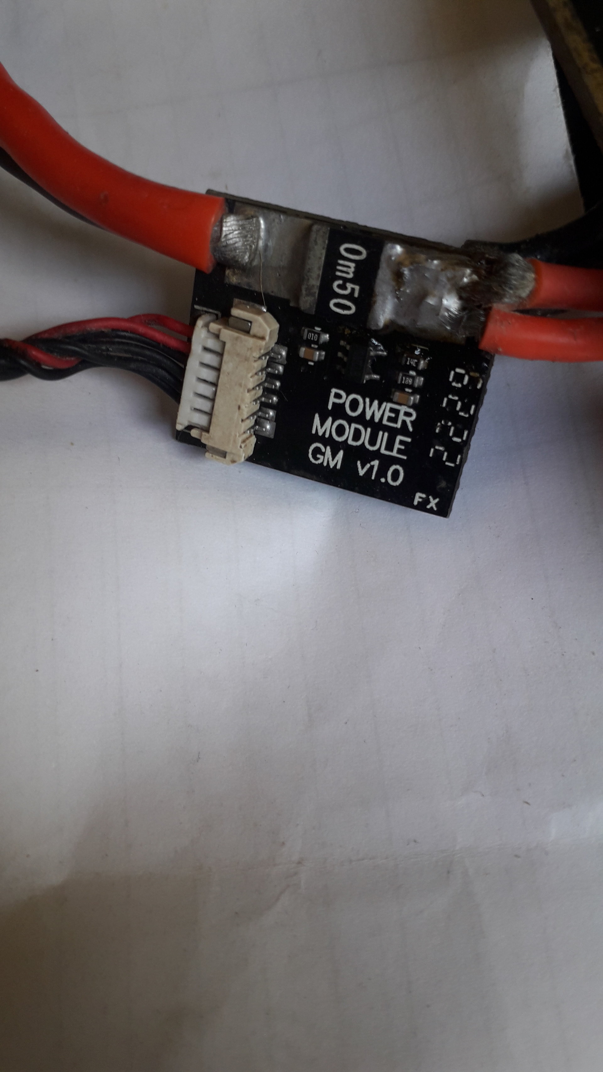

The 1st log shows logging abruptly ending at ~35m meaning a power loss or brown out to the flight controller leading to the splash down.. Vcc on the controller was at 4.4V minimum so it could be that.It was never above 4.65V. What power module do you have? And again what Flight Controller is this.

Sir, this is Pixhawk 2.4.8 fmuv 3 Flight Controller and power module. I upload this image
However, I have previously used this Pixhawk and power module with AC_3.6.12.

Measure the voltage out of that power module. It should provide 5.3v to the Flight Controller.
Sir, the issue was with the power module’s wiring; the wire clips were loose. Consequently, even though the power module’s VCC was supplying 5 volts, the Pixhawk’s VCC pin registered only 4.8 volts. Furthermore, when the drone is airborne—carrying the M10 GPS, Receiver, and 500mW Telemetry—the voltage will drop drastically, causing the Pixhawk to shut down.

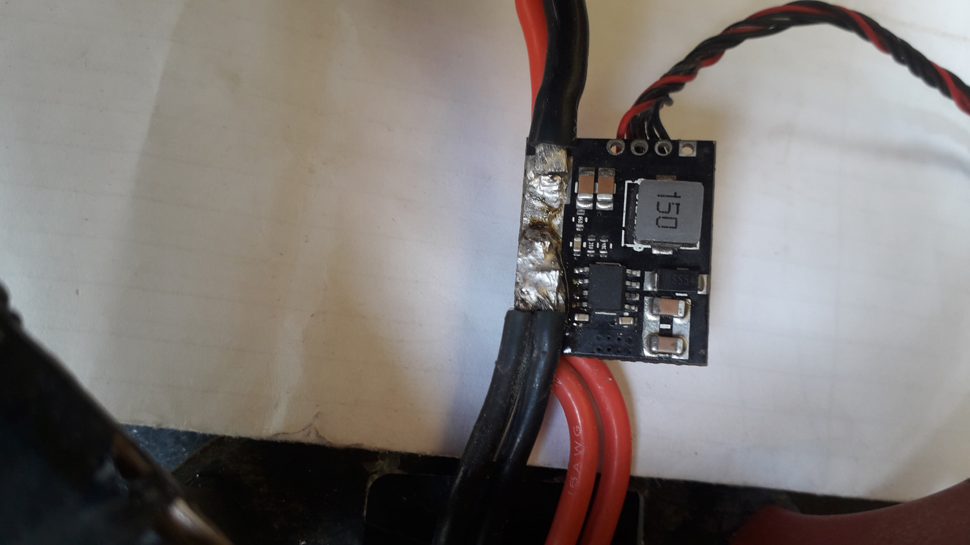

What ESC’s are they and how have you connected the BEC output from them (one) to the Pixhawk?

That FC could if he’s connected a BEC to the power rail.
