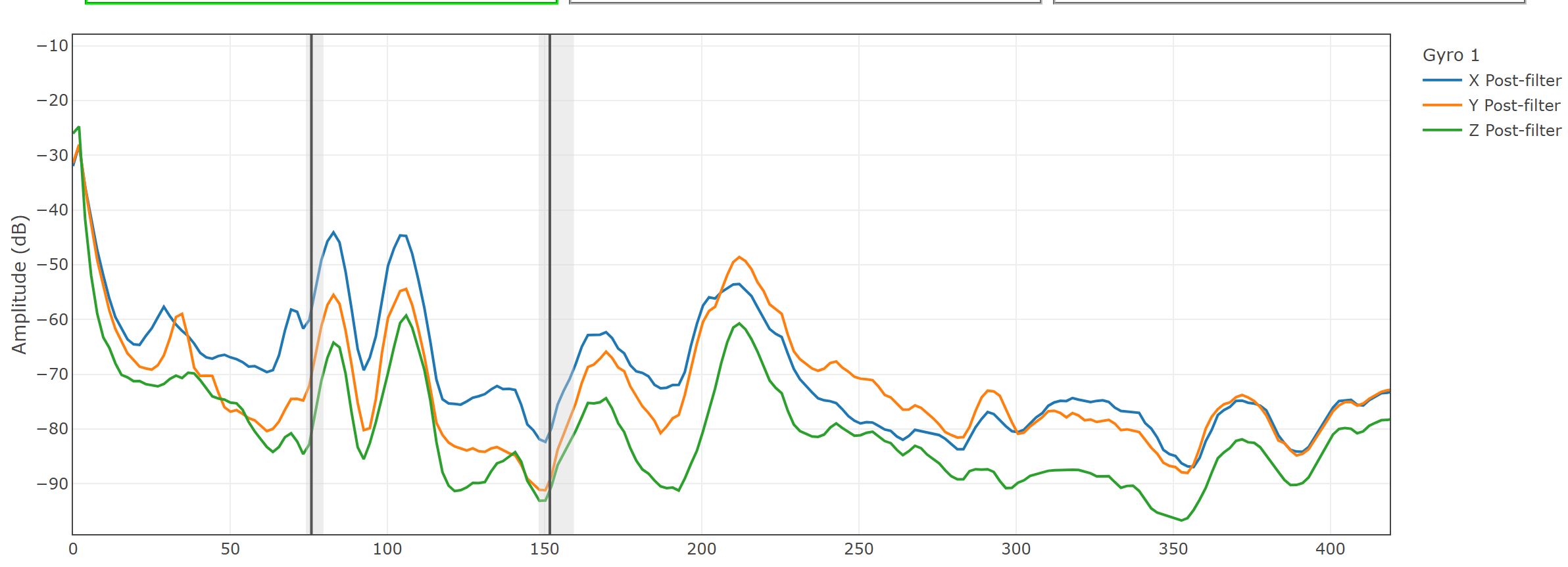

You are now collecting data properly for that Flight Controller. Your problem now is the rather large Yaw Bias previously mentioned that you should have been addressing. Because it’s likely the reason you have 2 closely coupled modes of vibration clearly seen on the FFT graph in Web Tools:

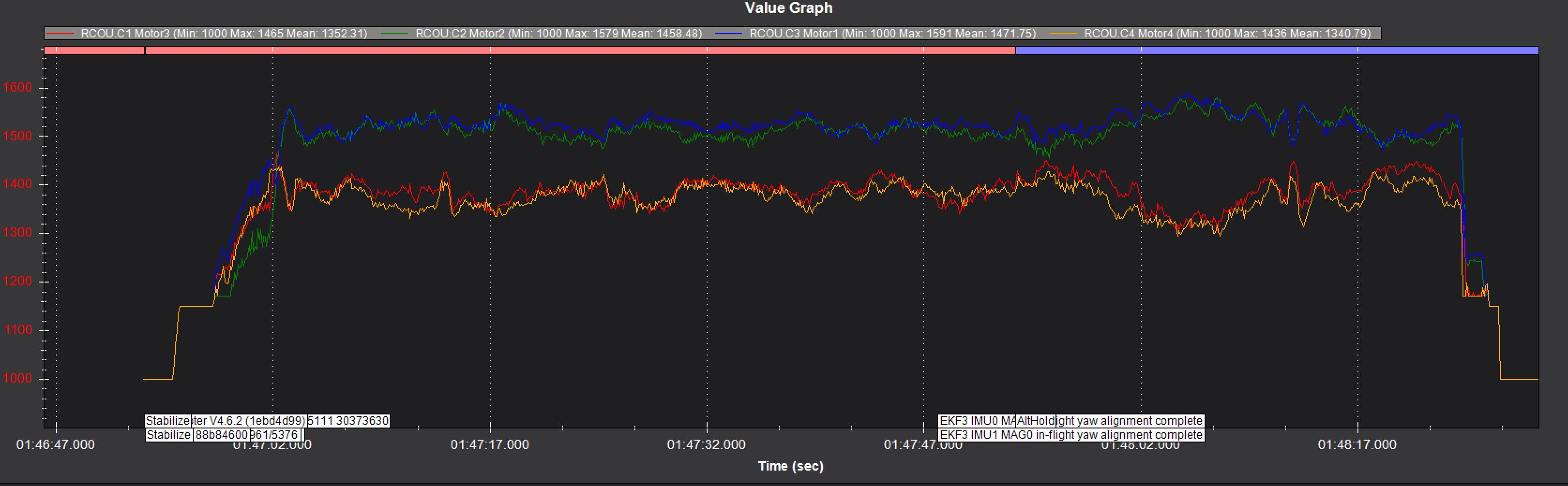

Here is the Yaw bias that requires fixing:
And here is the FFT graph:
And while the outputs are not showing much oscillation I would set the vertical accleration controller gains based on hover thrust now as they are at default. Also, check the Motor Ranges for the proper MOT_SPIN_MIN setting.

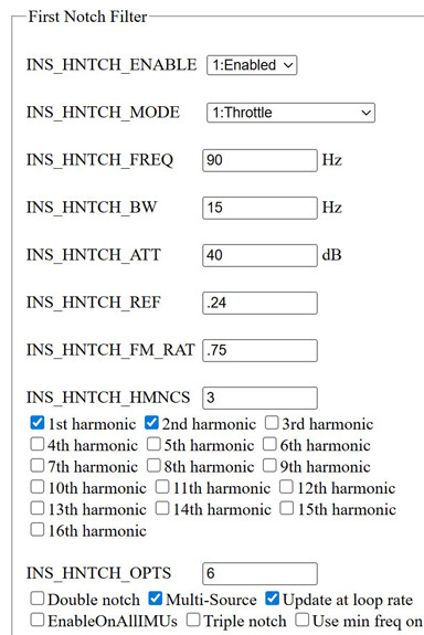

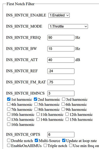

Yes, fixed. Now you can set a proper notch filter. This looks good:
You could do another hover flight to check it or call it good, disable Raw logging and perform an Auto Tune. You only want Raw logging active to collect data for the notch filter.

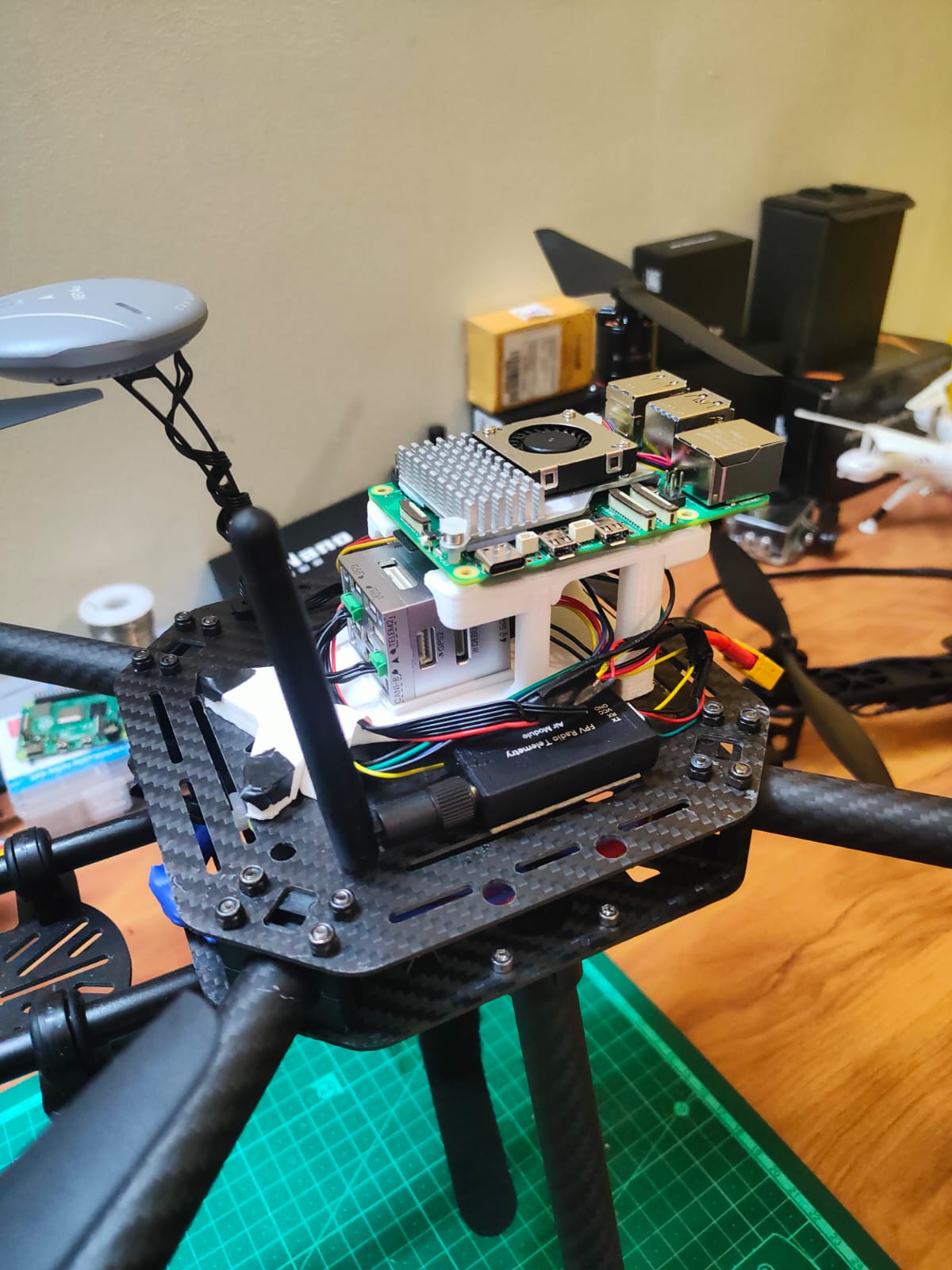

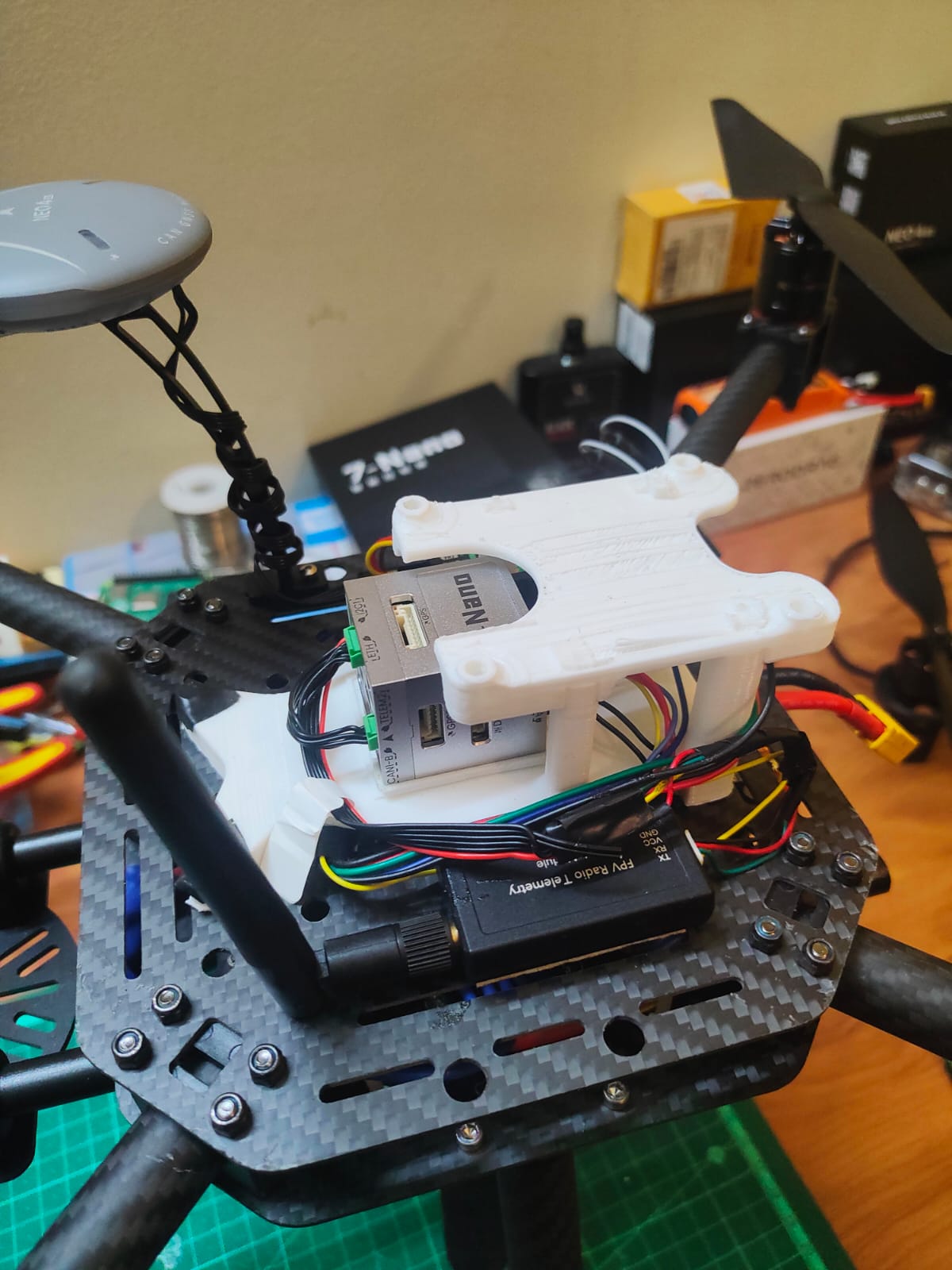

Out of curiosity how are you mounting the 7-Nano? No issue with vibes they look good just interested to know.
I mounted the 7-Nano using double side tape on a custom 3D printed mount which is screwed to the top plate . Attaching the images
OK, thanks. Some have vibe issues with those frames was one reason I was asking. I have one of those Flight Controllers but haven’t used it for anything yet.
